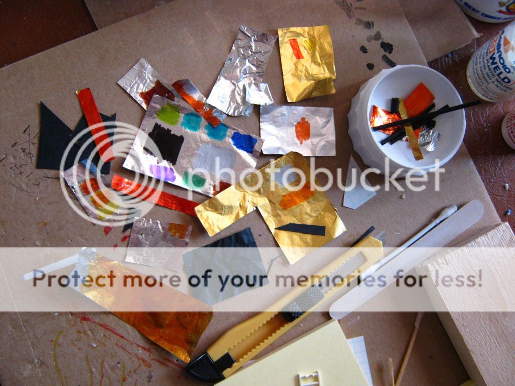

Paul Mullins Posted December 24, 2014 Share Posted December 24, 2014 Try candylandcrafts.com for the foil coverings. I've got some and the dark gold appears to be a spot on match. Quote Link to post Share on other sites
habu2 Posted December 24, 2014 Share Posted December 24, 2014 I found several shades of foil at a local craft shop, intended to be used for candy wrapping. I've also had luck with using different colors of Sharpie markers on regular aluminum foil. Quote Link to post Share on other sites
Apollokid Posted December 25, 2014 Share Posted December 25, 2014 I found several shades of foil at a local craft shop, intended to be used for candy wrapping. I've also had luck with using different colors of Sharpie markers on regular aluminum foil. I have had similar results using Tamiya or Gunze clear yellow and orange sprayed over the foil. Using orange clear and building the coats up you can achieve various depths of color with them. Cheers, Gene. Quote Link to post Share on other sites
crackerjazz Posted December 26, 2014 Share Posted December 26, 2014 Hi habu2, did you have any problems with ink collecting more where the creases are? I'll have to look for orange Sharpie markers and give that a try - it does look like real kapton. Hi Gene -- silly question for you -- I've never tried spraying paint onto foil but did you use acrylic paint? Any issues with the paint peeling off or cracking when the foil is wrapped around parts? Quote Link to post Share on other sites
habu2 Posted December 26, 2014 Share Posted December 26, 2014 Hi habu2, did you have any problems with ink collecting more where the creases are? No problems, the Sharpie ink dries immediately. IIRC sometimes I had to apply a second 'coat' to hide the stroke marks. Note I 'inked' the (flat) foil before wrinkling and applying it to the model, then did some touch-ups afterward. The Kapton "straps" on the LM legs were drawn on with Orange Sharpie over siver foil. Quote Link to post Share on other sites
Apollokid Posted December 27, 2014 Share Posted December 27, 2014 Hi habu2, did you have any problems with ink collecting more where the creases are? I'll have to look for orange Sharpie markers and give that a try - it does look like real kapton. Hi Gene -- silly question for you -- I've never tried spraying paint onto foil but did you use acrylic paint? Any issues with the paint peeling off or cracking when the foil is wrapped around parts? I have used Tamiya and Gunze both acrylics. I wrinkle the foil first and then sometimes touch up once it's installed. HTH Cheers, Gene Quote Link to post Share on other sites

johnlove_mk_II Posted December 30, 2014 Author Share Posted December 30, 2014 Got the balloons last night and only had a few minutes to take a look at them this morning. The two orange flavors seem almost Identical as far as color … but a really good match for the 2 mil Kapton. The gold balloons are spot on for the 1/2 mil … and as it turns out, the red is a little more orange than it looks in the pictures on the site. I think it may just work for the 5 mil Kapton. I’ll get some comparison picts tonight so you guys can see. Thats an interesting idea to paint and marker the regular foils. That’s surely something to store away in the ol’ noodle for later. Quote Link to post Share on other sites
Space Tiger Hobbes Posted January 2, 2015 Share Posted January 2, 2015 (edited) I've used Mr. Hobby Surfacer 500 to smooth WSF, WSFP, FD, and FUD 3D parts. Seems like a lot of paints in the stores that say 'primer' may provide a good substrate for a final coat, but they're just as thin as regular paint and don't fill very quickly. But it's not cheap. BTW, wasn't there a picture from some Japanese hobby show a year or 2 ago that showed a 1/32 injection plastic LM? What happened to it? Edited January 2, 2015 by Space Tiger Hobbes Quote Link to post Share on other sites
johnlove_mk_II Posted January 5, 2015 Author Share Posted January 5, 2015 (edited) So here’s what I think I’m going to go with for the descent stage blankets. On the left is actual Kapton (1/2, 2 and 5 mil) laid on some adhesive foil trim from Mono-coat, and on the right are the balloons and candy foil from my collection, taped to a piece of styrene. It’s a reasonably close match. Edited January 5, 2015 by johnlove_mk_II Quote Link to post Share on other sites

Apollokid Posted January 7, 2015 Share Posted January 7, 2015 So here’s what I think I’m going to go with for the descent stage blankets. On the left is actual Kapton (1/2, 2 and 5 mil) laid on some adhesive foil trim from Mono-coat, and on the right are the balloons and candy foil from my collection, taped to a piece of styrene. It’s a reasonably close match. John, looks a close match. I'm just starting my LM-12 now and working on the descent section.I will be using real Kapton on mine.I sprayed Mr surfacer 500 thinned on the engine bell the other day and then a light wet sanding and all traces of the lines are gone. This method seems to work the best. As soon as i have something interesting to show I will post in my own build thread. I look froward to seeing more of your build. Cheers, Gene. Quote Link to post Share on other sites
