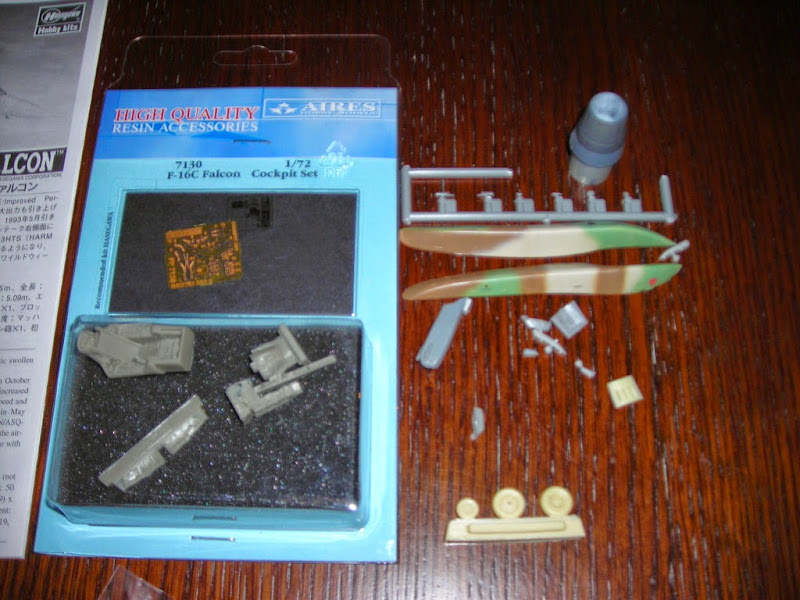

Frankly, F-16 is not my favourite aircraft. However, ever since Polish AF bought F-16's it started to grow on me.
For some time now, I've been wanting to build Polish F-16. Academy KF-16 boxing would be great for this, but the radome and intake area are wrongly shaped - I can't get over it :( CMK resin intake doesn't help with this :( So right now I'm waiting for Tamiya to release the block 52 :)
So right now, I'm going to attempt to convert this kit, into block 52+ F-16C.
Since I hate Hasegawa F-16 cockpit, I bought Aires resin pit. To update this bird I've gathered some parts from my part stash. I'm hoping spare Revell exhaust pipe will fit the Hasegawa kit. I managed to find some spare Hasegawa CFT's from F-16I.
I'm hoping on using the Model Maker Decals for the F-16C # 4055. I also have new Techmod stencils.
With a little bit of luck, I might just pull this one off :) It's been too long since I've built a Polish AF bird.
