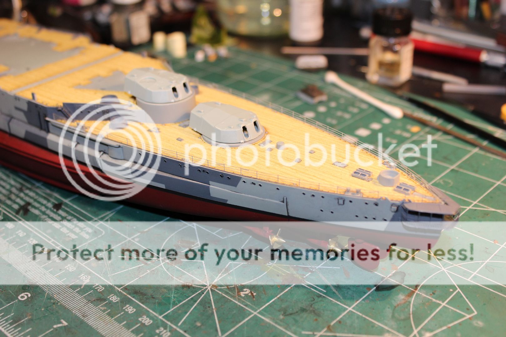

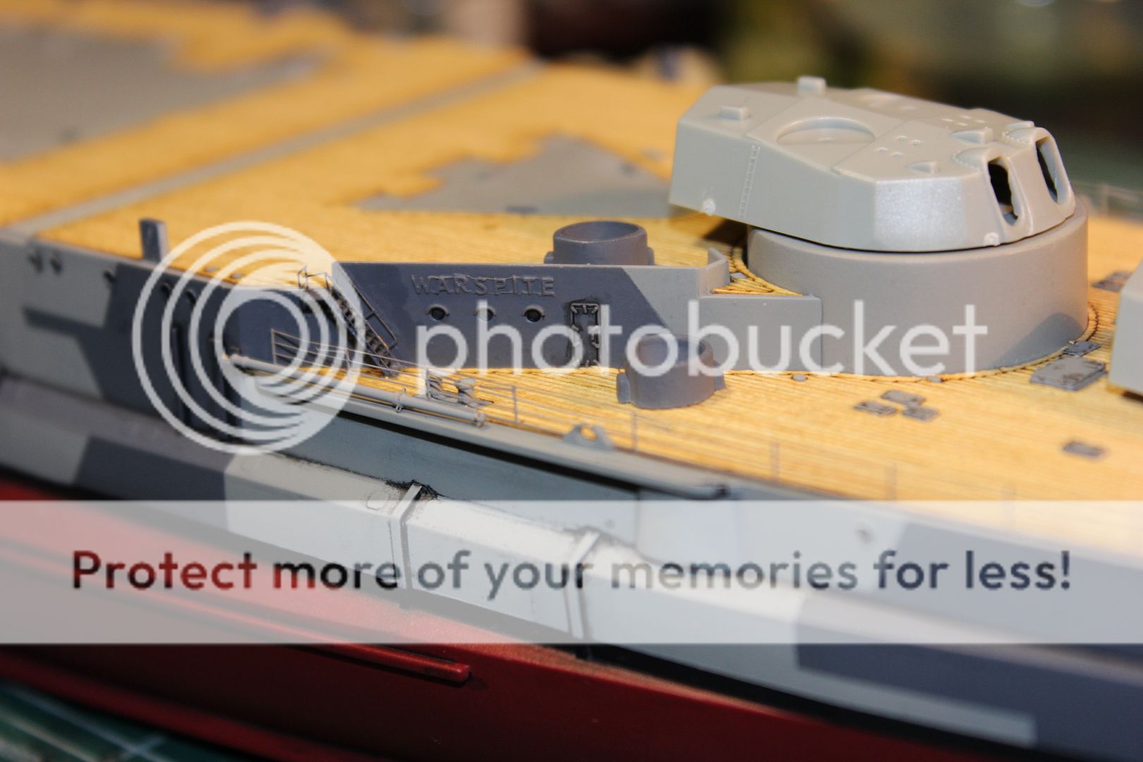

rightwinger26 Posted July 27, 2015 Author Share Posted July 27, 2015 Ok, the etch deck is on! I had to do some minor trimming around A and Y turret, but other than that, the fit was great. I know there are a few spots where it is bubbled, that's ok, when working witht these wood decks, you have to mist water on the plastic to create a barrier to keep the deck from sticking right away, giving you time to move it around as you need to. The down side it the wood expands slightly, it's all good though, because you need to let it sit for a day or so to let the water underneath dry so the deck sticks, by then the wood has shrunk. Other that that, she is for the most part weathered, just some slight rusting to do, and she is sealed with dull coat already. I also installed a few if the tiny etch ladders. More to follow....... Bill Quote Link to post Share on other sites

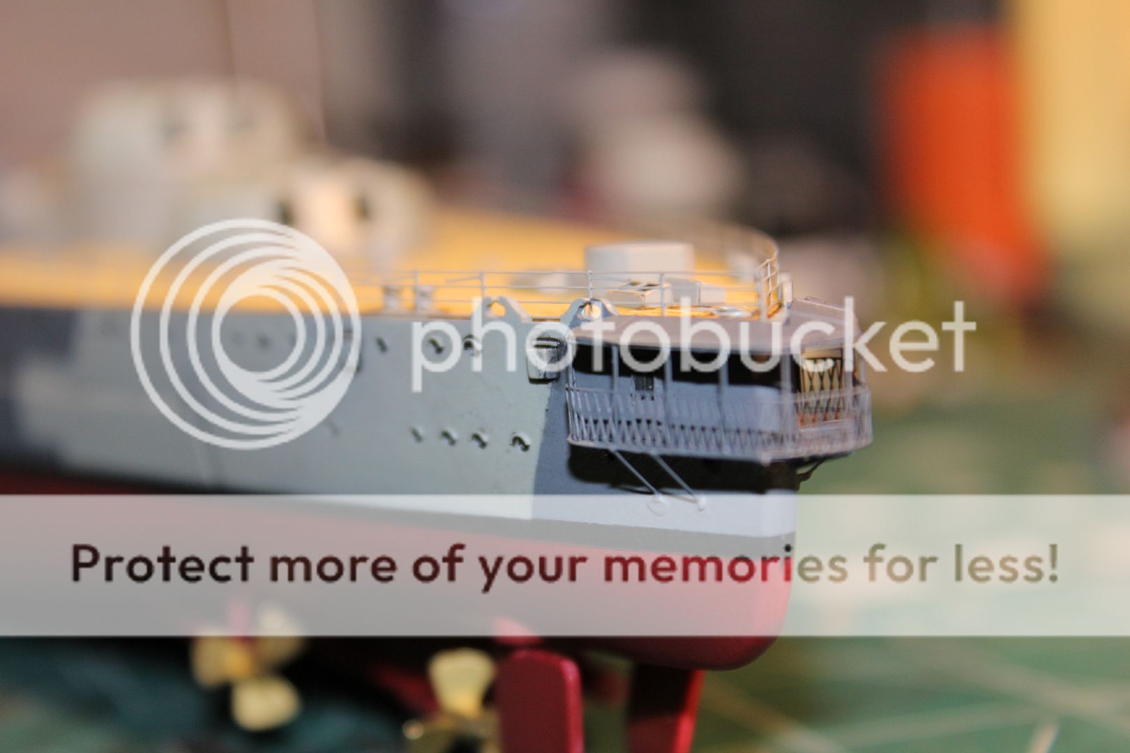

rightwinger26 Posted August 3, 2015 Author Share Posted August 3, 2015 The fantail is for the most part finished, just need to do some touch up on the PE. Next up will be the deck detail amidships, including the catapult. More to follow! Bill Quote Link to post Share on other sites

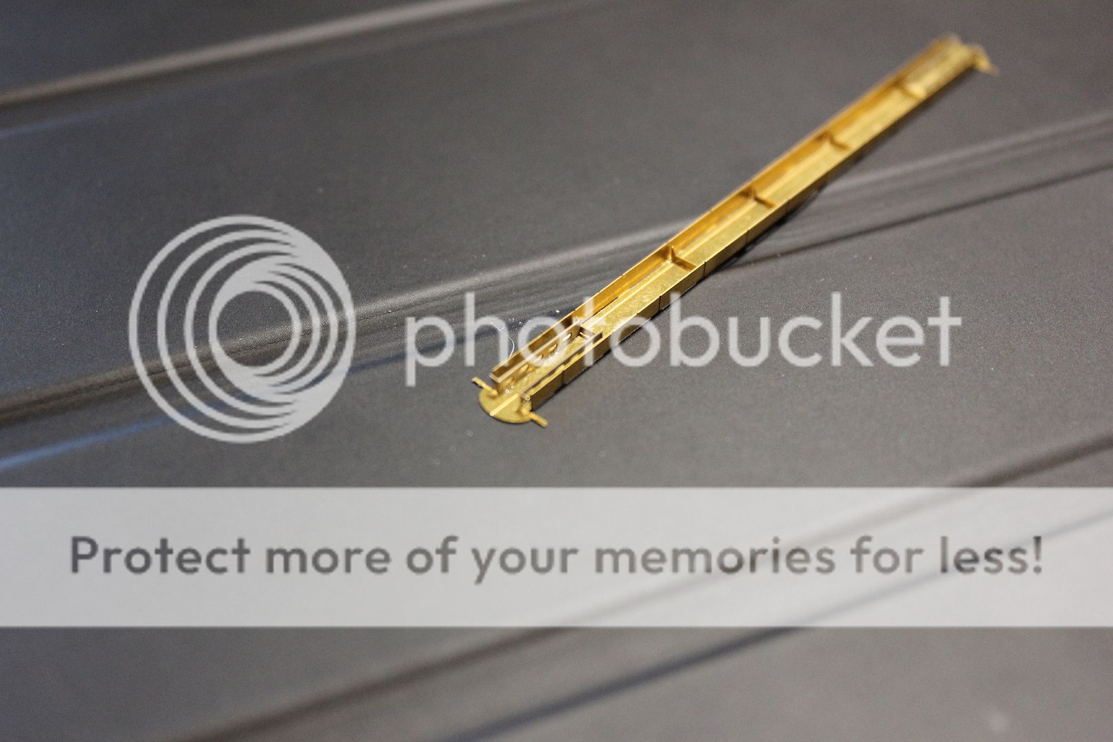

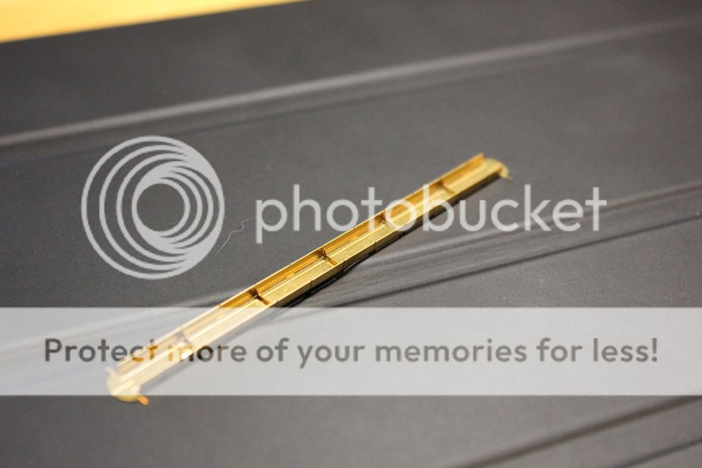

rightwinger26 Posted August 5, 2015 Author Share Posted August 5, 2015 Started work on the catapult, 7 pieces of brass Cobbled together. 4 more pieces, two at each end. Eight more pieces tomorrow, then it will be done. Five of those won't even be visible once the top it on, but I paid for them, so they are getting used. But, for now I'm going to do a little work on the Dark Shark. More to follow..... Bill Quote Link to post Share on other sites
rightwinger26 Posted August 6, 2015 Author Share Posted August 6, 2015 Catapult fin. Not the best picture, but there is still work to be done in that area. I was going to start working on the PE on the foc'sle, as I normally do one level at a time, but I think I might build the first levels of the aft and midship superstructure to start giving her more shape. More to follow.... Bill Quote Link to post Share on other sites

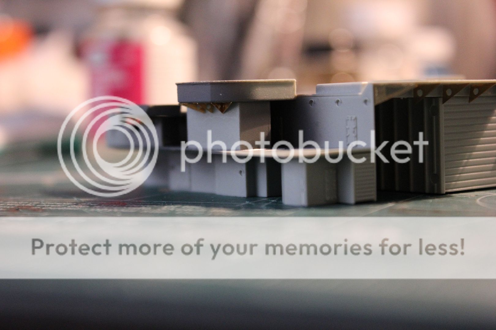

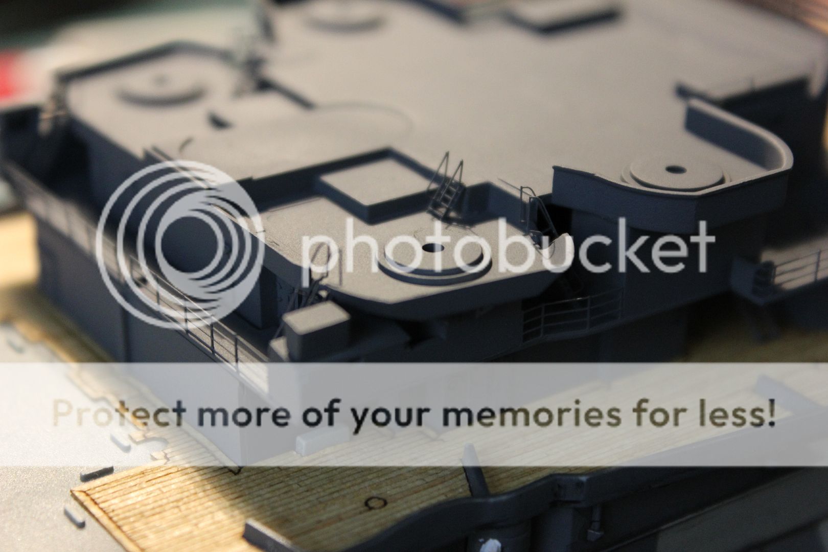

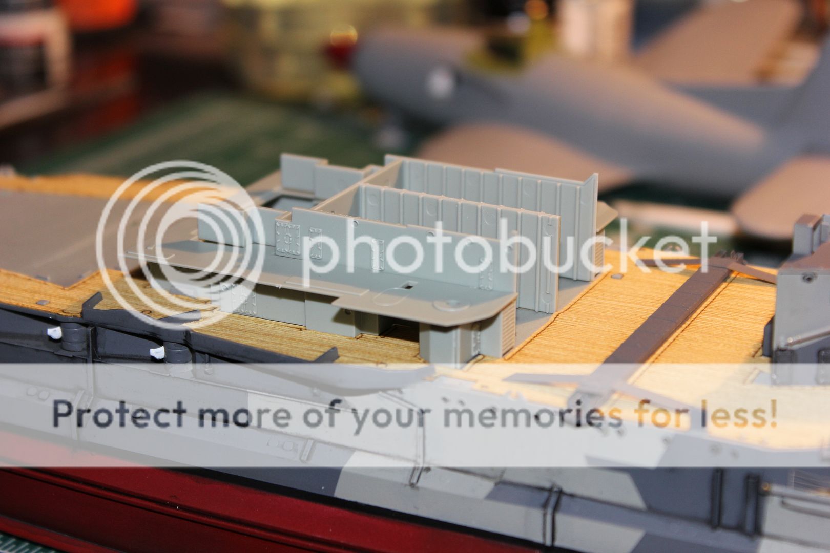

rightwinger26 Posted August 18, 2015 Author Share Posted August 18, 2015 The midship superstructure/hangar is fitted together in three main pieces for now. I still need to do some clean up, and check all the PE before I can fit it all together and paint, that'll happen tomorrow. I still think I am going to leave one hangar open and fold the wings on a Walrus. More to follow.... Bill Quote Link to post Share on other sites

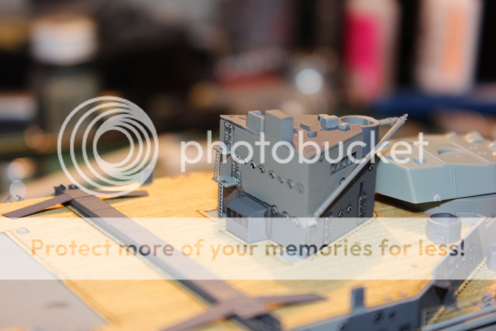

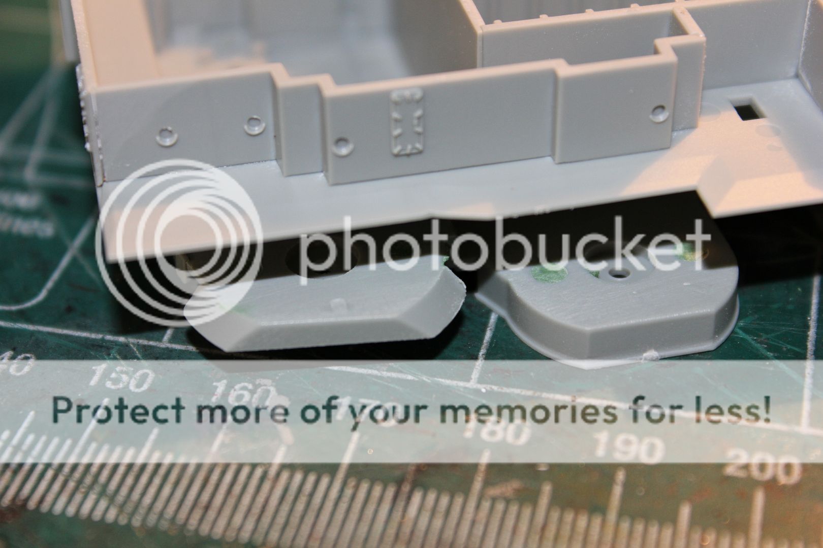

rightwinger26 Posted August 25, 2015 Author Share Posted August 25, 2015 (edited) It's been a while since my last update, but going has been slow. The Secretary of War is out of town for a week, so I'm using his chance to replace all the doors and base board in our bedroom without have to hear about how bad the wood stain smells :thumbsup:/> Anyways, I made some more progress on the midshipmen superstructure, I filled some injector marks, sanded a few seams, removed the molded on supports for the ships boats so they can be replace with PE later on. In a little bit, I'm going to paint behind the areas where the pictured parts of superstructure go, then install them. Why didn't I do that first you ask? Cause I'm a dumba@$ and forgot. Once that is done, I can install the etch angle irons and ladders, then paint the rest. More to follow! Bill Ps, everything in that top photo has been sanded smooth. Edited August 25, 2015 by rightwinger26 Quote Link to post Share on other sites

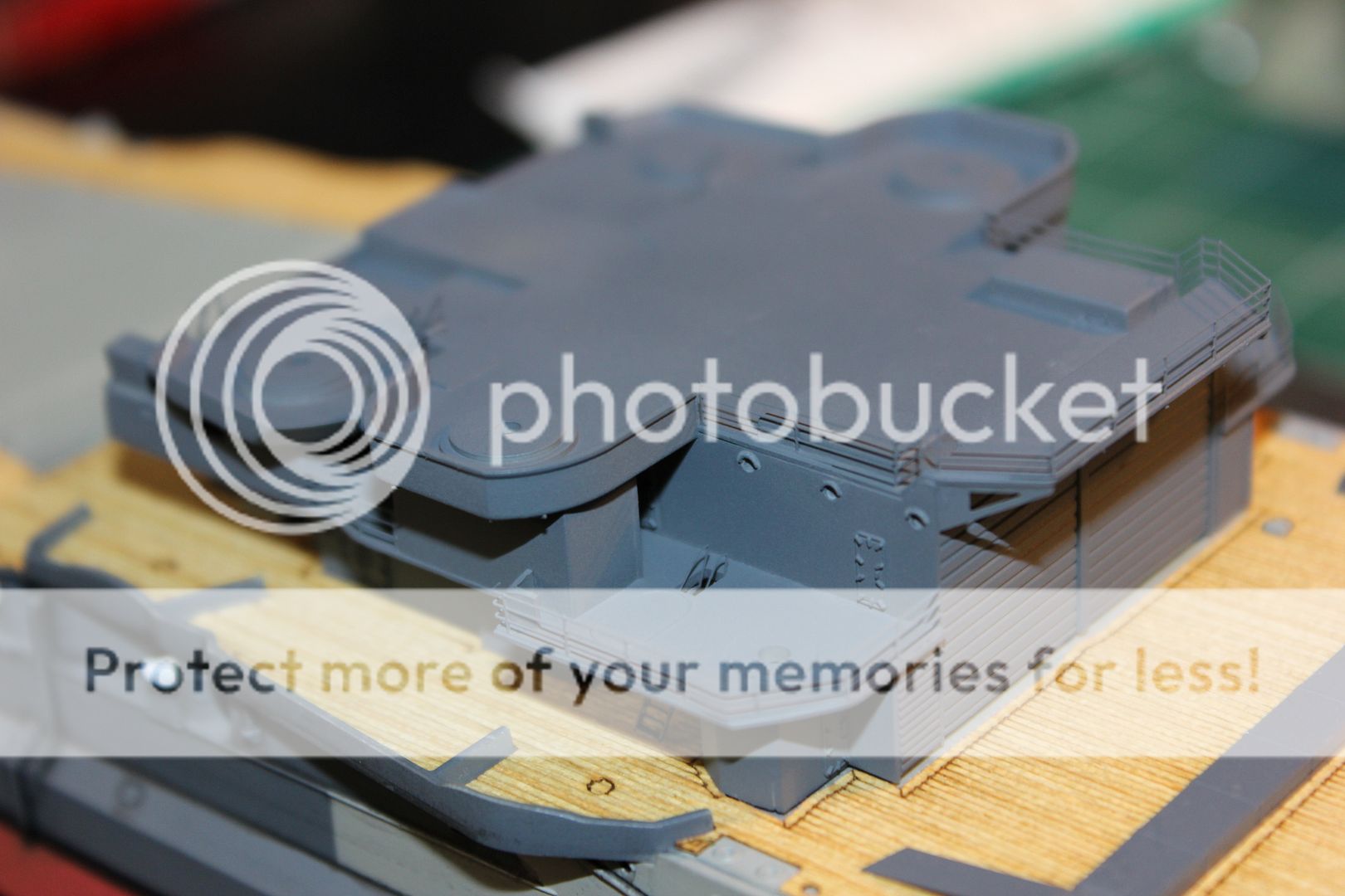

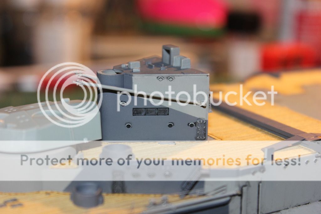

rightwinger26 Posted August 29, 2015 Author Share Posted August 29, 2015 Midship superstructure done.....for now. Next, time to tackle the bow! More to follow Bill Quote Link to post Share on other sites

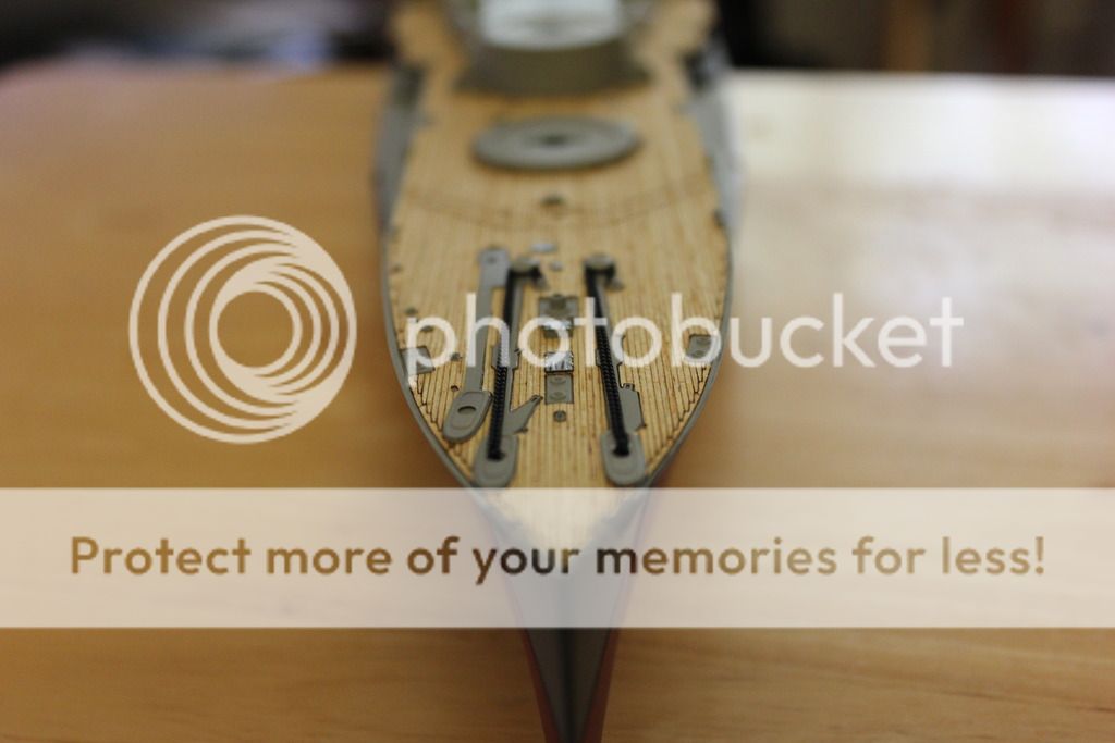

rightwinger26 Posted September 5, 2015 Author Share Posted September 5, 2015 I've been slacking, actually working on other kits, but whatever. I've gotten about half of the PE installed on the bow and two of the anchor chains. I only worked with the PE that didn't need to be folded, because, quite frankly, I'm watching football and I'm very distracted. Maybe tomorrow I'll get around to the rest, and I can finish all the main deck railings. More to follow! Bill Quote Link to post Share on other sites
