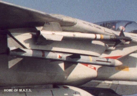

Murph Posted August 11, 2015 Share Posted August 11, 2015 (edited) It could have been either missile type. As Jennings pointed out USAFE typically had first dibs on the new toys at the time. One thing to keep in mind is that U.S. missiles were transitioning from white to Light Ghost Gray in the early 80s. As a rule, the AIM-7M would be overall gray since it entered service in '82, but the AIM-7F and AIM-9L/M could be all gray, all white, or a mix of the two colors. Link to AIM-9 with different color sections. Regards, Murph Edited August 11, 2015 by Murph Quote Link to post Share on other sites

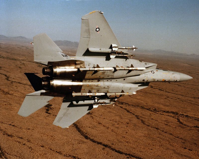

Fly-n-hi Posted August 12, 2015 Author Share Posted August 12, 2015 Thanks Murph! Do you happen to know what a typical load out would be for the jets that were armed? 4 AIM-9s and 4 AIM-7s? 2 and 2? Quote Link to post Share on other sites
Murph Posted August 12, 2015 Share Posted August 12, 2015 (edited) Thanks Murph! Do you happen to know what a typical load out would be for the jets that were armed? 4 AIM-9s and 4 AIM-7s? 2 and 2? In that timeframe Zulu Alert at Bitburg (and Soesterburg) was configured with 4 AIM-7, 4 AIM-9, a live gun, and a centerline tank. If the kit has them, this predated the chaff/flare dispensers, so fill those in. Regards, Murph Edited August 12, 2015 by Murph Quote Link to post Share on other sites
