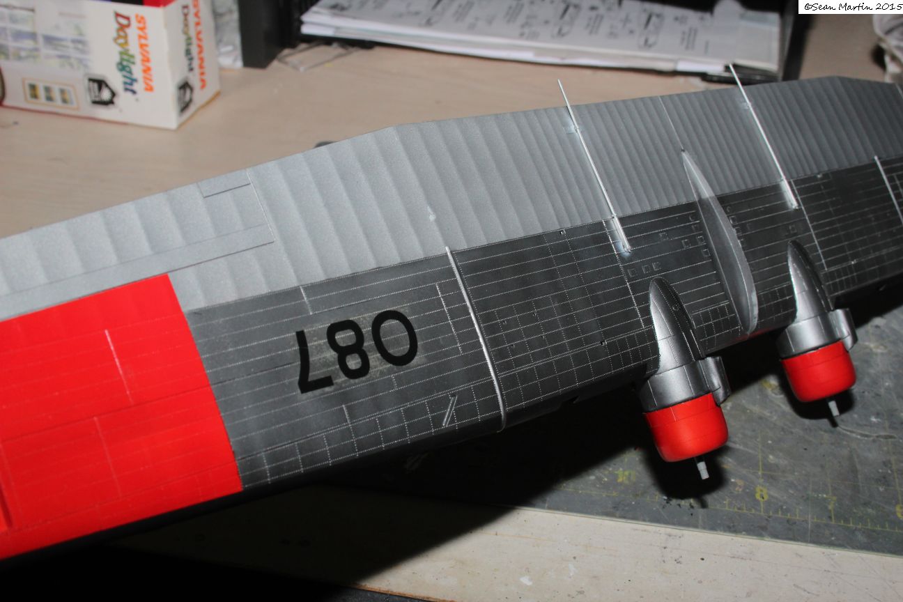

The back half of the wing is fabric covered so the colour is going to be slghtly different than the wing. The wing would have been painted while the fabric doped. It could be a case of the dope being a slightly different shade as the paint, or the dope faded differently than the paint and you get a slight mixmacth.
The easiest way to do this is paint the wings yellow, then lighten the colour slightly, mask and mist the fabric with this lighter colour.
You cans see an example of this on my corsair build below. Its a little extreme in this case
but you can also see on this wing from my Canso where the metal was left unpainted and the fabric would have used aluminium dope
hope this helps.

Ah! Looking at the wing, I can clearly see the aluminum leading edge and fabric trailing edge. That's exactly what I needed, THANKS!

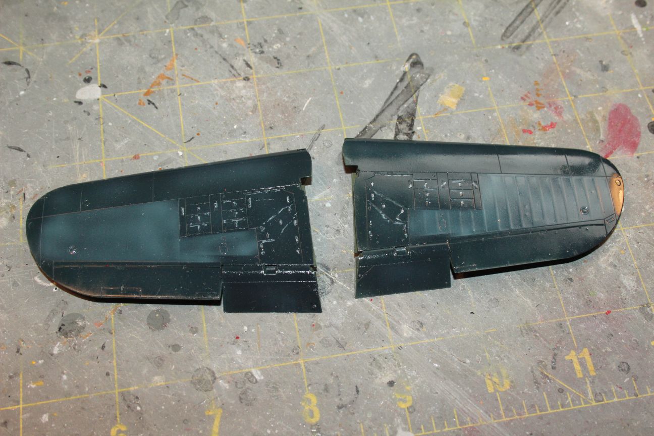

With a fair amount of filing and contouring, I got the bulkheads trimmed down so the fuselage now closes.
