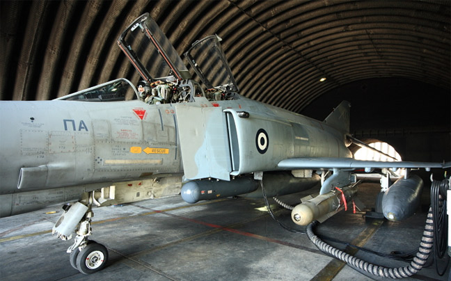

Finn Posted October 28, 2015 Share Posted October 28, 2015 A couple of F-4 GBU-8 pics from different eras and air forces: http://sistemasdearmas.com.br/pgm/gbu8kmu390.jpg http://www.newsbeast.gr/files/1/2011/12/02/hoboslgb2.jpg Jari Quote Link to post Share on other sites

mrvark Posted October 29, 2015 Share Posted October 29, 2015 A couple of F-4 GBU-8 pics from different eras and air forces:http://sistemasdearmas.com.br/pgm/gbu8kmu390.jpghttp://www.newsbeast.gr/files/1/2011/12/02/hoboslgb2.jpgJari The thing to note on the Vietnam-era F-4D is that they spray painted the top quadrant of the bombs white. Ron Thurlow pointed this out to me--I think he found it in a report about the EOGBs. I think it was to aid in visually tracking the bombs as they went wherever they went--occasionally even to the target! The pic of the Greek jet is fascinating--CLEARLY not an air show pic and the presence of the Litening pod (not to mention the gray camouflage) makes it clear that this is a pretty recent pic. I'm amazed that the things are still functional! A quick second version of the drawing, with the 'other' version included too. Plus I found a Teledyne-Ryan video that showed roughly what the shape of the aerodynamic fairing was. Jim, do you have any idea which is which?Rob Excellent drawings, Rob! At this point you know as much about these bombs as I do. If I had to guess, I'd say that the top one is the GBU-4 and the bottom one the GBU-5. Turkish Air Force actually used up some of its inventory of GBU-8 HOBOS in operations against the PKK (Kurdish separatists) in mid 1990s. Interesting, isn't it that the Israelis, Greeks, and Turks all ended up with them? Quote Link to post Share on other sites
