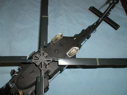

Wow Chris that looks really great. So much detail to take in and the rotor blade work looks really clean for a pretty major mod.
Kudos man.
Well I'm a day late and a dollar short, but great work, Chris! 35th scale is just so dang huge, I don't know how you guys do all that detail work. I hope to see some orme of your stuff. Maybe a Huey?

Hey Chris, the pictures are not showing up anymore, I would love to see your bird as I am planning to do at least two Blackhawks myself, but I am new, so I have no illusion of having a finished product even remotely close to what you have done.

The photos were in photobucket and when they wanted money to use the site I dropped it. I will make a new series of photos and make them available here or by direct email.
Chris M
I do not have a very expensive camera so good close ups are kind of limited.
Chris M
Started out as Academy DAP. All that now goes out the window with Kitty Hawk kits. Granted they have a few errors but they look to be a nicer build.
