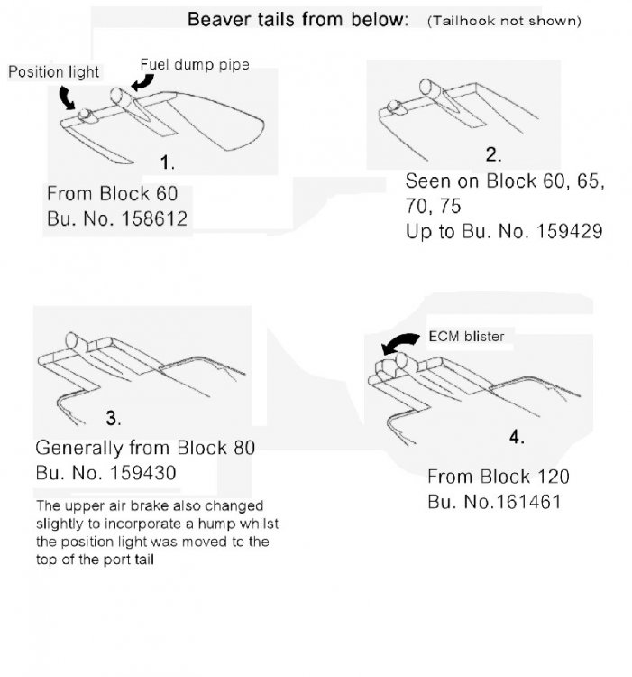

82Whitey51 Posted October 13, 2016 Share Posted October 13, 2016 (edited) If I wanted to build that VF-32 bird (with the Bicentennial stripes on the tail, a/c 220, BuNo 159612)...can it be built from the Tamiya kit? It's an earlier block without the nose pitot tube (an option in the kit according to the VF-2 profile), but is the beaver tail correct for it? I'd also imagine there are no tail stiffeners and that it has the proper gun vents? Edited October 13, 2016 by 82Whitey51 Quote Link to post Share on other sites

A-10 LOADER Posted October 13, 2016 Share Posted October 13, 2016 1 hour ago, 82Whitey51 said: If I wanted to build that VF-32 bird (with the Bicentennial stripes on the tail, a/c 220)...can it be built from the Tamiya kit? It's an earlier block without the nose pitot tube (easy fix), but is the beaver tail correct for it? I'd also imagine there are no tail stiffeners and that it has the proper gun vents? The VF-32 Bicentennial jet can be built from the Tamiya kit Whitey. This particular jet is a Block 85 aircraft. I personally don't have the Tamiya kit although I have seen it. As long as the kits beaver tail looks like the #3 option, your good. The kits gun vents are correct as well. Quote Link to post Share on other sites

82Whitey51 Posted October 13, 2016 Share Posted October 13, 2016 51 minutes ago, A-10 LOADER said: The VF-32 Bicentennial jet can be built from the Tamiya kit Whitey. This particular jet is a Block 85 aircraft. I personally don't have the Tamiya kit although I have seen it. As long as the kits beaver tail looks like the #3 option, your good. The kits gun vents are correct as well. Yes, the kit beavertail is like the No. 3 option there...and I noticed looking at sprue shots that the pointed nose part is included in the kit as one of the options is the VF-2 bird (BuNo 159625) of the same block. Cool! Thanks for the info, didn't want to blow money on decals that wouldn't match. Quote Link to post Share on other sites
