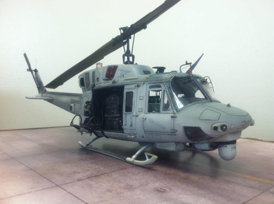

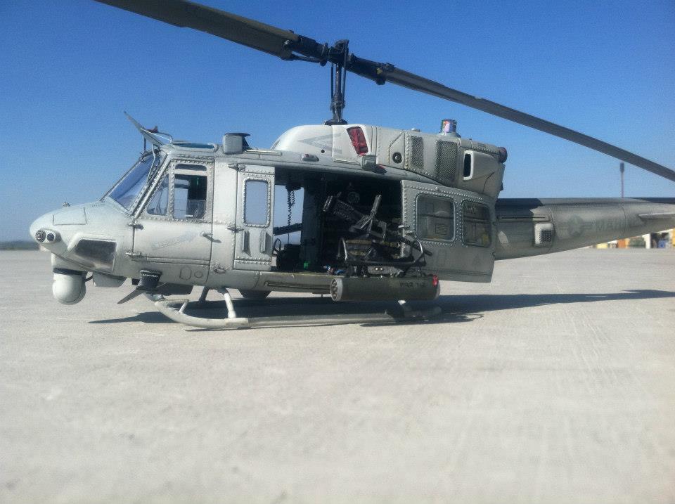

On 03/01/2017 at 11:02 PM, usmcski6502 said:
Outdoor shot:
Wow that is one nice model!  Yea I think I'm going to have some custom made,  still unsure of what airframe tho....
