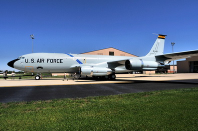

yardbird78 Posted October 19, 2016 Share Posted October 19, 2016 126th Air Refueling Wing, Air National Guard, Scott AFB, about 2010. Quote Link to post Share on other sites
