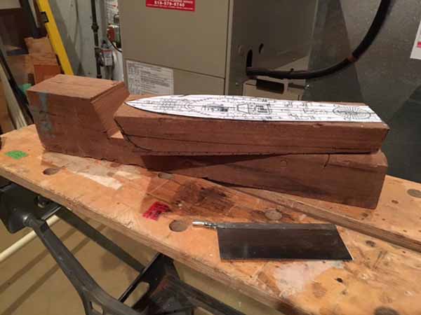

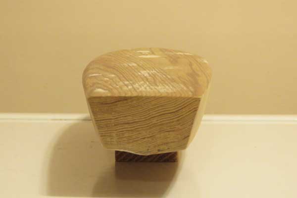

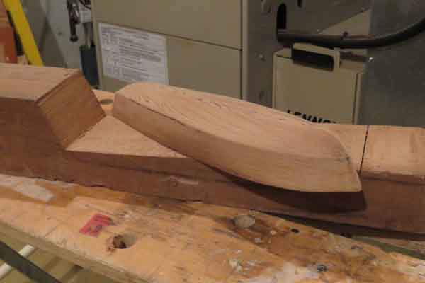

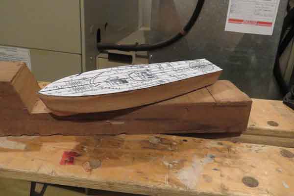

After tracing the shape of the hull on the 4x4, a rough shape was cut out.

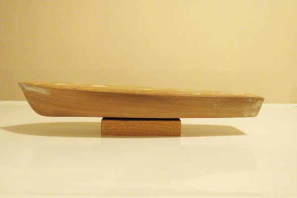

Then lots of cutting, filing and sanding to make the hull shape.
Next up, I’ll be finish sanding the hull & deck shape & start adding hull details.
Thanks for looking.

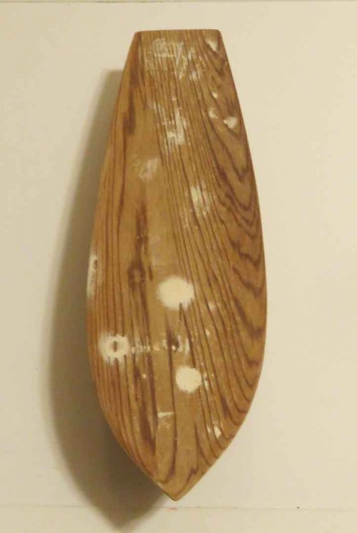

I've finished most of the hull sanding & filled all the remaining deep gouges, holes, etc. with putty.  The putty was sanded to a smooth finish.

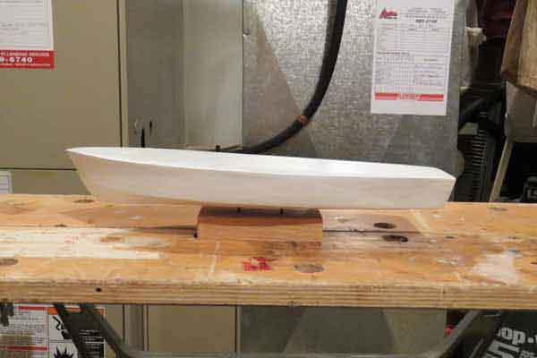

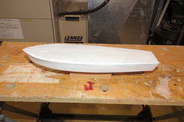

Once I was happy with the hull surfaces, I applied a thick coat of white primer/sealer paint.
The sealer/primer will provide a hard smooth finish (once sanded) & good base for the finish paint.
Next up, finish sanding the primer/sealer.

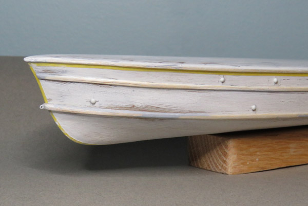

I've started to add some details to the hull.

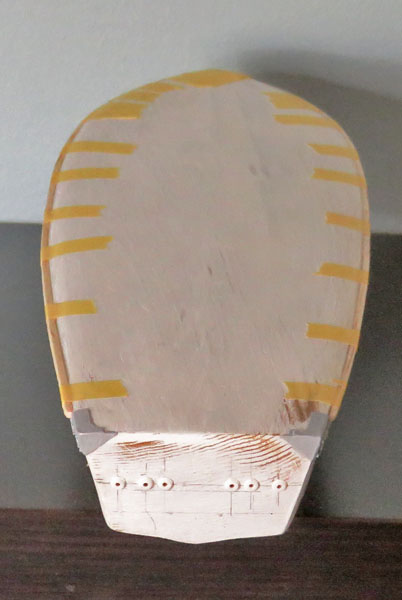

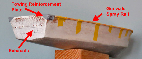

There are three rails that run the length of the hull.
I've made the rails from strips of balsa wood.  So far, I've glued on the gunwale rail (held in position with tape) & am currently waiting the glue to dry before sanding the rail to the proper shape.  I'll locate the other two sets of rails once the gunwale rail is complete.
I've also made towing reinforcement plates from paper card stock & added bolt heads using drops of white glue.  I'm not worried about detailing the small hardware, other than showing the they're there, since the details aren't really visible at this scale.

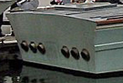

Six exhaust outlets were added to the transom similar to those shown in the photo below.
I made these from plastic tube and discs hole-punched from a paper sheet.  Again, I'm not too worried about detail at this stage, since each exhaust will be covered by a muffler/vent flap.
Here are a couple of photos showing the progress, to date.
Thanks again for looking.

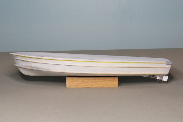

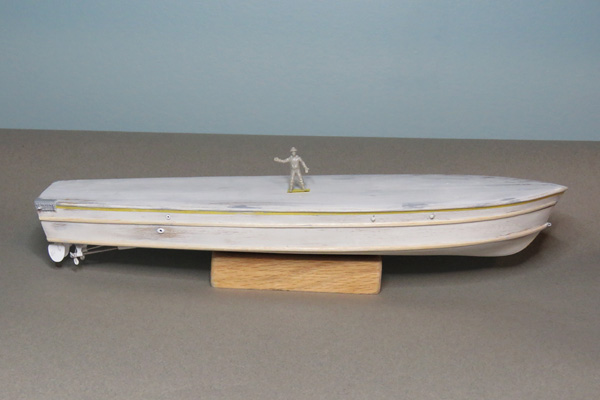

The hull is complete & ready for paint.
 Here are a few photos showing the progress to date.  The hull looks pretty bad at this stage after filling all the defects with putty, and sanding everything smooth in preparation for paint.
First, photos of the port & starboard sides showing the addition of scratch build splash rails, bow reinforcement, vents & ports, front & rear towing eyes, propellers, rudders, & underwater exhausts.
 I’ve also added a scale figure to give you an idea of the boat’s size.

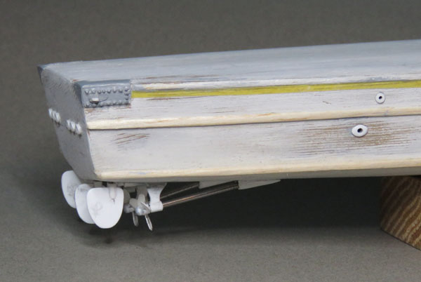

A close-up of the starboard quarter, including scratch built;
-      -  Evergreen plastic tubing outlets,
-       - Evergreen plastic sheet towing eye.
-       - Rudder & propeller assemblies.

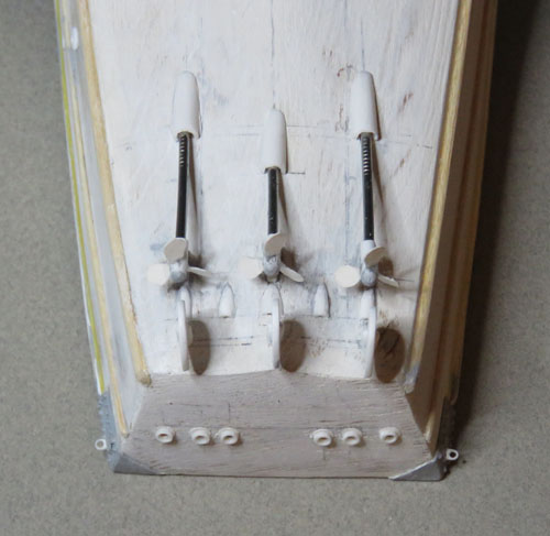

A close-up of the stern, including scratch built;
-       -  Evergreen plastic sheet & tubing rudders.
-       -  Finish nail propeller shafts.
-       -  Propellers made from Evergreen plastic tubing hubs & paper card blades.
-      -  Underwater exhausts (between propellers & rudders) & propeller shaft fittings made from Evergreen plastic tubing.

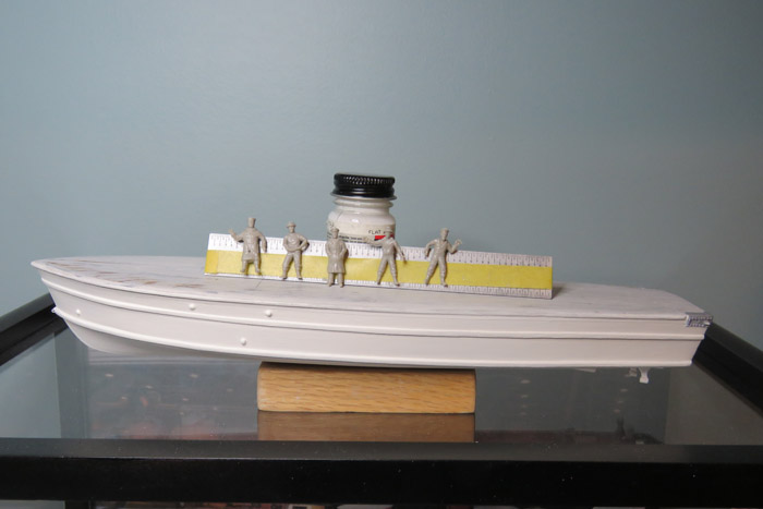

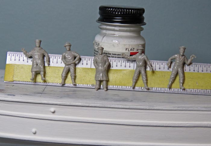

Me too!  I like adding crew figures to my builds to give each model a sense of scale.  However, one of the downsides of scratch building British & Canadian naval vessels is that there are not a lot of 1/72 British/Canadian Navy crew figures available.
As a result, I've been pirating figures off some of my plastic model kits. e.g. I used figures included in Tamiya's 1/72 Perkasa Patrol Boat kit for my Fairmile build.
This time, I've conscripted five sailors from the Matchbox Flower Class Corvette model kit.
Here's a couple of quick pic's showing my motley MTB crew.  I might modify the figures a little, depending on where they will be stationed on the boat.
John

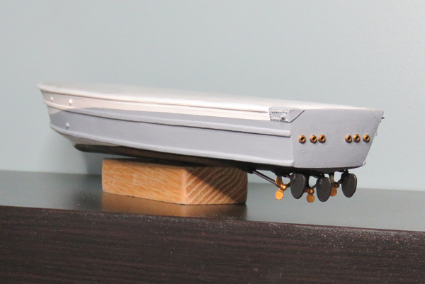

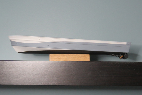

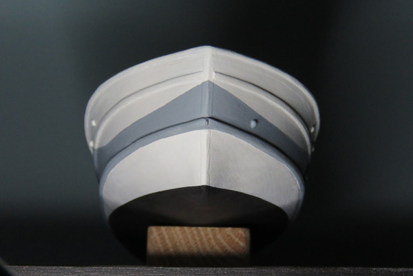

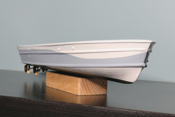

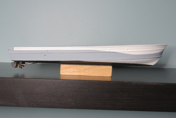

The hull sides, bottom & stern has received its final coat of paint.  The paint colour is the grey and white British Coastal Forces camo scheme.  White is used the minimize the visibility of shadows when the boat is illuminated from above.
Here's a few pic's.
019 Painted Hull.jpg020 Painted Hull.jpg021 Painted Hull.jpg022 Painted Hull.jpg023 Painted Hull.jpg024 Painted Hull.jpg

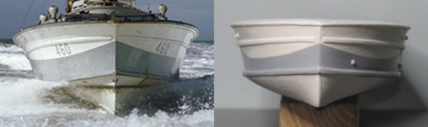

And a comparison pic showing the actual boat paint scheme.
Next up I'll start building the deck detail.

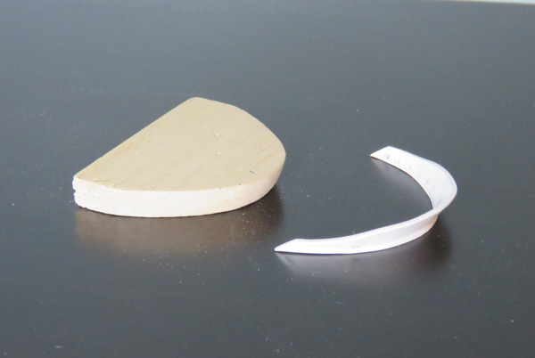

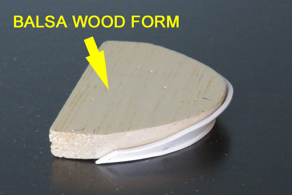

To make the breakwater, I made a balsa wood form using the shape and scaled dimensions taken from drawings and photos.   I made the breakwater from pieces of Evergreen plastic, and carefully bent it around the balsa wood form using a heat gun to make the plastic pliable and to hold its formed shape when cooled.
It turned out not too bad, and sits nicely on the boat’s curved deck.

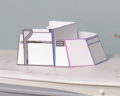

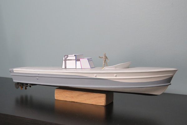

Also, I’m currently drawing the shapes for the bridge and wheelhouse.
As with most of the prep work for the build, I trying to keep the drawings simple using Photoshop Elements, and will add the detail to the model itself.

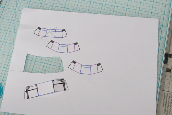

To verify I have the correct size, shape, & fit, I’ve been printing the simple drawings on paper, then cutting out the shape, and folding it to the required dimensions.  This usually means a little trial & error and a few tries before the correct shape is achieved. :bandhead2:   I’ll use the final drawings to make the final parts.
You can see in this next photo how small the bridge & wheelhouse are relative to the size of the hull.  Also, you can see how the boat design was based on the designer’s boat racing experience.   These boats were definitely built for speed, and not for the comfort of the crew.

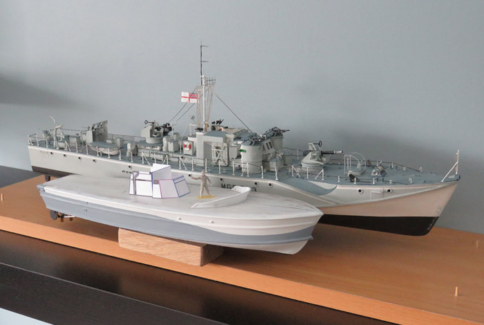

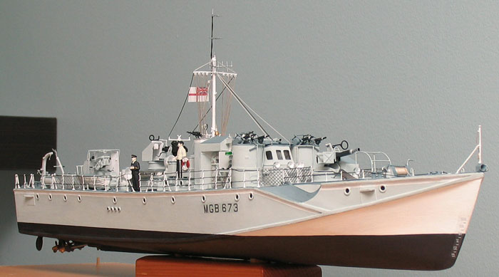

Here’s one more photo comparing the 71-6"’ MTB to my 115’ Fairmile D MGB.   Although these two boats served in Coastal Forces at the same time, note the differences in the camo paint design and colour.

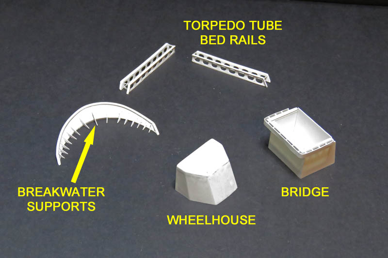

I've had a little time over the past couple of weeks to build a few deck structures using plastic card, including the bridge, wheelhouse, torpedo tube bed rails, as well as adding the supports to the breakwater.  It's been finicky work getting the proper angles and matching the contour & curvature of the deck.
Here are the results, so far;
I've placed the structure on the deck, to help visualize the overall layout, and to make sure that everything fits properly.  So far, so good!

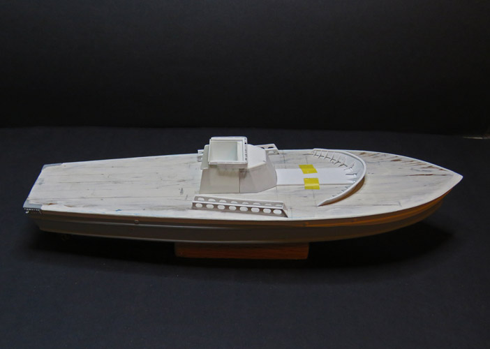

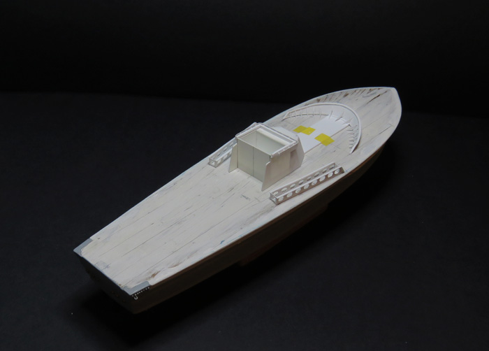

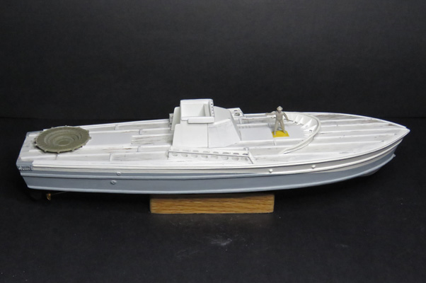

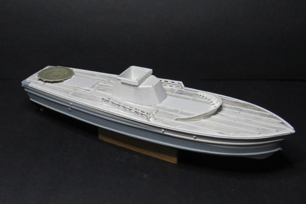

Hi again!

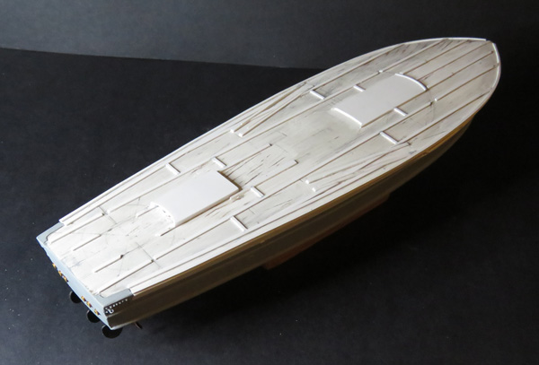

I just finished adding ribs (I think that's what they're called :rolleyes:) to the deck surface, using plastic strips.  It seemed like a simple task at first, but I found it took some time to ensure the strips were located correctly, & straight, plus ensuring the parts I already finished fit properly.
Here's  couple of photos of the 'ribs' glued to the deck.
And, a few photos showing the finished parts test fitted on the deck.  I've placed the Coastal Craft resin Oerlikon 20mm cannon ‘bandstand’ to check it's fit & location, as well.
