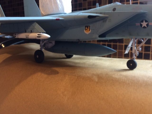

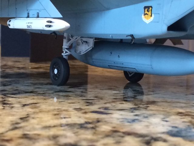

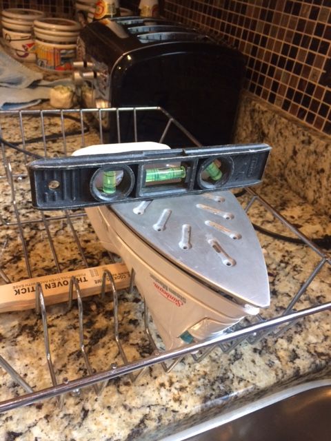

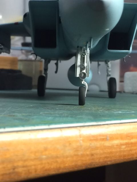

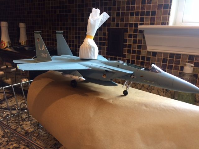

82Whitey51 Posted December 12, 2016 Share Posted December 12, 2016 (edited) Modern aircraft (and older types too) have pretty high tire pressures. As the aircraft sits on deck, the tire area touching the tarmac will be flat on the surface...and us model geeks like that look, it looks "real". This, does not look "real"! : I typically achieve the look by running a fresh sheet of sandpaper under the tire as it sits on a flat surface, but the risk of breaking something is high there. Yesterday I decided to try a method that a buddy of mine shared...sitting the model on a hot iron. Sounds more risky, man! Well, the idea, is to set the model on a warm surface and let gravity take over...not drop your model into a deep fryer. 1. Set the iron up so it is level. Pretty important. Improvise, adapt, overcome! I was going to set my iron on a baking rack the wife has, but the handle of the iron was too wide...the dish drying rack on the other hand, would work fine. I selected the lowest heat setting, sat it in the rack, and leveled it... PRIOR to plugging it in! I used a couple of oven sticks to get the iron level and situated. 2. Place a piece of wax paper onto the iron. This keeps the wheels from sticking to the iron, and also keeps melted plastic and paint off of the iron...pretty important for tranquility in the household. 3. Plug up the iron and let it get warm. 4. Place the model onto the warm surface. (Test fit placement prior to plugging up. You want the wheels to fit onto the surface evenly and not have one falling into one of the holes. You may even want to mark the wheel placement.) Here we go... My buddy likes to press lightly on the top of the model, in an even manner to get the wheels pressing down. I have a steel weight that I used in this case. Bottom line, you want to watch the wheels closely and make sure they are each "melting" evenly. It doesn't take long, and you only get one shot so be careful! I left this F-15 on the surface for less than one minute. The main wheels reacted just fine under the weight, the nose I had to lightly press on to get an even flat spot. I'm happy with the results, and it was easier than sanding them. The set up and prep took much longer than the process. Edited December 13, 2016 by 82Whitey51 Quote Link to post Share on other sites
