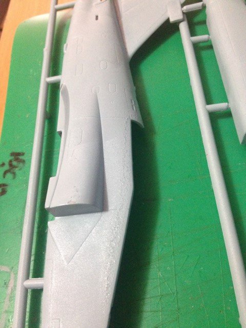

A21-29 Posted December 16, 2016 Share Posted December 16, 2016 (edited) Gents, i was given an airfix 1/48 hawk kit which i am very keen to turn into a RAAF LIF bird. Now the kit has not been started,but was sprayed with something while still on sprues.i am not sure how long ago this was done but a good soaking over night with Mr Muscle in a sealed container and scrubbing next day with toothbrush did nothing to remove any paint.. The rough surface and slight bubbling the kit had before i attempted to remove is still present..any suggestions,ideas,words of wisdom or guidance to help with this problem ? i can only think to drown a second time in oven cleaner or lightly sand the worst affected areas. please help haha.i really want to build a nice bird from this kit. Thanks in advance . Edited December 16, 2016 by A21-29 Quote Link to post Share on other sites

scotthldr Posted December 21, 2016 Share Posted December 21, 2016 (edited) Looking at the picture is it paint, it looks like a defect in the actual plastic? Edited December 21, 2016 by scotthldr Quote Link to post Share on other sites

A21-29 Posted December 22, 2016 Author Share Posted December 22, 2016 6 hours ago, scotthldr said: Looking at the picture is it paint, it looks like a defect in the actual plastic? its paint.boxed it back up and put back in the stash..i cant be bothered with it for now.have plenty of others to build and enjoy in the meantime . thanks for all the suggestions,links and advice gang. /thread. Quote Link to post Share on other sites
