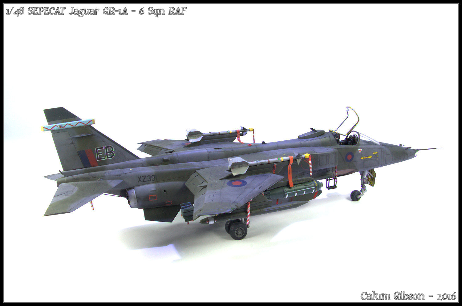

The supplied software has been fine for what I've done so far. I've used it to cut 1/48 RAF roundels and code numbers. I've experimented with cutting little rectangles with dimensions 1mm to 2mm for no step lines.
All the main markings and serial numbers in this were cut using the Sihouette Portrait, I used masking film for these
The rear serials on the Jag were also done on the Sihouette Portrait,. These were cut on cheap label paper from a stationary store.
Roundels on this were cut with Tamiya masking sheet

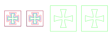

I make SVG files in InkScape and then use Robocut on my Linux box to drive a Silhouette Portrait cutter.  Various SVG files are available online, including this USAF roundel from Wikipedia.
PM me with your email address and I'll send an SVG of the below image that I've used to cut a mask.
