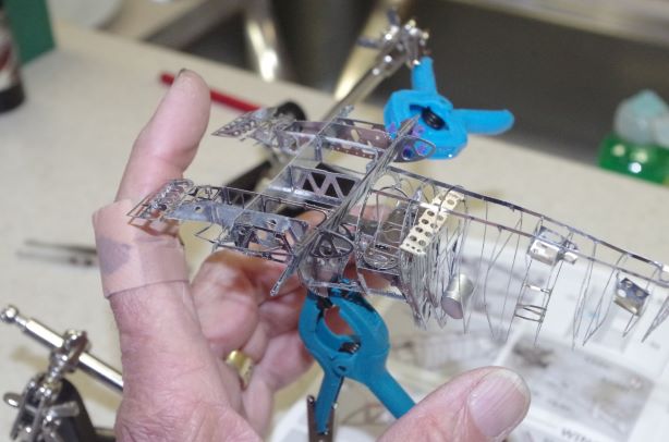

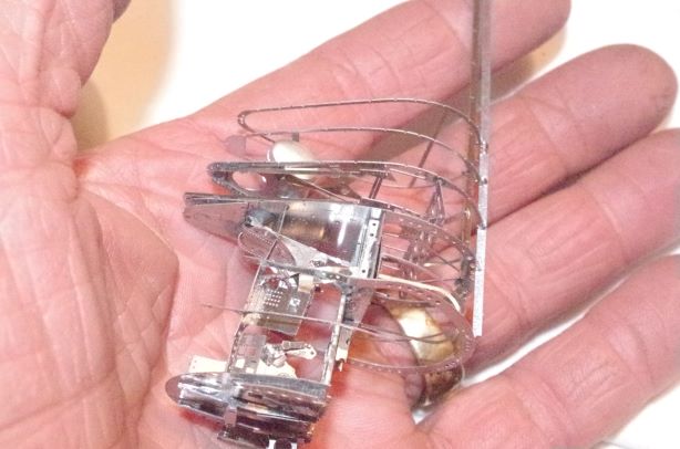

Having just started this model I am astonished at how difficult it is. Coming from a lifetime hobby of stick and tissue models, I was not ready for this!  First, they are incredibly tiny.  I started with the cockpit area, one of the most difficult it seems.  One demerit for ignorance.  I read mention of using solder in construction.  I just can't visualize this!.  How is it done?  The adhesive Bondic looked promising.  It is similar to dental adhesive, using UV light to cure.  Way too thick and messy.
I'm using CA (super glue).  I started with gel and found it's too thick, tending to leave big globs of glue.  Just too thick.  After some experimentation I ended up using ZAP thin CA, applied with a 0.5 ml syringe.  They are available in bags of 40 for $15.  Each one is useable for several hours before the CA kicks off.  The tiny size and long needle allows placement of minute drops of CA exactly where needed.  This works well anywhere there is more than point contact at the joint.
"Third hands" are useful.  A pair of them are handy to position the parts being joined.  $8.50 on eBay.
I would appreciate any helpful hints from those in the know, and any work-in-progress shots.

After about 20 hours I realize I'm just not good enough to finish this very challenging model.  If it weren't for the photo on the box I'd swear it can't be done.  I can't imagine the tooling it would take to hold these extremely delicate components in place at each joint, and getting in to apply the CA.  The "third hands" mentioned above are way too big and clumsy to help with the busier assemblies.  I gave up just aft of the cockpit.  The Gator's Grip looks promising.  I'll try it.
I have most of what I have completed on display at our local library.  What's there is still very impressive to the casual observer.  I highly recommend this kit for someone with experience with tiny and complex PE models before, and possesses incredible amounts of patience.  If you don't have both the patience and the experience, don't attempt it.
QUESTION: has anyone in the group actually finished this build?  Comments on how?

9 minutes ago, Newby said:
Did you build this? I'd love to see photos of the construction technique. How were the components held in place while attaching? What adhesive was used????
I don’t have too many in progress pictures.  I soldered most of the parts together.  Much better and cleaner than using super glue.

3 minutes ago, Newby said:
I'd dearly love to see a soldering iron small enough to be of use here.
I use a Weller with a fine tip. I will get some solder on the tip after tinning and place it over a fluxed joint.
Stainless is more difficult to solder than brass, so it needs more heat.
