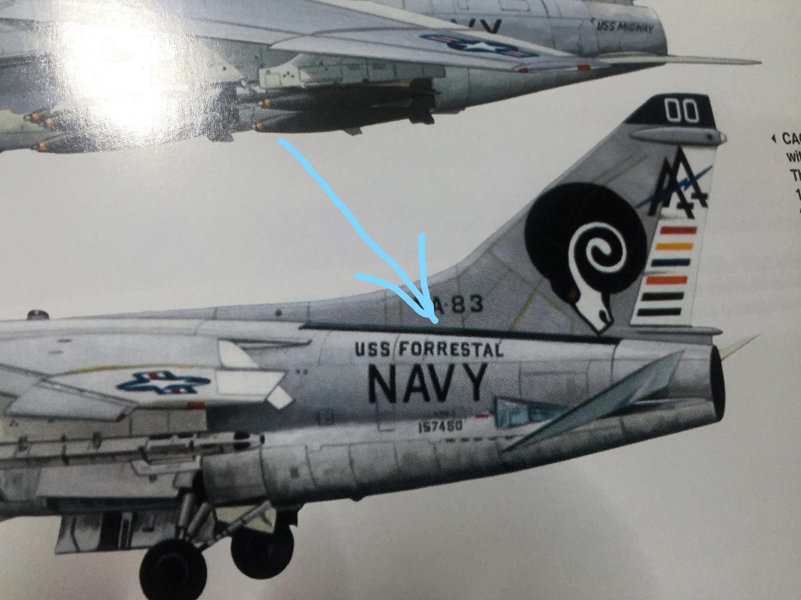

Hello CJ 🙂
Tell me please if you know , what color often painted the stripes ( marked  arrow) on the tail part ...
Thanks !
Inked54_LI.jpg.38f570e47f5406ba6cce29b0a
Edited by TTomcaTT
Hi Joel, GWH, Aigore, thanks!   : )    Hi Vitaliy,  I have them as Non-skid walkways - Dark Gull Gray - FS 36231
Edited by crackerjazz
CJ , аlways used on Corsair Dark Gull Gray in NAVY ?
Edited by TTomcaTT
