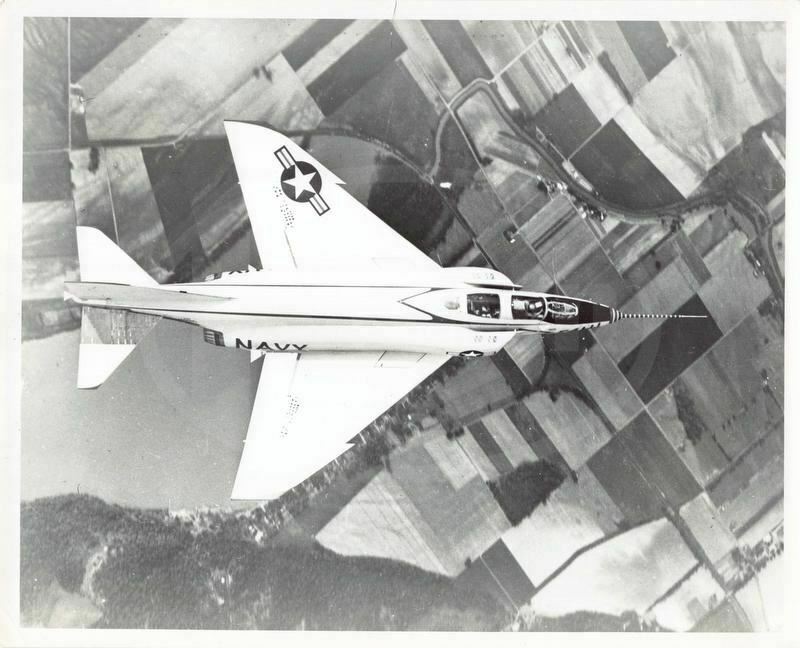

Cubs2jets Posted October 7, 2021 Share Posted October 7, 2021 (edited) Found this image on e-bay. Edited October 18, 2021 by Cubs2jets Quote Link to post Share on other sites
