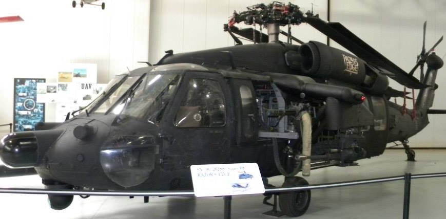

Just for giggles, here’s Super 68 (90-26288) as she currently sits in the US Army Aviation Museum.
I may have some shots of 10th Mountain Cobras too.  Will see what I can find.
Edited by Cobrahistorian
