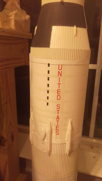

niart17 Posted March 27, 2018 Author Share Posted March 27, 2018 yeah, I'm going to be relying on your build along with a lot of other guys here to hopefully come out with a decent representation. Here are a couple of more shots of where it is currently in the process. I have a lot of touching up to do and probably repainting some rough edges here and there, but overall happy with it for the most part. first stage with a printed bottom section. The print lines are pretty obvious but like I said, I like it better than smooth but wrong shape. Quote Link to post Share on other sites

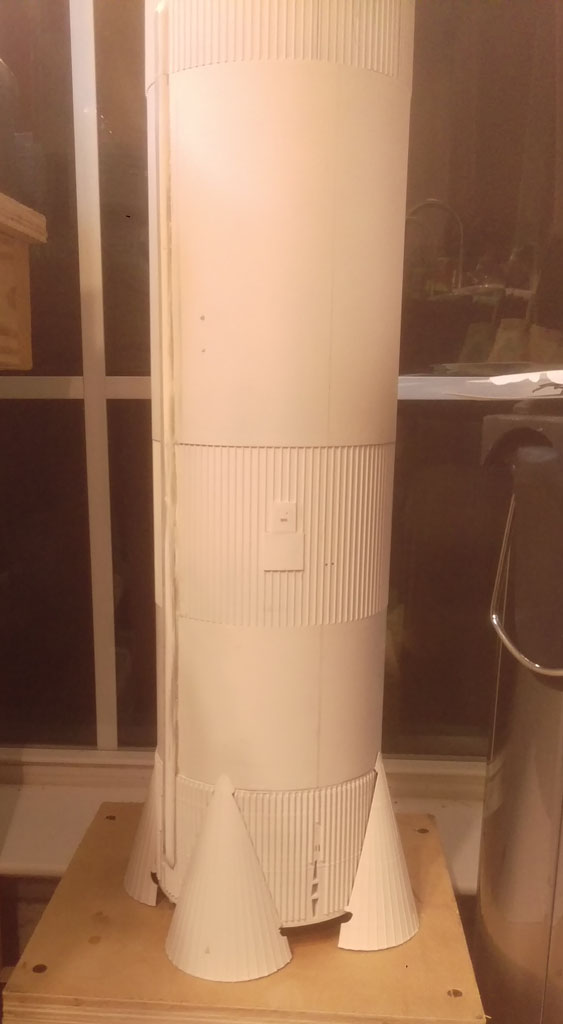

niart17 Posted March 27, 2018 Author Share Posted March 27, 2018 And the second stage. This is probably the furthest along section. I started with this section since it has a lot of details that aren't too complicated to detail. Plus I liked the discolored pattern that seems to be more prevalent on the mission I'm trying to represent (Apollo 12) then some of the others. I know that's likely just because of the photographs taken of that specific mission but maybe it was actually slightly different. Quote Link to post Share on other sites
K2Pete Posted March 27, 2018 Share Posted March 27, 2018 Is this kit pre-built and pre-painted, Bill? If not, you did a nice job on those stringers at the top o' the 2nd stage! You've got till July next year .......... I'll be watching' ! Pete Quote Link to post Share on other sites
niart17 Posted March 27, 2018 Author Share Posted March 27, 2018 Hey Pete, I hope to make the July build deadline...but....well.....no need to rehash the obvious. No, this isn't the pre-built pre-painted it's the actual kit. Thanks for the compliment but the painting looks MUCH better in the pics than in real life. There's some areas of overspray I need to re-touch up. Also, I don't know if you can tell, but I've sanded down those pipe fairings and need to smooth all that back in. They are rough resin cast copies of a scratch part I made years ago. I felt that the kit's fairings were shaped too pointy on the ends and stood slightly too proud. I also cut down the height and sanded the top edge flat of the channels running up the sides of the first stage. They stuck out WAY too much and didn't have a flattened shape like the real ones. I tried to modify what the kit had instead of trying to scratch something. I'll likely go back and add the small stringer details that run the length of them. So yeah, a WAYS to go. Bill Quote Link to post Share on other sites

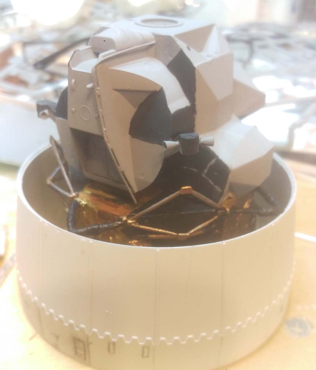

niart17 Posted March 31, 2018 Author Share Posted March 31, 2018 I've done a little more to the LM, instrument ring and the LM adaptor. I just some Werther's Original candy wrappers for the LM foil areas that will be seen just painted gold the lower areas that are out of view. I also used regular tin foil for the leg fronts. I'll have to go back and paint the gold straps since I don't think I could get the candy wrappers to cooperate. The color of the Werther's is just about right, but unfortunately they put their name on the wrappers covering a good portion of them so I don't think they'd be good for big areas on a larger LM. Quote Link to post Share on other sites

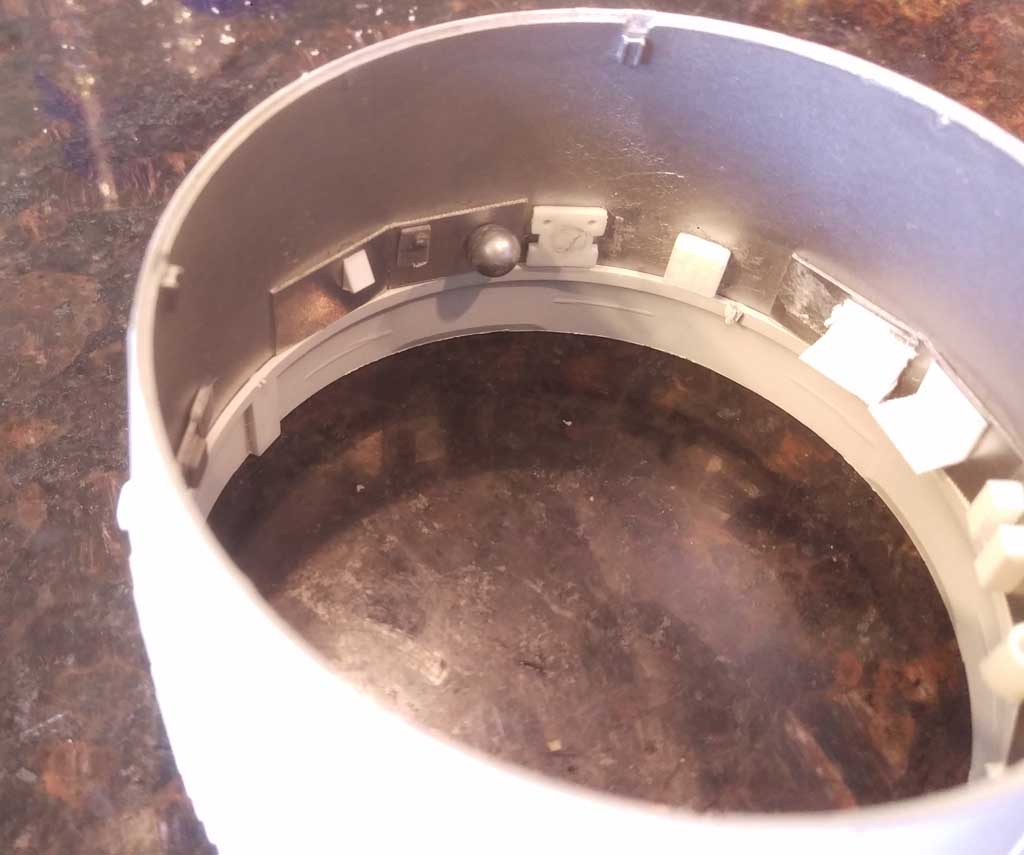

niart17 Posted March 31, 2018 Author Share Posted March 31, 2018 The instrument ring interior. I'll put a few more boxes and a little wiring here and there but not go all out since most of this can't be seen with the lunar module in place. Quote Link to post Share on other sites

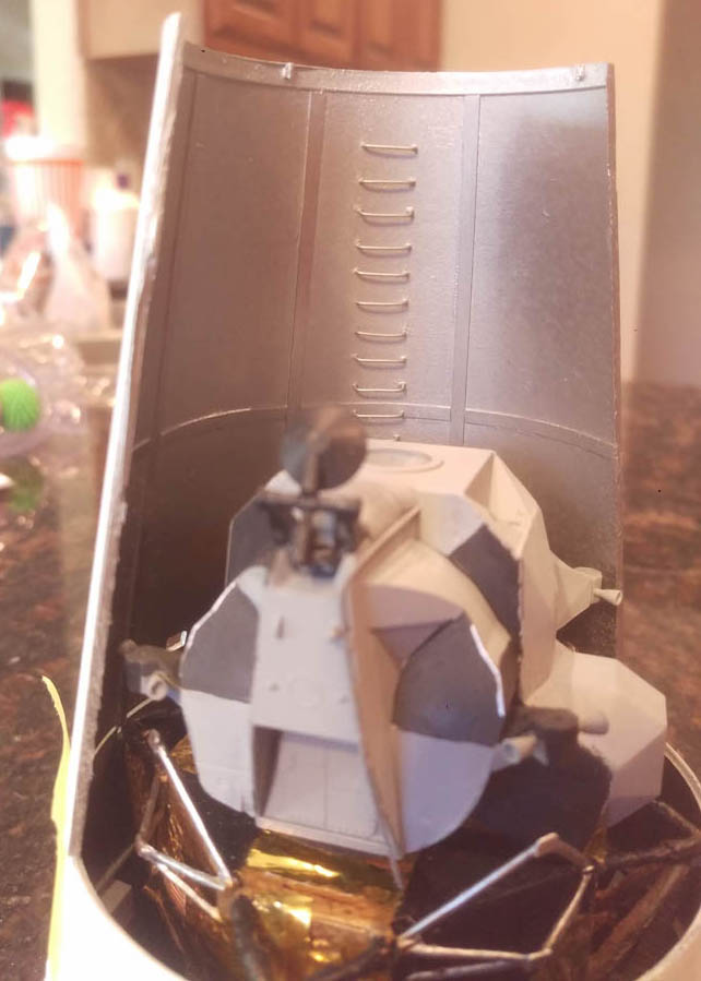

niart17 Posted March 31, 2018 Author Share Posted March 31, 2018 (edited) And the inside of the LM adaptor panels. Just added some simple ribbing, a representation of the access hatch and the latter rungs out of brass wire. Again not going overboard but will still add a bit more details as these panels will be seen a little more. My plan is to display two of the panels open similar to what K2Pete did on his 1/48 CSM/LM stack build. Edited March 31, 2018 by niart17 Quote Link to post Share on other sites
K2Pete Posted March 31, 2018 Share Posted March 31, 2018 Lookin' good Bill! I've found that adding some little greeblies, details that may not exist but dress up blank areas ( like the inside of the SLA panels ) really adds to the believability of the ( perceived ) accuracy of the model. And it'll add greatly to the overall look of the Saturn V. Especially in 1/72! ... well, I'll be darned, I wondered what that "Photobucket 3rd party" notice was ... it's the old NASA build banner ... ah-h-h good times! Happy Easter Bill! Pete Quote Link to post Share on other sites
habu2 Posted March 31, 2018 Share Posted March 31, 2018 48 minutes ago, niart17 said: I'll have to go back and paint the gold straps since I don't think I could get the candy wrappers to cooperate. I used an orange-ish fine-tipped Sharpie to make the gold straps on the aluminum foil wrapped legs of my LM, it looked more gold colored in top of the silver foil. Quote Link to post Share on other sites
niart17 Posted March 31, 2018 Author Share Posted March 31, 2018 46 minutes ago, K2Pete said: Lookin' good Bill! I've found that adding some little greeblies, details that may not exist but dress up blank areas ( like the inside of the SLA panels ) really adds to the believability of the ( perceived ) accuracy of the model. And it'll add greatly to the overall look of the Saturn V. Especially in 1/72! ... well, I'll be darned, I wondered what that "Photobucket 3rd party" notice was ... it's the old NASA build banner ... ah-h-h good times! Happy Easter Bill! Pete Happy Easter to you as well Pete! Yeah, it kind of threw me off once that banner showed up again. I was getting hopeful that maybe PB reversed their policy and started letting images show up again but alas, my other old images are still blocked. Not sure why the banner shows up other than maybe they realized that having that notice show up on the bottom of so many people's posts is bad advertising so they released those images? Seems like a long shot but otherwise can't explain how that shows but nothing else. Bill Quote Link to post Share on other sites
niart17 Posted March 31, 2018 Author Share Posted March 31, 2018 50 minutes ago, habu2 said: I used an orange-ish fine-tipped Sharpie to make the gold straps on the aluminum foil wrapped legs of my LM, it looked more gold colored in top of the silver foil. Great tip! I'll have to see if I can find one that color. Thanks! Bill Quote Link to post Share on other sites
