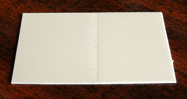

RichardL Posted April 11, 2018 Author Share Posted April 11, 2018 1 hour ago, Janissary said: What would be super interesting is the following: Now that you have these, perhaps airbrush a thick coat of clear gloss on each of them (maybe several layers), then apply dullcoat. Will do it on a different batch. I suppose I can apply gloss clear and dullcoat on just one color to check. Any preference on what gloss clear and flat clear to use? I think I have every single one of them. Quote Link to post Share on other sites
Janissary Posted April 11, 2018 Share Posted April 11, 2018 (edited) I would use Future, but any gloss coat would do. I'd only insist to get the surface as glossy/deep as possible. Then, I think Testors dull coat might be a good one to dull it down. It would be super informative if you could split your existing coupon into left-right halves by masking one side and applying the gloss/dull coats to the other only. That would enable both a relative (left versus right) and an absolute comparison (against the standard chip) all at the same time. Since the MM enamel was the winner, I would go with that one for the gloss test :) Edited April 11, 2018 by Janissary Quote Link to post Share on other sites

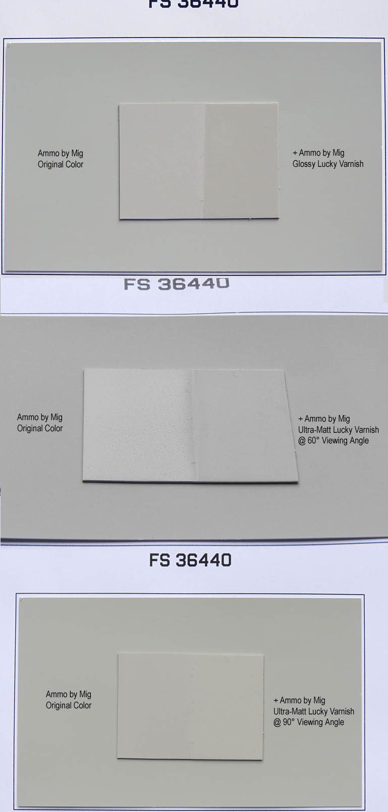

RichardL Posted April 29, 2018 Author Share Posted April 29, 2018 On 4/11/2018 at 8:06 AM, Janissary said: What would be super interesting is the following: Now that you have these, perhaps airbrush a thick coat of clear gloss on each of them (maybe several layers), then apply dullcoat. I am curious how much of a shift in the hue we would get, if any. I could try this myself (without the benchmark standard chip) but I am shamefully lazy. I decided to do a test on acrylics first by spraying six coats of AMMO of Mig Glossy Lucky Varnish on AMMO of Mig FS36440, followed by two medium coats of AMMO of Mig Ultra-Matte Lucky Varnish. The gloss coats did indeed darken the original color. However, the flattening agent in the Ultra-Matte Lucky Varnish lightened the color back to the original color when viewed perpendicular to the surface. When viewed at an angle, the coated color is slightly darker than the original color. However, in this case, the coated color matches better to the color chip. See picture below: I will repeat the experiment with Model Master enamel plus Model Master lacquer clear coats. Quote Link to post Share on other sites
RichardL Posted April 29, 2018 Author Share Posted April 29, 2018 On 4/11/2018 at 12:53 PM, Janissary said: My 'hope' is that the gloss coat experiment will result in a major shift in the tone. It turns out numerous gloss coats and flat coats did not drastically alter the tone of the original color (at least for acrylics), as the picture below shows. This picture was taken at 45-degree viewing angle. Left half is the original color. Right half has eight coats of gloss and flat clear on top of the original color. Quote Link to post Share on other sites
