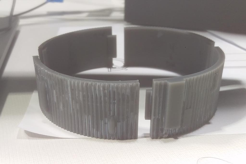

niart17 Posted October 23, 2018 Author Share Posted October 23, 2018 Well, the weather has been cooling so I started printing operations again. After a little tweaing with the settings, I was able to get some good prints for some Saturn V parts. These are the instrument ring and intertank areas of the upper stage. I like the grey resin but it does take quite a bit longer to print. There is also a VERY slight deformation along the top edge that should be fine once it's glued together and filled in. but if this were something needing to be more precise this might be an issue. I'll look at the files and see if I can figure out what cause the difference. The upper instrument ring and inter tank: Quote Link to post Share on other sites

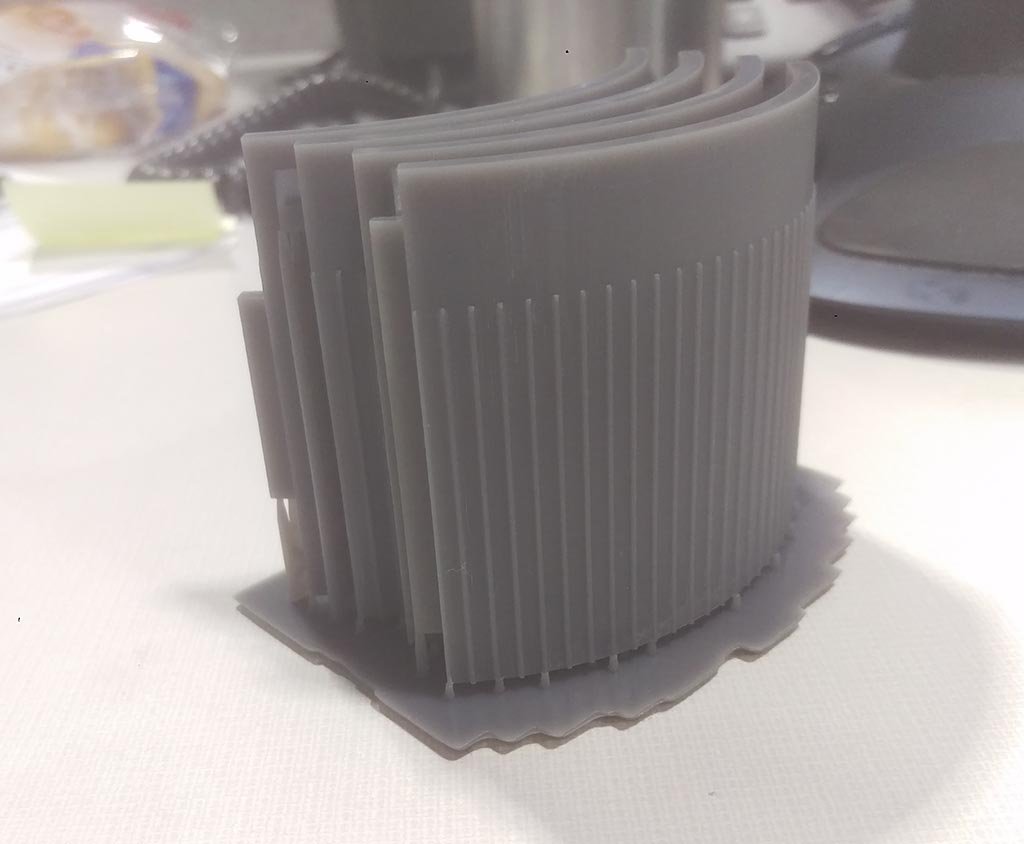

niart17 Posted October 23, 2018 Author Share Posted October 23, 2018 (edited) The lower stringer sections. You can see at the top of this seam the slight gap. Its not glued so it may actually totally go away with some glue. We'll see Also, not sure what the white residue is from. It didn't show up on the other print of the instrument ring and I don't think it will be an issue after priming, but I do want to be careful and make sure it's nothing to worry about. Edited October 23, 2018 by niart17 Quote Link to post Share on other sites

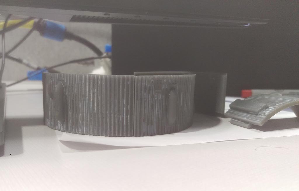

niart17 Posted October 23, 2018 Author Share Posted October 23, 2018 Here are all 4 pieces of the lower section so you can see how they will be fit together. That's only downfall of this size printer. Anything this large has to be cut into sections. Not a horrible thing but it does add to the potential for errors and flaws. But still think it's worth it not having to post-print sand so much like with a larger FDM printer with it's build lines. Just my opinion. Quote Link to post Share on other sites
dnl42 Posted October 23, 2018 Share Posted October 23, 2018 Most excellent! This is a significant improvement in capabilities. Quote Link to post Share on other sites

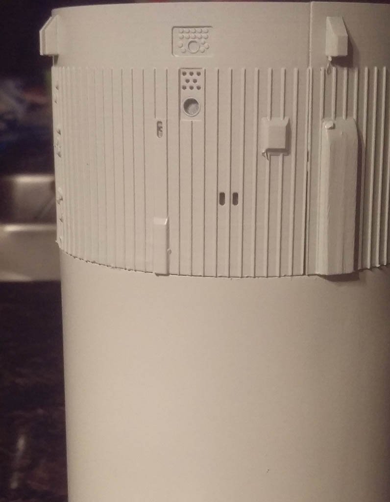

niart17 Posted October 26, 2018 Author Share Posted October 26, 2018 Here is a shot of some of the details that printed pretty well. This has been lightly primed with Tamiya rattle can off-white. I did make these parts quite a bit thicker than they needed to be but I knew there was going to be coaxing to get them to fit into a good cylinder and match the tube from the kit which isn't perfectly round. I had sand down one part quite a bit to lower the overall diameter to fit. Still have some filling and clean-up and sanding but overall happy with how it's coming out. Quote Link to post Share on other sites
crackerjazz Posted October 27, 2018 Share Posted October 27, 2018 I can only drool : ) It looks fantastic, Bill! I tried to zoom into the photos and the prints look amazingly smooth and just so much better than those stepped Shapeways parts. Quote Link to post Share on other sites
