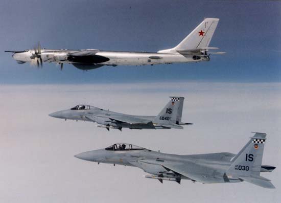

salvine Posted May 5, 2018 Share Posted May 5, 2018 This may be old news but was just watching and old documentary called Arctic Warriors on you tube and saw that F-15C's were equipped with CFT's. Had never seen that before. Makes sense due to the huge distances that could be involved. Quote Link to post Share on other sites
Trigger Posted May 5, 2018 Share Posted May 5, 2018 F-15Cs in Iceland used them too for the same reason. Quote Link to post Share on other sites
