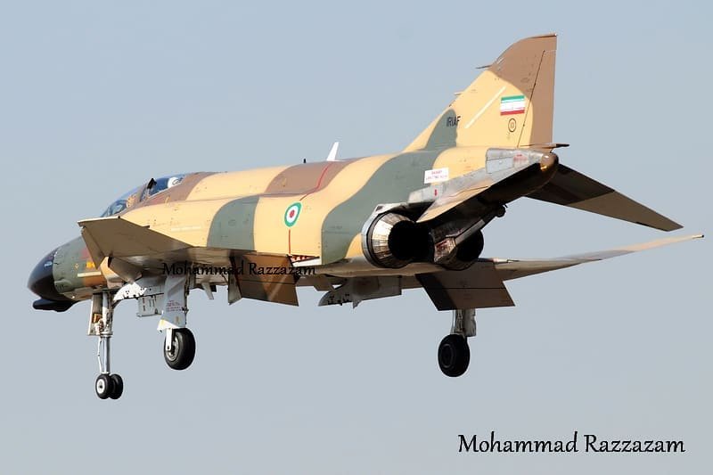

Just looking closer at pictures I found of the F-4D that caught my attention, I discovered they had slatted wings. How very rare! Very interesting also.
Never seen this before. anyone having a clue on this particular version?

Hi Robert,
It looks like the 48ers has the scoops and stabs in stock. The ACS scoops are HSM HMR 48011 and the stabilators are HSM HMR 48012. The stabs will fit both Academy and Hasegawa F-4s. Royale Resin’s are R051 and appear to be in stock, too.
I don’t think any F-4C/D was ever fitted with slats. Was it a local IIAF mod?

This quote comes from F-4.nl:" With the overthrow of the Shah in 1979 by the Islamic fundamentalist revolution, the shipment of spare parts for Iranian Phantoms was embargoed, and many planes had to be cannibalized to keep others flying".

So I guess modification by Iranians. Very interesting. Seen some other pictures too with slatted F-4Ds. Also the white antenna on the fuselage is very interesting. No registration number on the vertical stabilator, replaced by IRIAF. Experimental Airframe? I guess so.

Hi Robert,
Interesting! All I can find on Google are F-4Es with slats and TISEO. All of the Ds I'm finding have the original leading edge flaps. Do you have a link to any photos of slatted Ds? It might be fun to poke the folks on the F-4 Google group with a little trivia. 😈

Here we go:
The above F-4D is such a beauty, worth building in 1/32 or 1/48. I love those subjects.
Same airframe, look how clean she looks even after so many years in service. With slatted wings.
For the last picture, just watch the white antenna. This airframe is, I think a total new F-4D concept from the eighties and captured flying, i think in 2005 over Teheran. Bro Numbers are not visible anymore. From the other pictures you can see they are still there, Left hand side is English, right hand side Persian. Registration of the airframes had a 3 time revision over the years. Found the link to figure that out, but lost it  for the time being. Will have to search in my memory for that. Now I also need to learn Persian, because a neat site did pop this afternoon from Iran. see if my contact in Holland is still there, LOL.

Hello,
sorry for "killing" your dreams, but this is a regular F-4D with the so called "hard-wing"!
The hard wing has trailing edge and leading edge flaps as seen on the pics you posted.
You can find the slated wing on the F-4E/F/G and in a slightly different version on the F-4S. There also were a few late RF-4E's with slated wings.
Very early F-4E's (and the Japanese F-4E's...) still had the leading edge flaps.
This is just the short explanation of the F-4 "wing-story".....

Yep, those are LE Flaps, not Slats.
Those pics also show why I and some others call the "inner flaps" out differently than younger modelers do. In our time, there were "inner, center, and outer" LE Flaps,,,,and in later years, the younger guys just call them inner and outer, because in their time, the old center flap became the inner, to them. (mostly a Navair thing, I guess)
I think it is safe to say that ALL Phantoms had movable surfaces on the leading edge the wings, some had LE Flaps, and some had LE Slats,,,,,,,,I don't know of any that had a true Hard LE on it's wings. (I'd love to see one and built it, though, if some test bird had nothing moving there)

Jens beat me to it! 😄  Leading edge "slats" vs "flaps" often causes confusion, since the two terms are not interchangeable. Here are a couple of great videos that show the difference between leading edge slat and leading edge flap operation:
F-4 leading edge slat operation
F-4 leading edge flap operation (3:40 - 3:50)

Well it is not killing my dream LOL. I just saw this for the first time. Never knew a 'hard wing design' had a moveable leading edge.
What I can think of it must have a speed reducing function or is there a better explanation?
Kind regards,
Robert Jan
Hi Robert,
The original design was to reduce approach speed for carrier operations. The hard wing jets had a Boundary Layer Control System that blew bleed air from the engines through slots that were exposed when the leading and trailing edge flaps were lowered. This kept the boundary layer "stuck" to the wings longer and further reduced approach speeds. In the video of the F-4D I linked above, you can see one of the ground crewmen running his hand over the break between the LE flaps and the wing to check that the BLCS was blowing air. The F-104 Starfighter had a similar system.
The conversion to leading edge slats was done to increase maneuverability. They accepted a slight increase in approach speed for better maneuverability. The BLCS was deleted in slatted jets. For takeoff and landing, the slats would extend when the trailing edge flaps were lowered, just like you see on an airliner. With the flaps up, the slats would cycle automatically, based on the jet's angle of attack.
Cheers!
Ben
