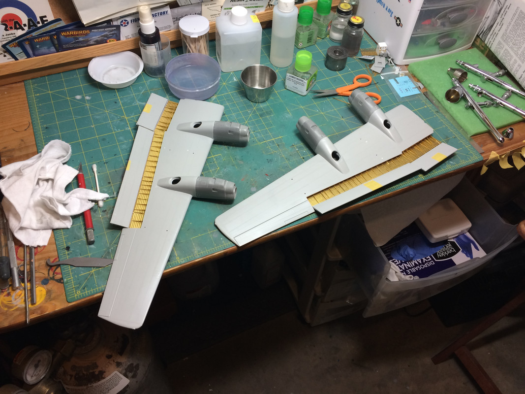

82Whitey51 Posted October 4, 2018 Author Share Posted October 4, 2018 A little update to this. I've been steadily working on this, just nothing exciting to post the last few weeks...filling seams, sanding seems, filling seems, sanding seems, filling...you get the idea. My approach on a big project like this is to build it in "sections". I first wanted the fuselage done, then the tail and stabs done, then the wings & nacelles done. On the nacelles, the fit of the Attack Squadron nacelles is fantastic! Pretty much removed the pour stubs, and they go together with minimal clean up. The joint to the kit wings was equally nice. I used the Flightpath flaps...that's a lot of p/e! With it being from the early era of p/e, the stuff is stiff and the "gates" were THICK! I had to use my Dremel and cutting wheel to remove many of the parts, as well as using it for cleaning up the parts. But once they are all together, they look pretty nice. Which leads me to the next step in the process, gluing the completed wing assemblies to the fuselage!! I attached the starboard side wing first and let it cure for 24 hours, then attached the port wing just last night (right before watching the Boston Bruins get their butts whooped in the season opener... 😞 ). Soon, it'll be on to painting. You'll notice I moved an extra folding table into my already tight work space to use for the remainder of the build. Quote Link to post Share on other sites

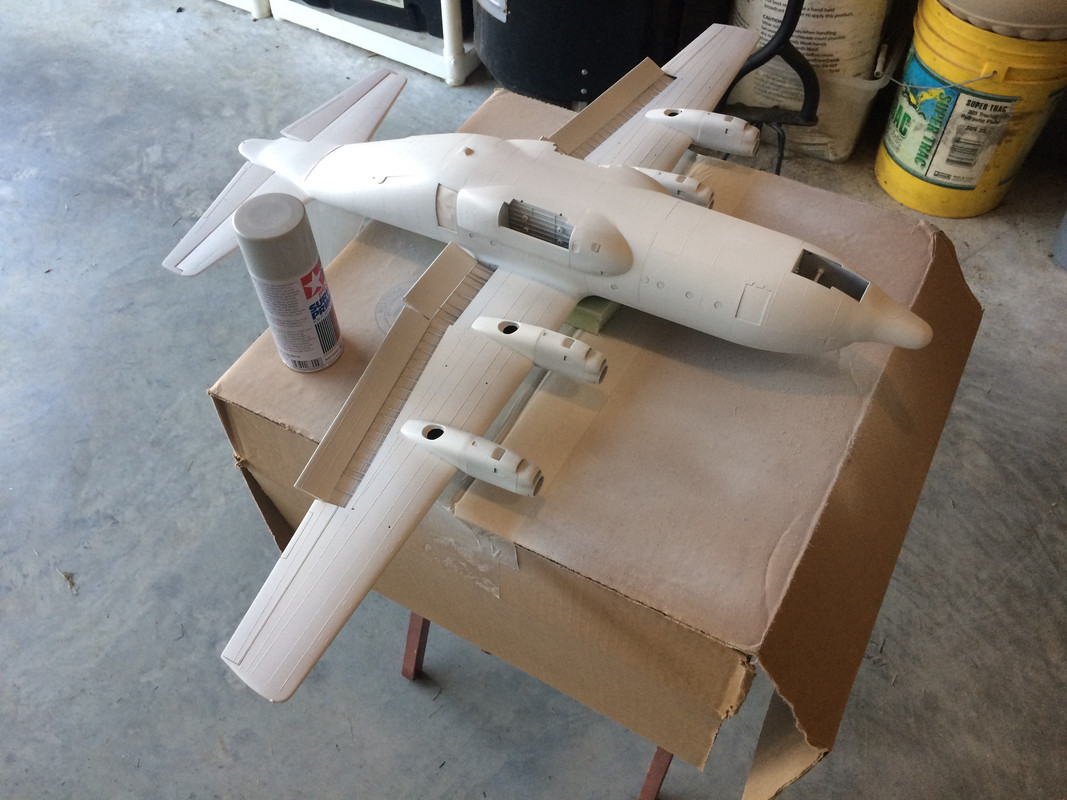

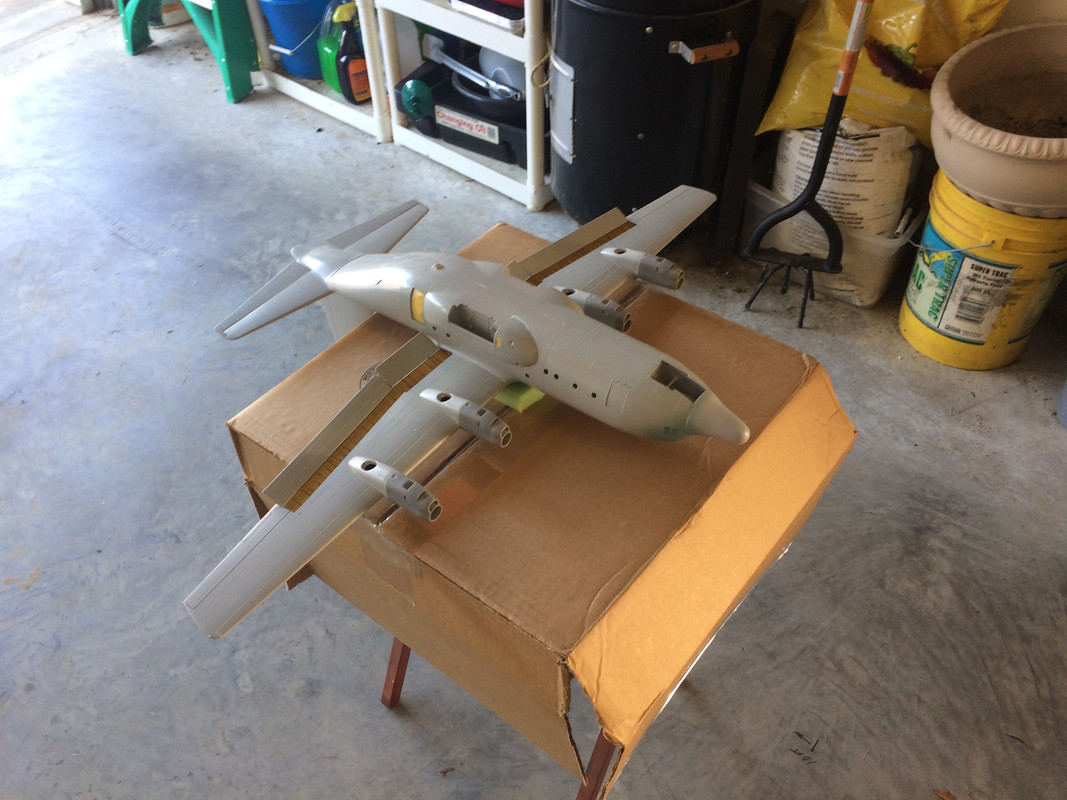

82Whitey51 Posted October 8, 2018 Author Share Posted October 8, 2018 A little progress... Got her all masked up and prepped for painting. Weather is still nice, cooling down some even, perfect day to take her out to the garage and shoot a coat of primer on her! I used Tamiya fine White primer, the majority of the wings and nacelles will be yellow, and the giant tail red/orange, so white makes a great base coat. Not to mention that the top of the fuselage will be gloss white also. Quote Link to post Share on other sites

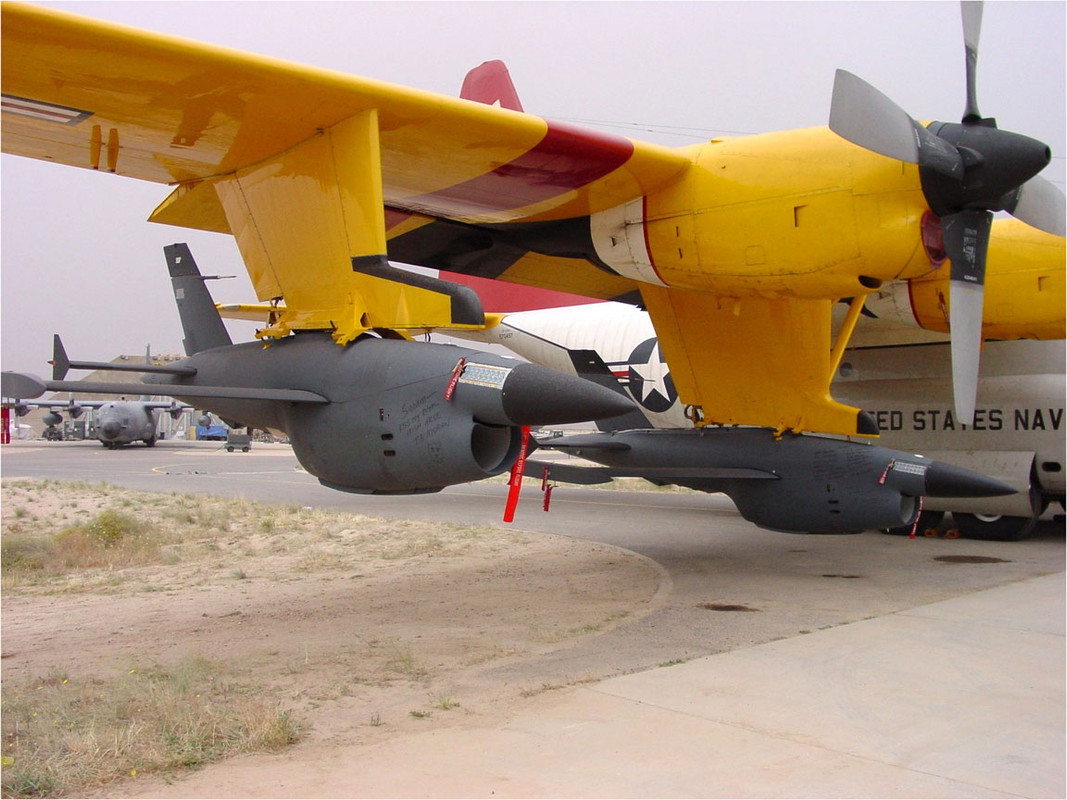

82Whitey51 Posted February 18, 2019 Author Share Posted February 18, 2019 Finally some progress! This paint job has been a chore of masking and a solid arm workout. As God is my witness I will NEVER pre-shade any area that is to be painted yellow...it took 3 bottles of Mr. Color Insignia Yellow to cover until I finally decided enough was enough and I'd just weather it a bit more than I previously had planned. It'll represent the aircraft as it appeared operating out of Kuwait in 2003 so it likely was dingy enough. Next, on to the tail and upper walkway areas. Quote Link to post Share on other sites
