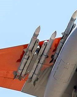

which pylons/adapters for the outboard LAU-128 (aim-120 amraam) launchers?
Edited by Alpagueur
Reviving an old thready here, They look similar to the LAU-115 used on Navy Hornets. These would be attached to the unique outboard F-15 pylon, and there are probably some differences to the Navy LAU-115. Any differences will be pretty well hidden between the LAU-128s and missiles though.

That is true for the inboard pylons, but the dual LAU-128 mount on the outboard pylons don't look like an ADU-552.
Alpagueur was asking about these:
Oh, those...sorry.
exactly Hoops, they seem different from ADU-552.
I think it looks similar to a LAU-115 sandwiched between two LAU-128s. It's probably not exactly the same thing, but it sure looks close.

Hoops, when can we find some drawings of the outboard pylons? Is there any kit in 1/48 scale out there which include them?

maybe the Academy are more accurate....Tamiya ones seem one single piece with the missile.
Which missiles are cleared for the outboard wing pylons?
The Revell kit also has the outboard pylon with the original ALQ pod. I believe the Hasegawa F-15E has outboard pylons too - they ended up on my build anyway. It was originally tested with the AIM-120 and the AGM-88. But, the new pylon may be different. It has been depicted with AIM-120s or AIM-9s.

I'm sure y'all already know this but the original F-15A had provisions for the outer wing pylons. They were to be used for ECM pods, that's why you see the very early F-15 kits with those pods and outer wing pylons. however it was determined that they could put the same ECM gear inside the aircraft  and not have to use the pod. So it seems like the wing always had the structural provisions for the pods and now these later versions have the wiring to hang missiles on them.
Actually the reason the outerpylon was not used was it caused control problems with controlled flight.  Yes,  they were able to put the equipment inside of the airframe,  but it was not the reason for their lack of use.   Going to a “ fly by wire” controls on the SA allowed for these pylons to be used as the flight computers allow for the instability the pylons cause.
