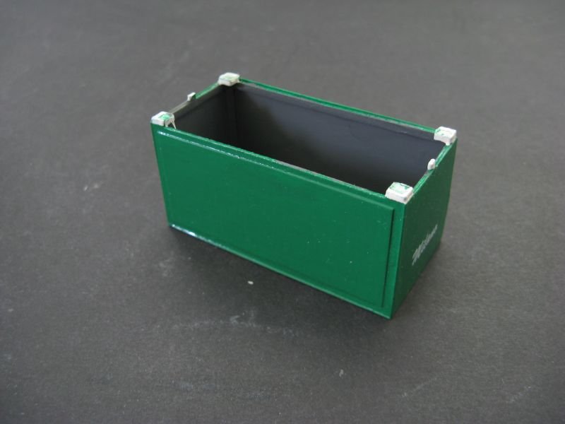

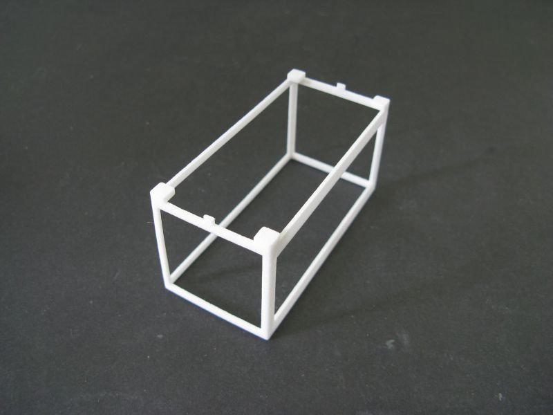

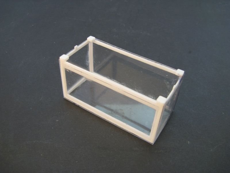

Lupusprimus Posted December 31, 2018 Author Share Posted December 31, 2018 Besides, there are always some parts that are used later on in the Forestale Skycrane. Here is the big tool box between cabin and water tank. I drew a scaffold and had it printed. This is covered all around with matching pieces of foil. Then cut off the overhangs. Quote Link to post Share on other sites

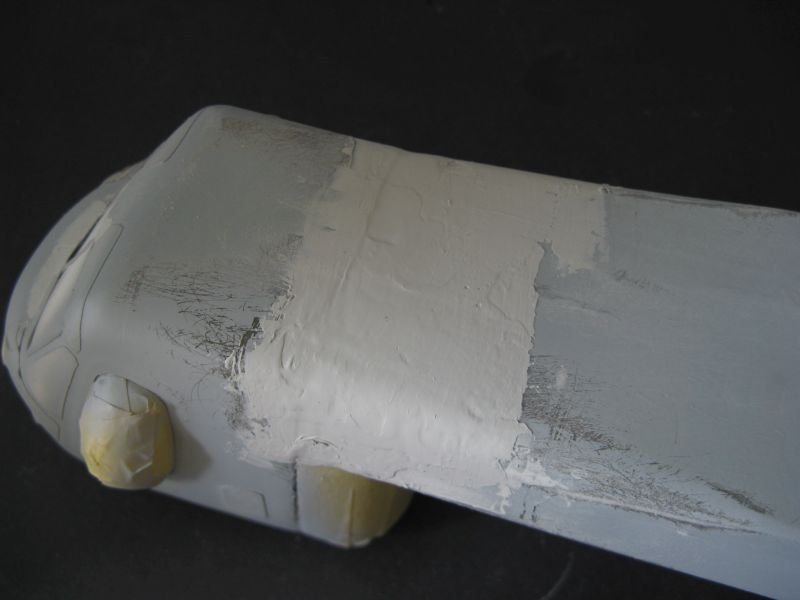

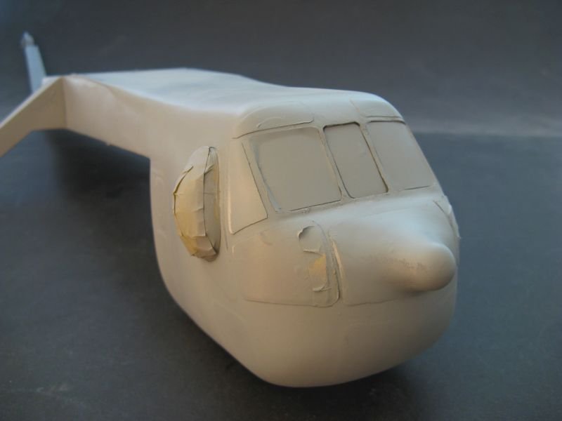

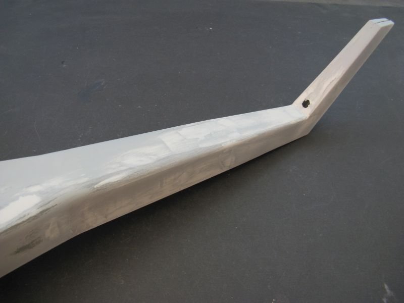

Lupusprimus Posted January 2, 2019 Author Share Posted January 2, 2019 Now the phase of filling and sanding begins. I use Spantan-A nitro filler from Bindulin. The transition from pulpit to main trunk is generously filled. Unevenness is also levelled out at other points. Quote Link to post Share on other sites

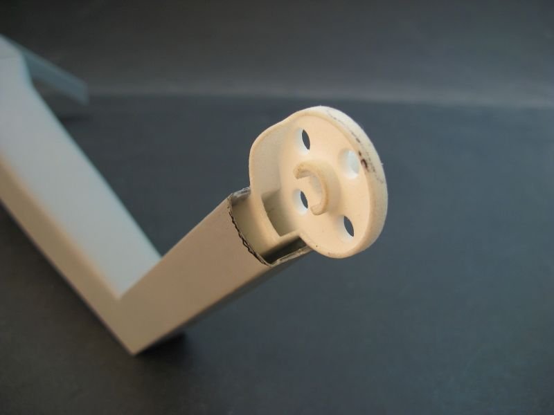

Lupusprimus Posted January 3, 2019 Author Share Posted January 3, 2019 This engine mount is specially designed for the Turnigy 2211. I glue foil pieces on the sides until it fits neatly into the tail. Adjust until it fits well, especially on the sides. Then first fix it in place with UHU Allplast, then glue it in place with superglue after alignment. That's what it looks like up close. The holder has an opening for the cables to pass through. Quote Link to post Share on other sites
Lupusprimus Posted January 4, 2019 Author Share Posted January 4, 2019 (edited) The engine is put into the holder, the tail rotor is fastened. Then check the angle, correct if necessary. Edited January 4, 2019 by Lupusprimus Quote Link to post Share on other sites

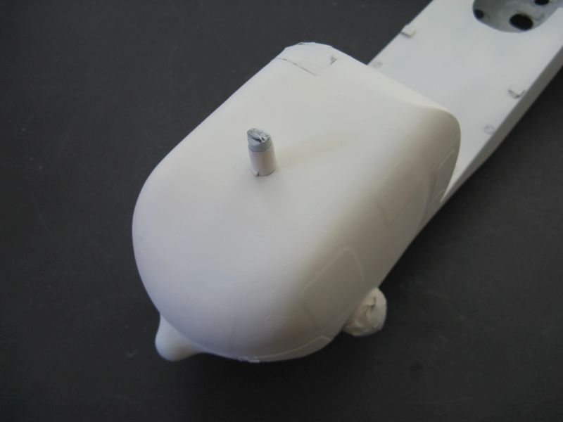

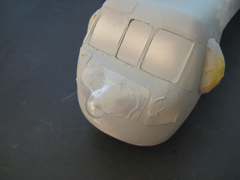

Lupusprimus Posted January 5, 2019 Author Share Posted January 5, 2019 The Forestale version has a knob (radar?) at the front. It is available as a foil part. Cut it out, adjust it, glue it on. The details are completed with a spatula. That's what it looks like in the end. Rest makes color. Quote Link to post Share on other sites
Lupusprimus Posted January 6, 2019 Author Share Posted January 6, 2019 The last small places are repaired. And finely ground. Finally the whole fuselage is sprayed again with the light grey. It now weighs 110 g. Quote Link to post Share on other sites

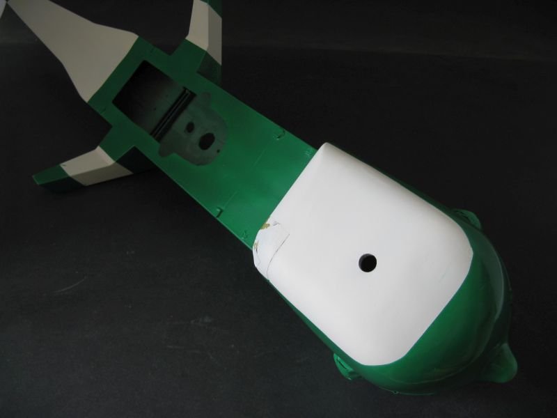

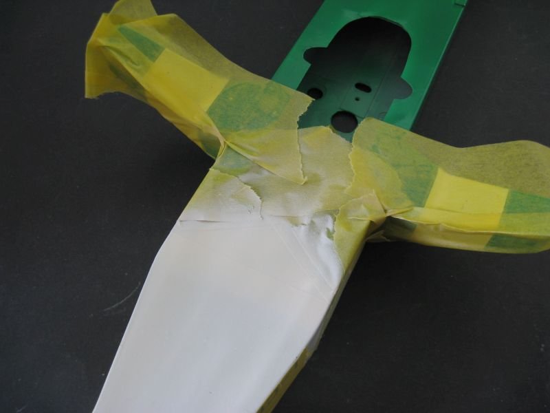

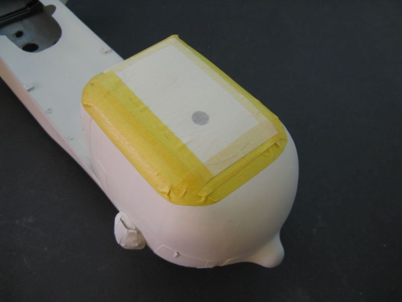

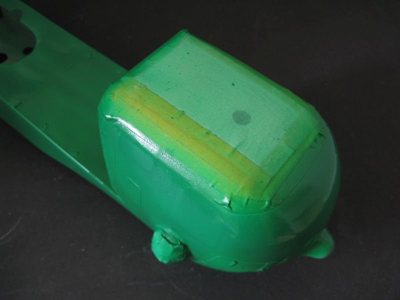

Lupusprimus Posted January 8, 2019 Author Share Posted January 8, 2019 The large white areas on the rear tail are masked. At the edge with masking tape from Tamiya, in the area with painter's masking tape. Only Tamiya masking tape is used on the outriggers. Here you have to pay attention to the vertical surfaces. The underside of the pulpit also remains white. Here you have to look carefully from several sides when masking. Quote Link to post Share on other sites
Lupusprimus Posted January 9, 2019 Author Share Posted January 9, 2019 Now they're spraying green. This must be pasted several times in thin layers until the paint covers everything. Here you can still see how differently the colour covers. Quote Link to post Share on other sites

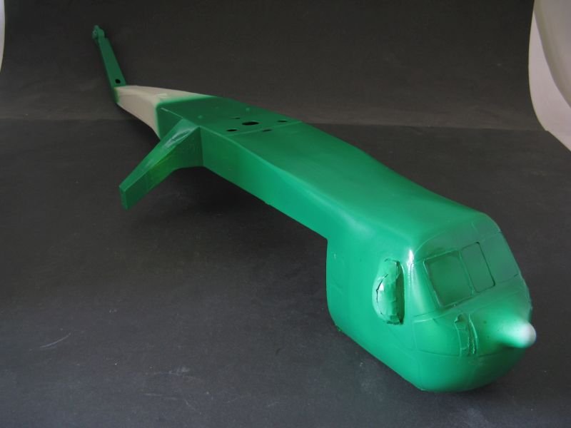

Lupusprimus Posted January 10, 2019 Author Share Posted January 10, 2019 After several injections the green covers. The masks are removed. Only small imperfections are visible. In front the rounding must be reworked with the brush and thinner color a little bit. Quote Link to post Share on other sites

Lupusprimus Posted January 11, 2019 Author Share Posted January 11, 2019 I also wanted to build 1:35 first. But the fuselage was too small for the adapted mechanics of the Blade 230S. My fuselage is now 64 mm wide, the used main gear has 60 mm! The original 230S has 70 mm. Only later did I notice that the transition of the colours above and below is not straight, but angular. So mask again and inject the corners again. Also the green angle is sprayed again and then the defects are removed. Quote Link to post Share on other sites

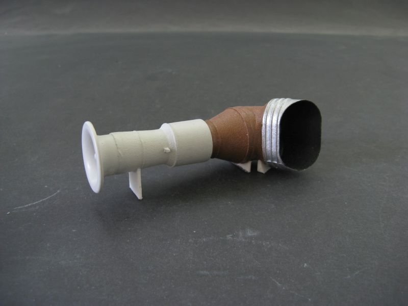

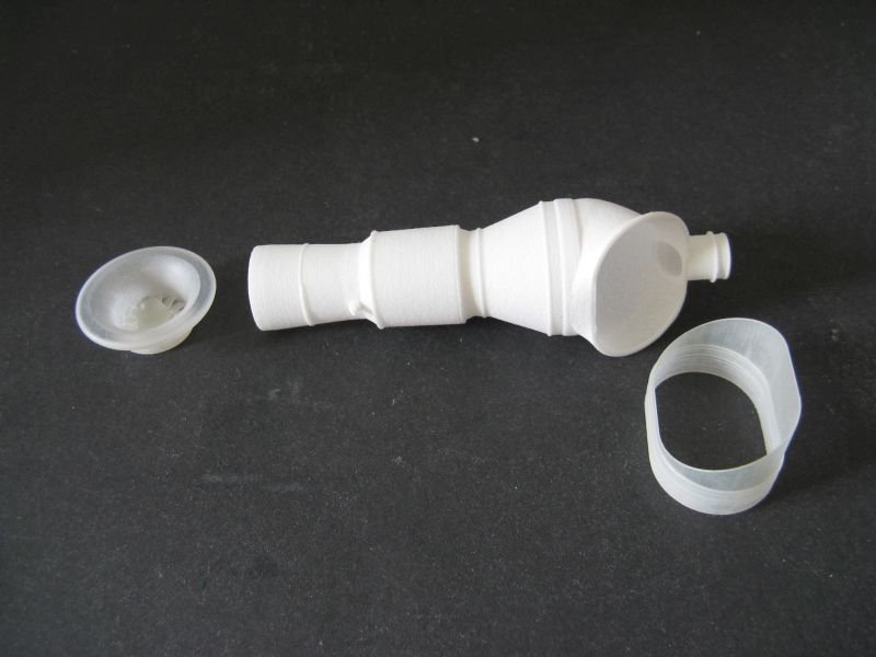

Lupusprimus Posted January 12, 2019 Author Share Posted January 12, 2019 During the breaks, the add-on parts are also completed and painted one after the other. The engine consists of three larger parts. The middle one is printed "polished", the other two "smoothed". You could also print the middle part "smoothed", but that costs almost three times as much. The parts are glued with superglue. Then colour comes along, as it looks in nature. The (3D printed) editions are glued to the engine. They secure the correct position on the fuselage. The exhaust pipe must be slightly inclined. Quote Link to post Share on other sites

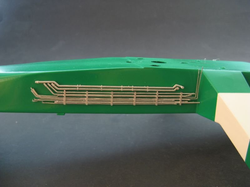

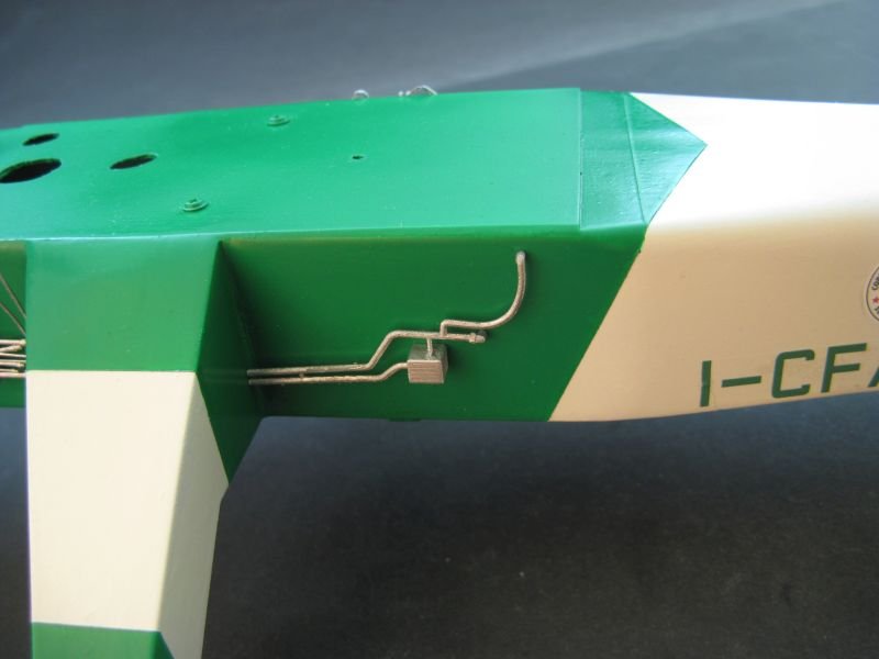

Lupusprimus Posted January 13, 2019 Author Share Posted January 13, 2019 The first lines are glued on. Here on the left. Back left. Quote Link to post Share on other sites
midnightprowler Posted January 13, 2019 Share Posted January 13, 2019 What are you using to make the plumbing? Quote Link to post Share on other sites
