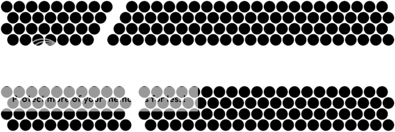

GW8345 Posted November 16, 2018 28 minutes ago, andrew.deboer said: OK, this thread and that link are the frickin’ jackpot. Can’t wait to try scratching an adapter and a BRU-10 to go in a Tamiya Phoenix adapter, and an ECA. Definitely will be creating a decal to represent the chaff and flare cartridges - because they’re loaded, and because I’m not drilling 140 holes! Make sure you check out this link, it shows you the hole pattern for the ECA Bucket (3 rows of 40 holes for a total of 120). The bucket was one piece but was set up in two sections, an aft section that with 30 holes and a forward section with 90 holes. https://www.google.com/imgres?imgurl=https%3A%2F%2Fpbs.twimg.com%2Fmedia%2FCuP-BjDXEAAoVT9.jpg&imgrefurl=https%3A%2F%2Ftwitter.com%2Fberk_kp&docid=hQEmvqTgsP62oM&tbnid=YkWpVvInrxKXJM%3A&vet=10ahUKEwjb7LvWr9XeAhXks1kKHZkQDfMQMwhDKAEwAQ..i&w=579&h=584&bih=720&biw=1224&q=AN%2FALE-37&ved=0ahUKEwjb7LvWr9XeAhXks1kKHZkQDfMQMwhDKAEwAQ&iact=mrc&uact=8 Quote Share this post Link to post Share on other sites
andrew.deboer Posted November 16, 2018 (edited) Looks like there may be more than one hole pattern for the bucket. The photo below has a staggered pattern, where one set of holes is 88 and the other is 32. So I presume the ECA bucket had a slightly different layout. Below is the 32 / 88 layout, and below that is the 40 / 80. Edited November 16, 2018 by andrew.deboer Quote Share this post Link to post Share on other sites
GW8345 Posted November 16, 2018 3 hours ago, andrew.deboer said: Looks like there may be more than one hole pattern for the bucket. The photo below has a staggered pattern, where one set of holes is 88 and the other is 32. So I presume the ECA bucket had a slightly different layout. Below is the 32 / 88 layout, and below that is the 40 / 80. Go with the 88/32 set up, that's what I remember now that I'm looking at it. The more I think about this the more I am starting to remember, haven't had to think this hard about the ECA since 92. Good catch on the hole pattern and for keeping me honest. BTW, the pod below it looks like an AN/ALE-41 pod, we flew both type when I was in A-7's, hated those damn thing! Quote Share this post Link to post Share on other sites
