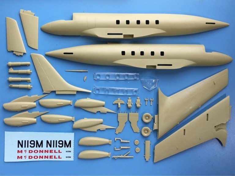

Here is Anigrand's parts breakdown:
Right away I was both pleased and dismayed.  The pax windows look great!  Seem to be a very close match.   Tailcone....hard to tell.  However, the wing saddle is way off.  The real plane has a subtle wing saddle/box that although does bulge out some, it is not the Brobdingnagian monstrosity seen here.  However, if all the resin in there is solid, working carefully with a Dremel® tool will make short work of it...as long as I work slowly and carefully and keep comparing to photos and drawings.
Looking at the landing gear, I have to say they are excellent castings.  The pilots' seats and instrument panel are quite accurate to the real machine.
As for the engine pods, they appear too bulged at the bottom and I might elect to leave them or carve them straighter.  The wings appear to be solid pieces of resin which can be good or bad but it adds weight on the gear and a solid piece is likely to warp over time.  I might consider drilling long holes in them and putting in steel wires.
Finally, the nosecone.  It's wrong, wrong, wrong.  The real aircraft, of which there's only one, is pointed.  Very pointed.  Pointy, point, point pointed.   After taking measurements of the model and profiles of the real aircraft, I will decide what to do with it.  Looks like "Bondo® to the rescue!" as on the Jetstar.  Note that I haven't bought this kit yet.  It's $98 US plus $16 shipping and if it appears on eBay, it will likely be cheaper.

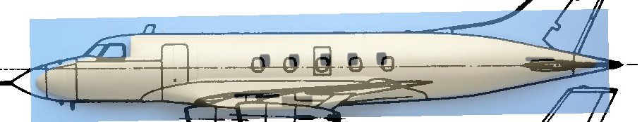

It appears that the fuselage is too short, windows not properly stationed, tailcone needs extending, nose cut and a plug inserted to make the cockpit properly placed and Bondo used to reshape the nosecone.
48474298_mcdonnell_119anigrand_techdrawingcompare.jpg.d9b20f22b158ca6b06a2a3eaf06cc252.jpg

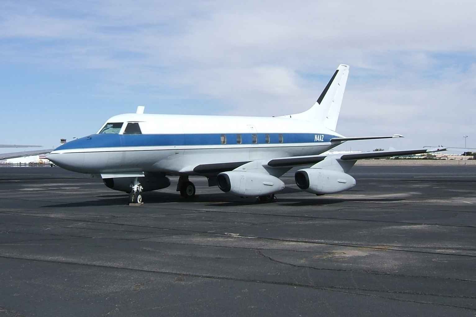

I count myself lucky to have seen her in the flesh in El Paso.
There is no beauty like the love-child of B-58 and biz-jet....
I've never heard of this aircraft until now but, wow! It's actually quite beautiful. Those 4 engines give it a very "Thunderbirds are Go!" / Gerry Anderson - ish look.  I like!
