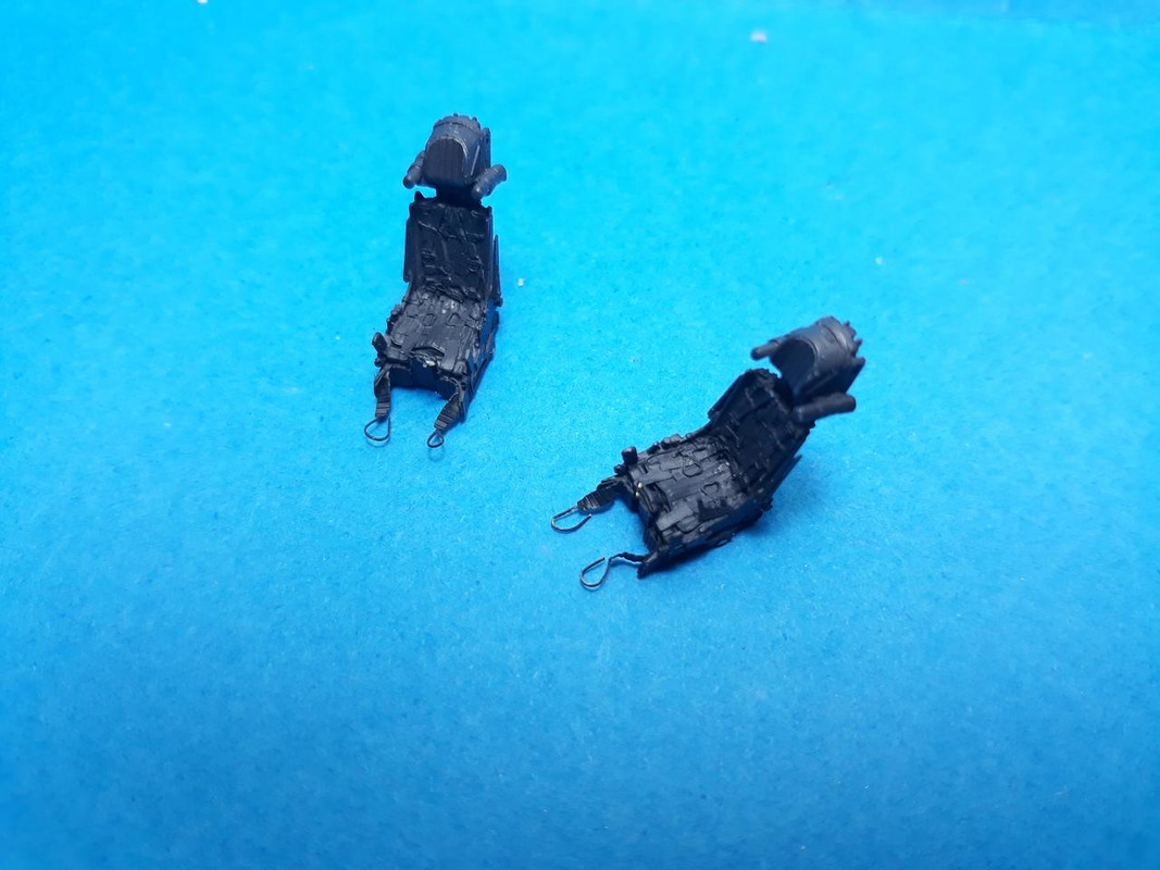

As you can see on  a previous pic, some PE parts (from the Dream Model set) were added to the seats.
Here they are primmed:

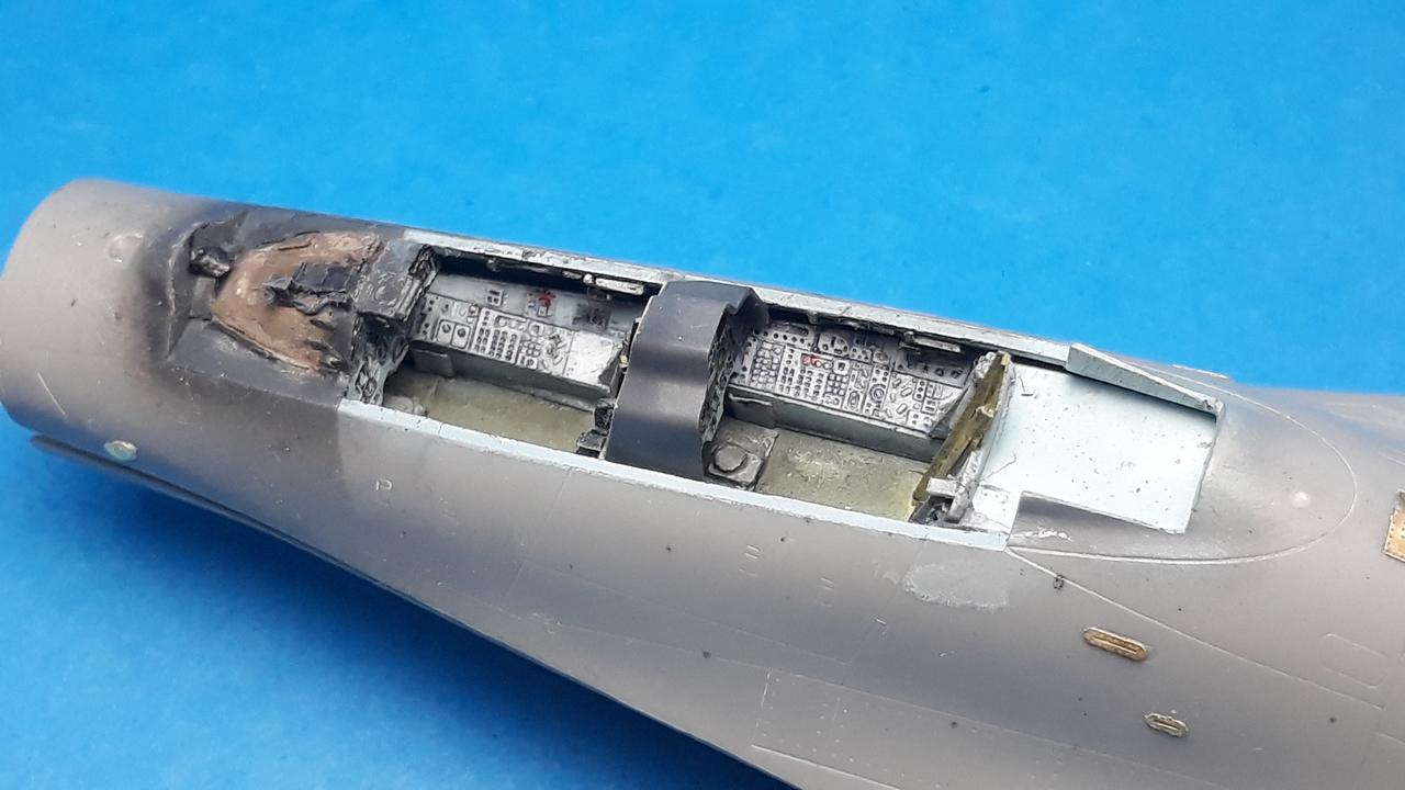

work quickly started by the cockpit, with the help of the photo etched parts, and I also added some details from scratch:
I removed the floor from the original cockpit and lowered it as I feel that it was too high as it was.
Sorry for this poor pic.
Some details were also reproduced on the interior side walls of the cockpit:
Also the instruments panel cover was improved, although this part is not yet finished...

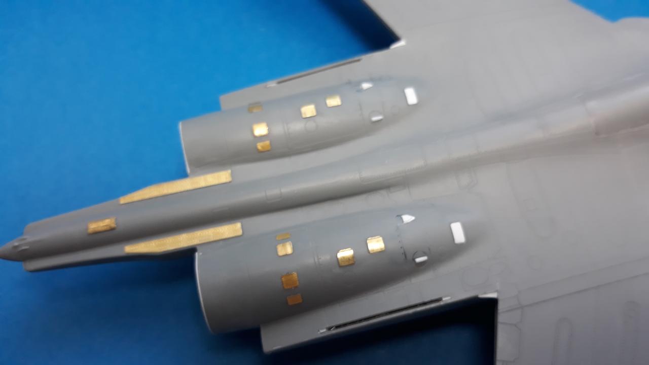

Some photoetched parts were added around the fuselage, following the instructions:

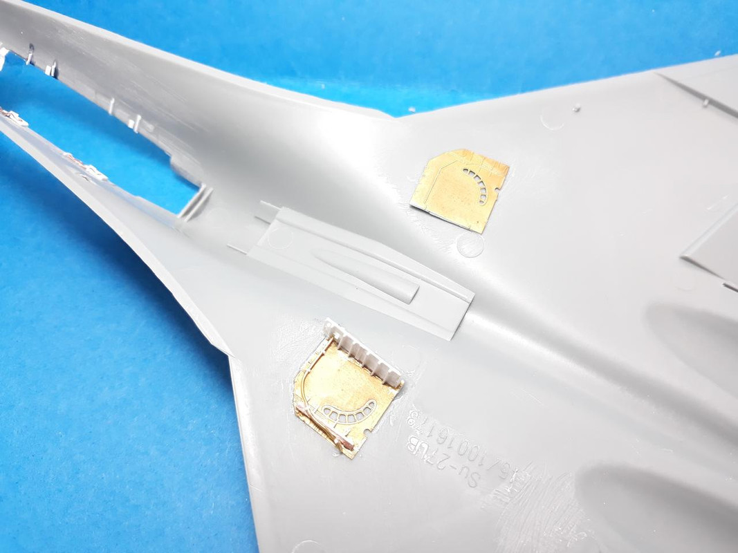

Hi again and Happy New Year all! After the Christmas season I was able to resume the work on this kit.

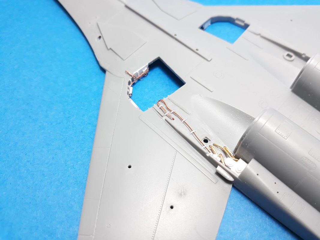

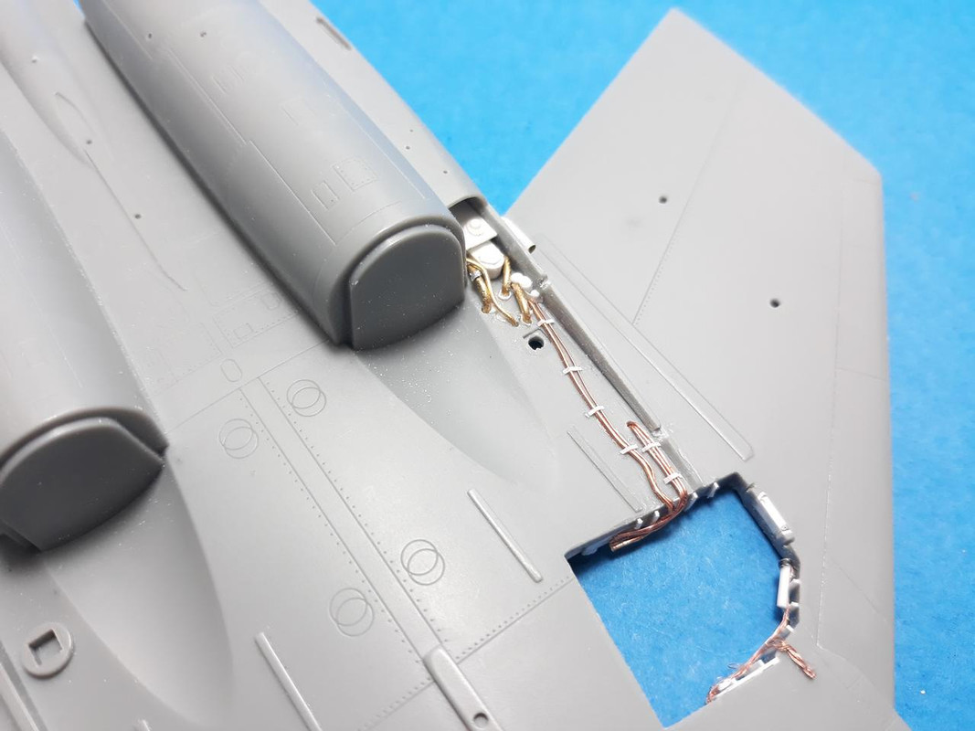

I started by  detailing the main landing gear wells. Removed the casted detail on the upper fuselaje that conform the roof of the bay,  and I replaced it with these photoetched  parts from a set of Wolfpack-d.
As you can see,  in the lower of the pic  I began to add some detail made of copper wire and plastic card and strips. Here some more:
And this is other section of the right wheel well fully detailed:

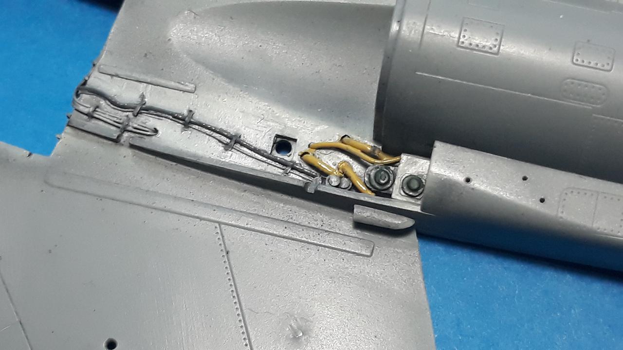

Some detail were added to the external side walls of the intake trunks, since these are part of the main wells:

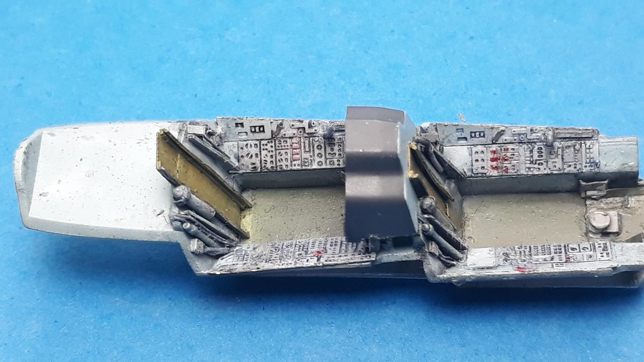

After the work on the bays and intakes I painted the cockpit:
Here the instruments panel of the front cokpit in place:
And the rear atached to the bathtube:

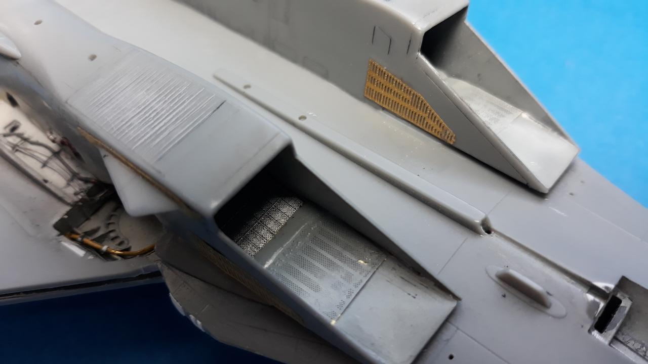

With all the previous work done  I was able to install the intake trunks:
Here a closer look:
As you can see, I have added some tiny altought evident details more from scratch.

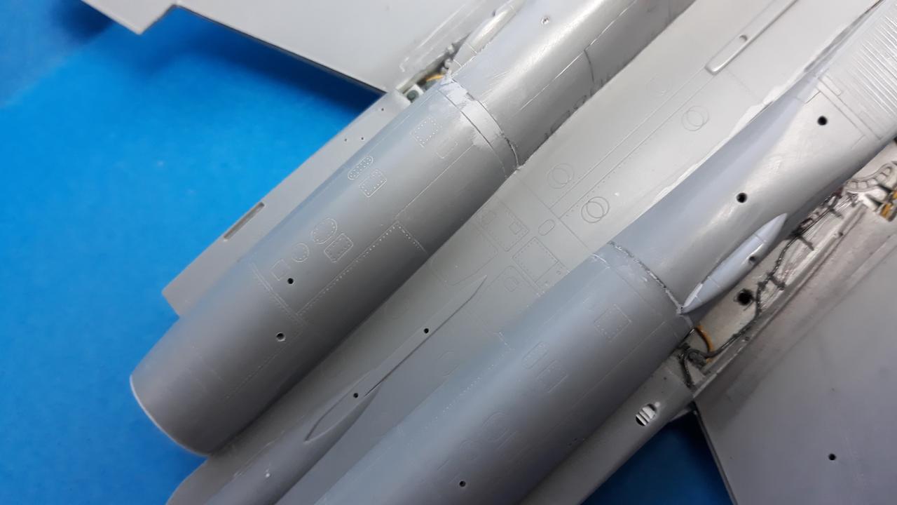

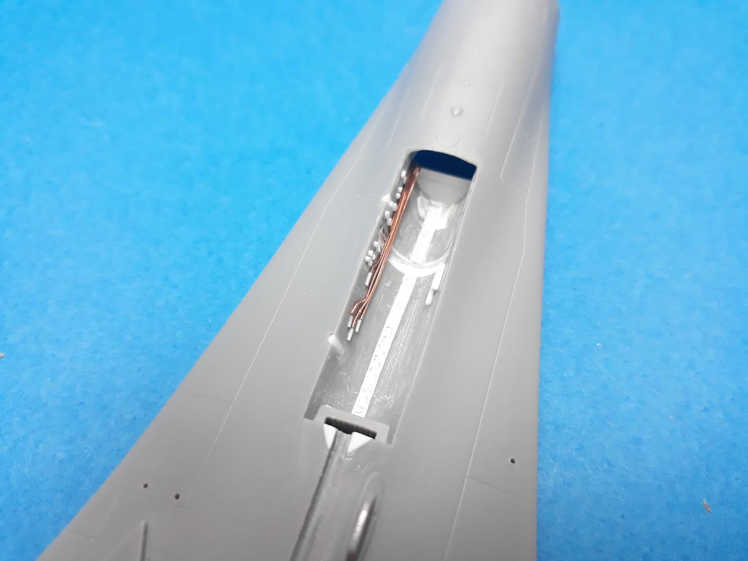

Here you can see the oval exhaust that I have added behind the left main landing gear bay:

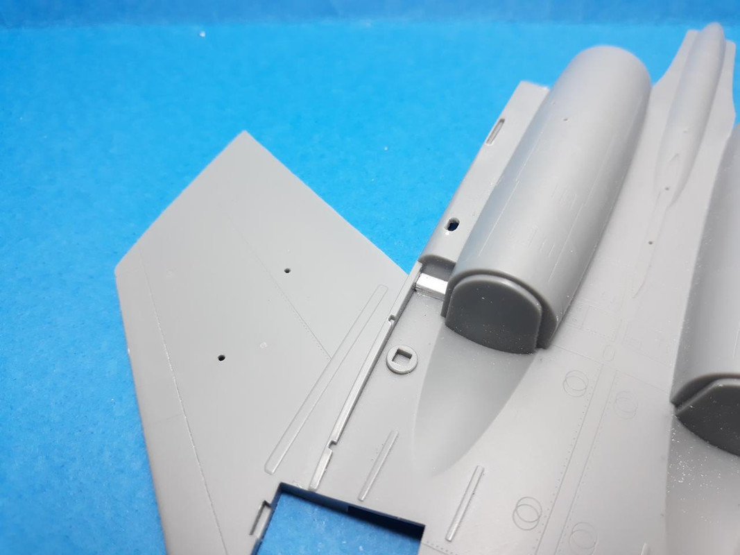

You can also notice from the previous pics that I have cut both the front and rear flaps, with the intention of depict them on extende position. Also I have drilled those little holes on the engine bays as I have found the on some walkarouns...

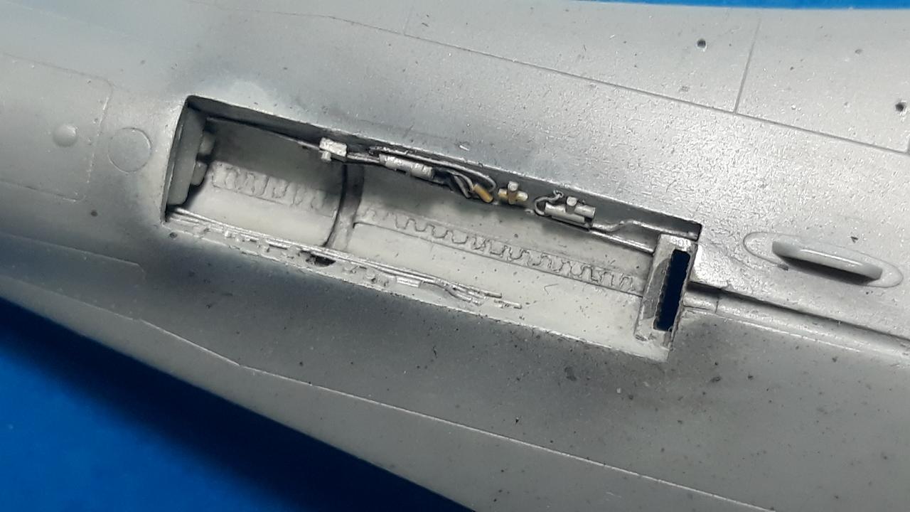

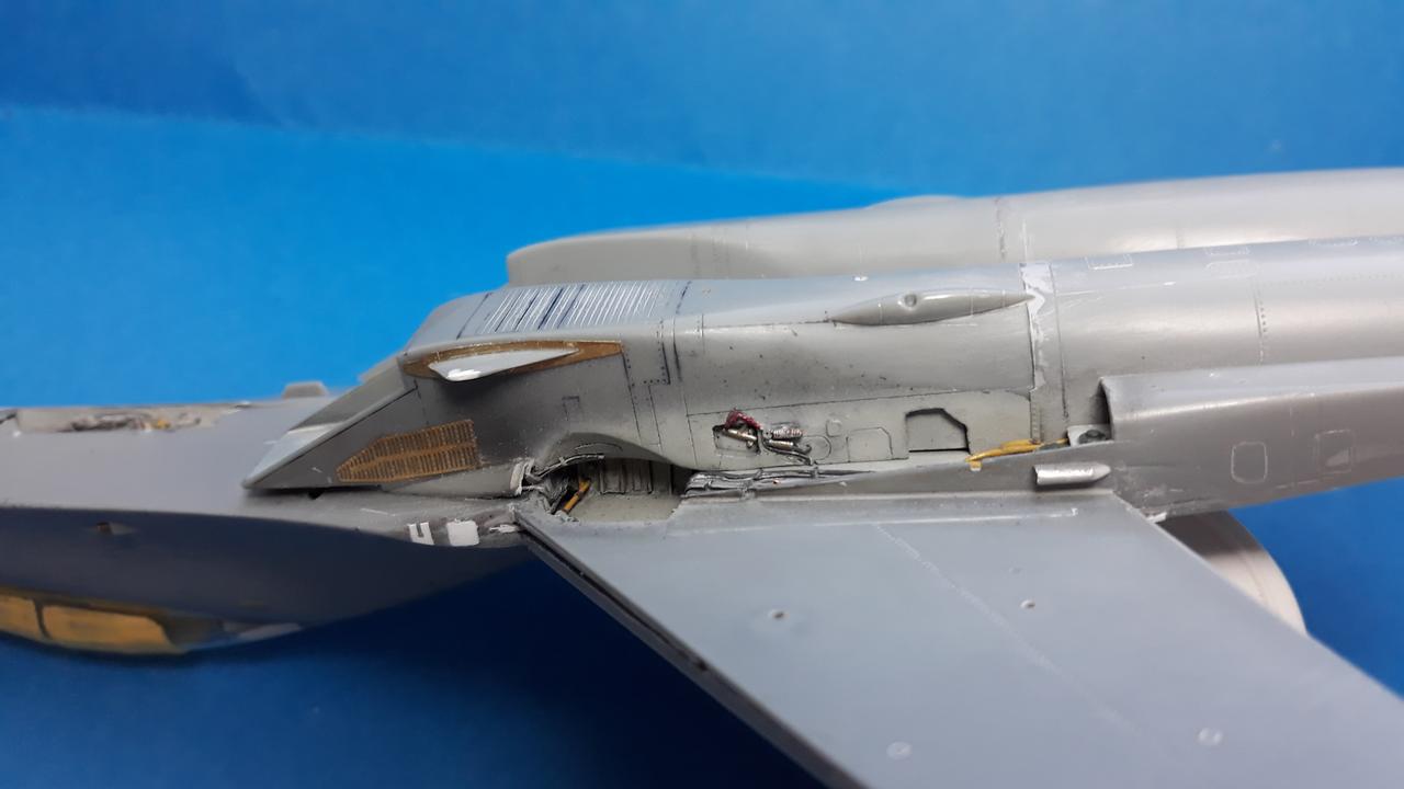

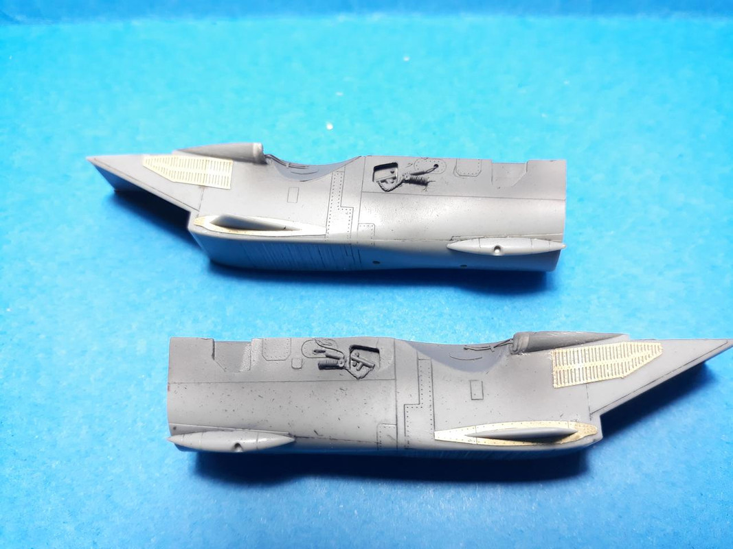

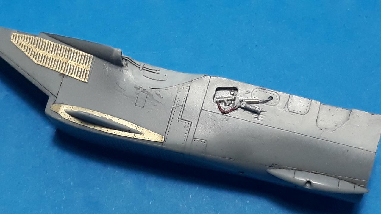

Some more tiny details added from the photoetched set and from scratch on the rear fuselage:
And also, some detail instaled on the inetrior of the intake trunks:

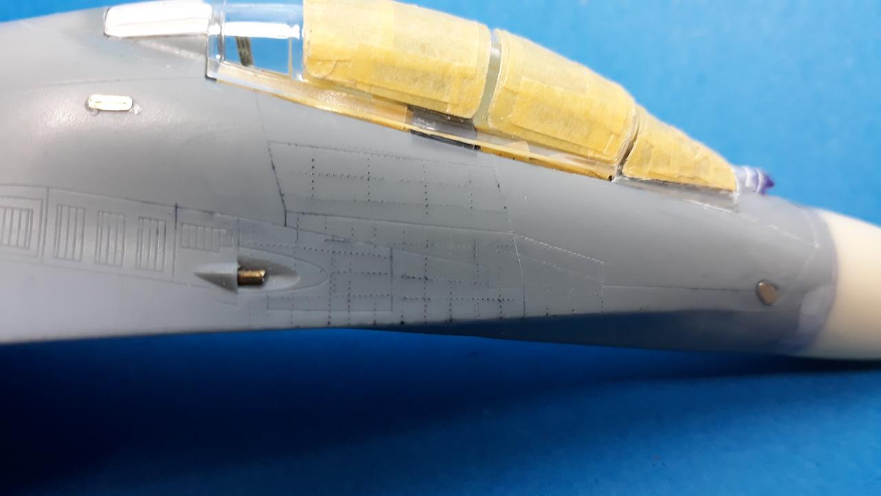

I installed the Quickboost resin nose cone and masked and dryfitted the canopy:
In the area just in front of the gun nozzle I engarved some tiny rivet. As this area will be finished in metalic colour thgis will add some more interest. Also replaced the plastic casted
gun nozzle for a brass rod.
Also some riverts were engarved on the dielectric area of the right vertical fin, and a distinctive antena were made from scratch on the top of the fin:
