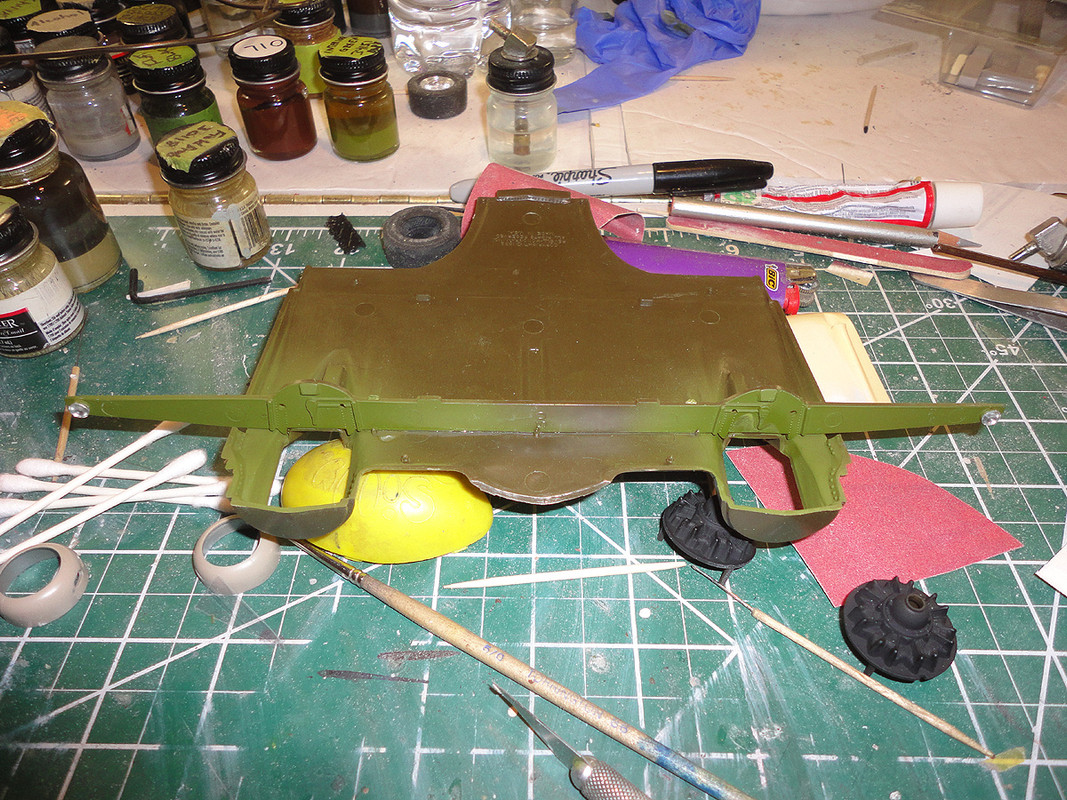

WymanV Posted January 28, 2019 Author Share Posted January 28, 2019 Decided today was a good day to fire up the Band of Brothers DVD for background noise and get started on this. Sprayed the interior colors yesterday and built up the fiddly bits today. There isn't much on this one. By all accounts there isn't much to be seen inside once it's all buttoned up and this build will be unusually closed up. I read the manifests for Mission Elmira and no C-47 carried either troops or supplies; they were solely glider tugs so there is no justification for opening up the doors. Which is good. I never liked the way Monogram did the windows in the cargo bay and it would have been a lot of work to clean that up. As it is, if you look at the photo of Sugar Puss you'll note Monogram missed a window in the radio op compartment. Most C-47 pics I've found have this window and I've seen no evidence there is a corresponding window in the other side. So the opening for said window is cut open: I have some pretty thick clear material kicking around to make the window from. And, the rest of the interior is built up: Interesting that every belt is molded in a different position. Would've been nice to depict the seats folded down but again, it all disappears. Quote Link to post Share on other sites

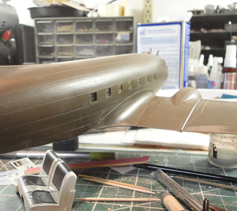

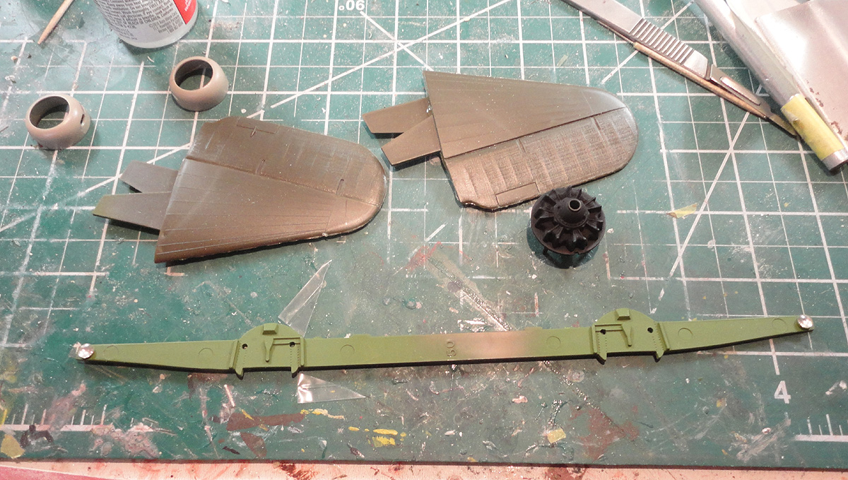

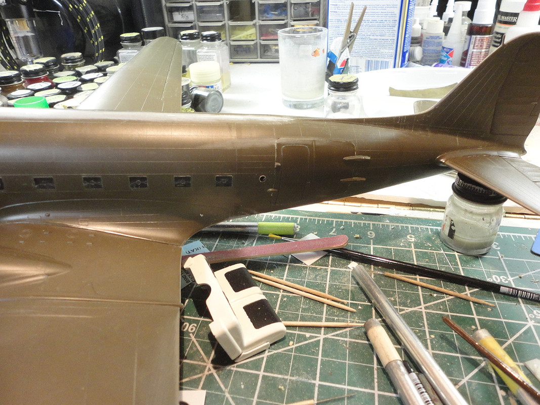

WymanV Posted February 5, 2019 Author Share Posted February 5, 2019 On 2/1/2019 at 6:56 PM, nspreitler said: Looking good, love the C-47s. And I'll pile on the C-47 updates for today Probably shouldn't have had Band of Brothers running for "background" noise because I ended up spending more time watching the show than building the plane. But I did get the fuselage buttoned up Saturday and spent Sunday finishing up the DVDs and sanding seams. Nowhere near as much inside this one as the Trumpeter kit but it's the same story-can't see any of it anyway: Note the broken hinge on the doors... 😒 Can't find it floating around in the box so it looks like I'll have to scratch up a piece to fix it. Some filler on the weak spots of the fuselage-I was expecting more from a Monogram kit so things are going well. And further on tobiK's suggestion, that's the most likely fix for the oversized window. The bathroom window on the other hand... There's the kit's representation near the center of the photo and it is indeed too far forward. And very narrow... I spent some time cruising pics on airliners.net (first time I've been there in years) and it seems to be more consistent in C-47s/DC-3s than that radio room window. But I can't get real excited about making this window. Being so small it's more likely to give me problems than not and I want to keep this build moving. I'm thinking the best bets are either to scribe the window frame in the correct location and depict it painted over with invasion stripes, or least likely replicate it with a piece of Bare Metal Foil. Today's progress was the MV Lenses that showed up in the mailbox. Here they are glued in: Horizontal stabilizers are glued up and now sanded and ready to fit. Also got a first coat on the engines. For the large bladed props on this plane I'll rob a pair of props from one of the B-17G kits in the stash. And as it now sits, the spar is glued in: I'd be gluing up the wing but the contact cement on the lenses isn't dry yet. Quote Link to post Share on other sites
tobiK Posted February 5, 2019 Share Posted February 5, 2019 The detail of the kit engines is sooo poor! Hope you can bring ehm to life with some good drybrushing and adding the ingnition wires. The gearbox crankcase is usually painted in engine grey. Quote Link to post Share on other sites

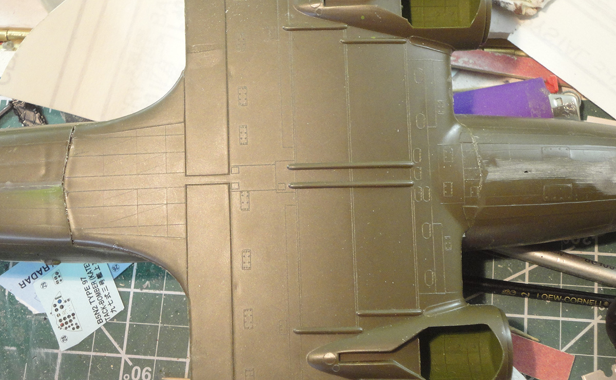

WymanV Posted February 11, 2019 Author Share Posted February 11, 2019 And the end of the weekend brings us here: The wing roots are pretty decent-there won't be much filler there. But the seam in the back of the bottom is another story... I think I'll fill that with strip styrene instead of putty. It'll make cleaner work of replacing the panel lines. Quote Link to post Share on other sites

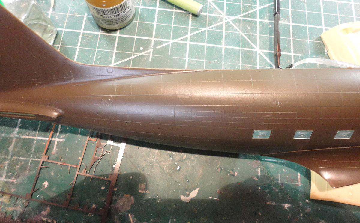

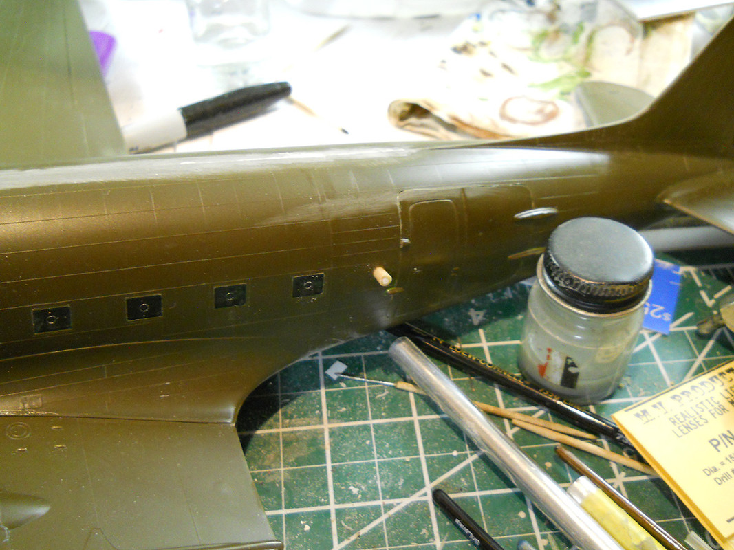

WymanV Posted February 24, 2019 Author Share Posted February 24, 2019 (edited) DAMMIT! Who knows this kit that didn't see it coming... I was doing the sanding on the wing to fuselage joins and sure enough-the windows popped out. The fuselage access doors are sealed in and sanded to fit-the piece was 'flatter' than the fuselage and didn't conform otherwise. Add to that the delicate nature of the hinges and there was no way I was taking it off to fix this. So I came up with this: It would seem Monogram depicted a sealed up window opening there which was likely present on the DC-3 version. What you see there is a 1/8" HOLE I had to drill in the model 😒 Big enough to fit a toothpick in: Using the toothpick to push on the clear strip from the inside I wicked more liquid cement in around the windows. Then I tossed the crappy camera in the trash (yes, it finally gave up the ghost) and broke out an old one: And finally sanding a taper onto a piece of sprue to plug the hole: I'll sand that down once it's good and set up. Still have to fab something up for that broken hinge. Meanwhile, I have engines to tend to. And a new camera on the way. Edited February 24, 2019 by WymanV no preview feature Quote Link to post Share on other sites
