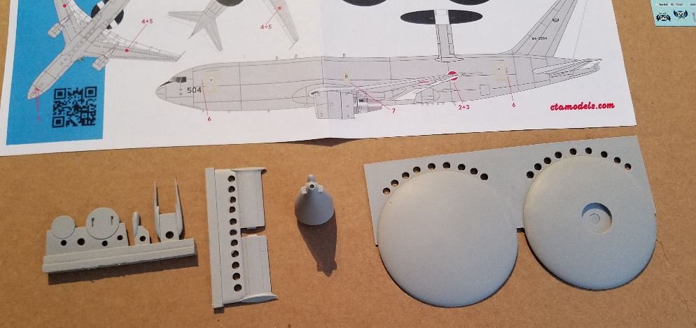

I started this build many years ago when I got a cheap partially assembled ACE (Revell) 1/144 767-300 kit with Liveries Unlimited partial EVA decals.  I cut it down to a 200, sourced a radar dome from a Revell E-3A AWACS kit , sprayed some medium gray paint on some parts and promptly put it back in the box in preparation for one of my many moves about 20 years ago.  I have decided to not buy any new kits this year (fingers crossed) and complete some or most of my hangar queens.  The fact that CTA (Russia) released a resin conversion kit with decals prompted me to decide that this will be project No 1 for 2019.  Please follow the thread here:  https://www.scalemates.com/profiles/mate.php?id=11761&p=projects&project=3949

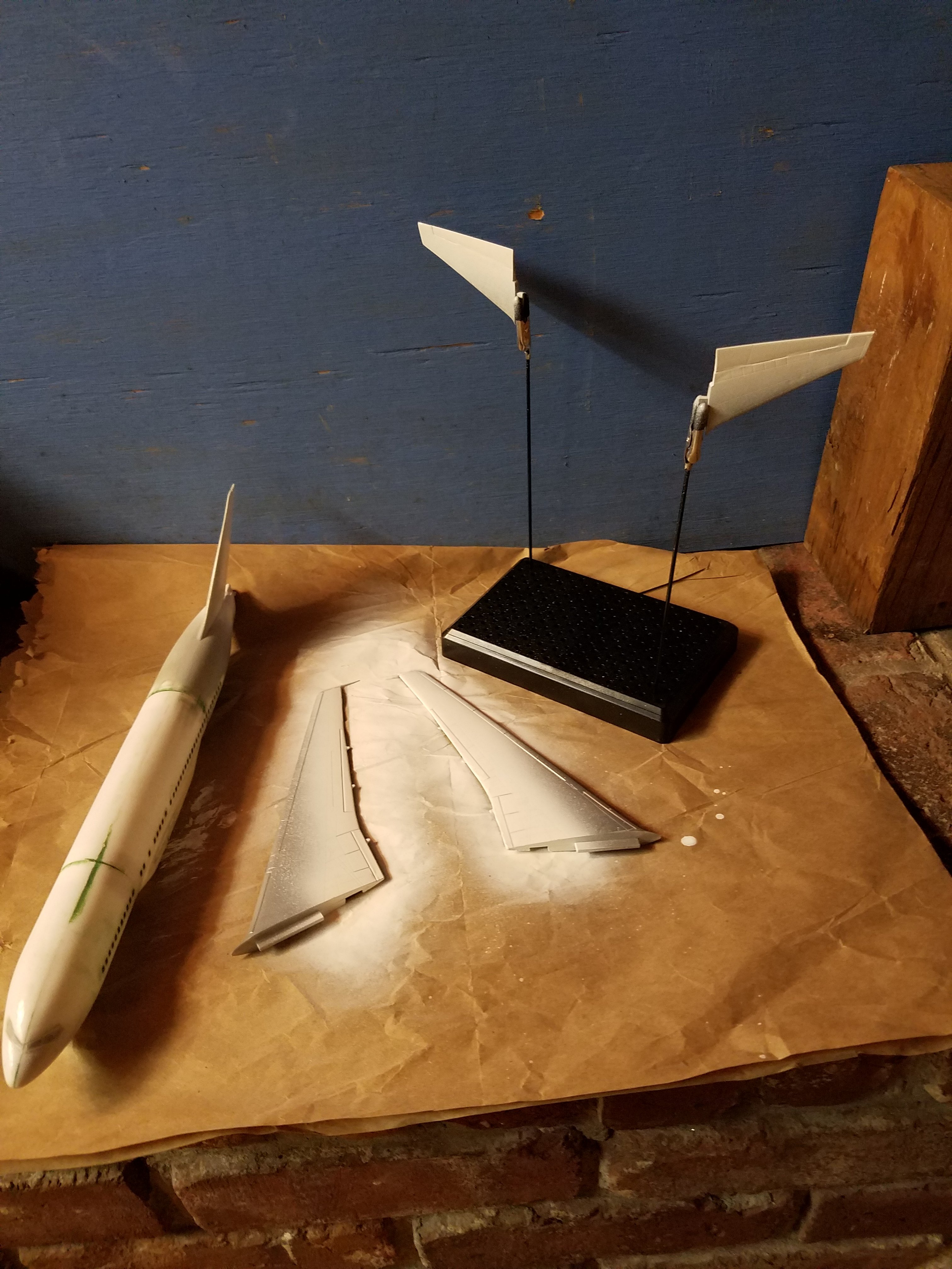

Some quick work done today.  Trimmed wingtips off and added HF aerials.  Cut off kit tailcone and am working on adjusting the CTA resin tailcone to fit.  Though the directions say it will work on either the Revell or Zvesda 767-300 kit, clearly it is meant to fit the Zvesda kit right out of the box.  Added photos 12-20.

I removed another 3/32" from the tail, but I fear I removed too much, as the tail cone now fits a little shy vertically, but still proud on the sides.  So I will have to add a thin shim of plasticard, putty the gap but then file down the sides to the best i can match the fore & aft fuselage.  Anyway, I also trimmed out the dome and mounting tab. It turned out better.  So I will say, if you use the CTA No 17 E-767 conversion, please use the Zvesda 767 kit as a base. Photos #26-29 added.

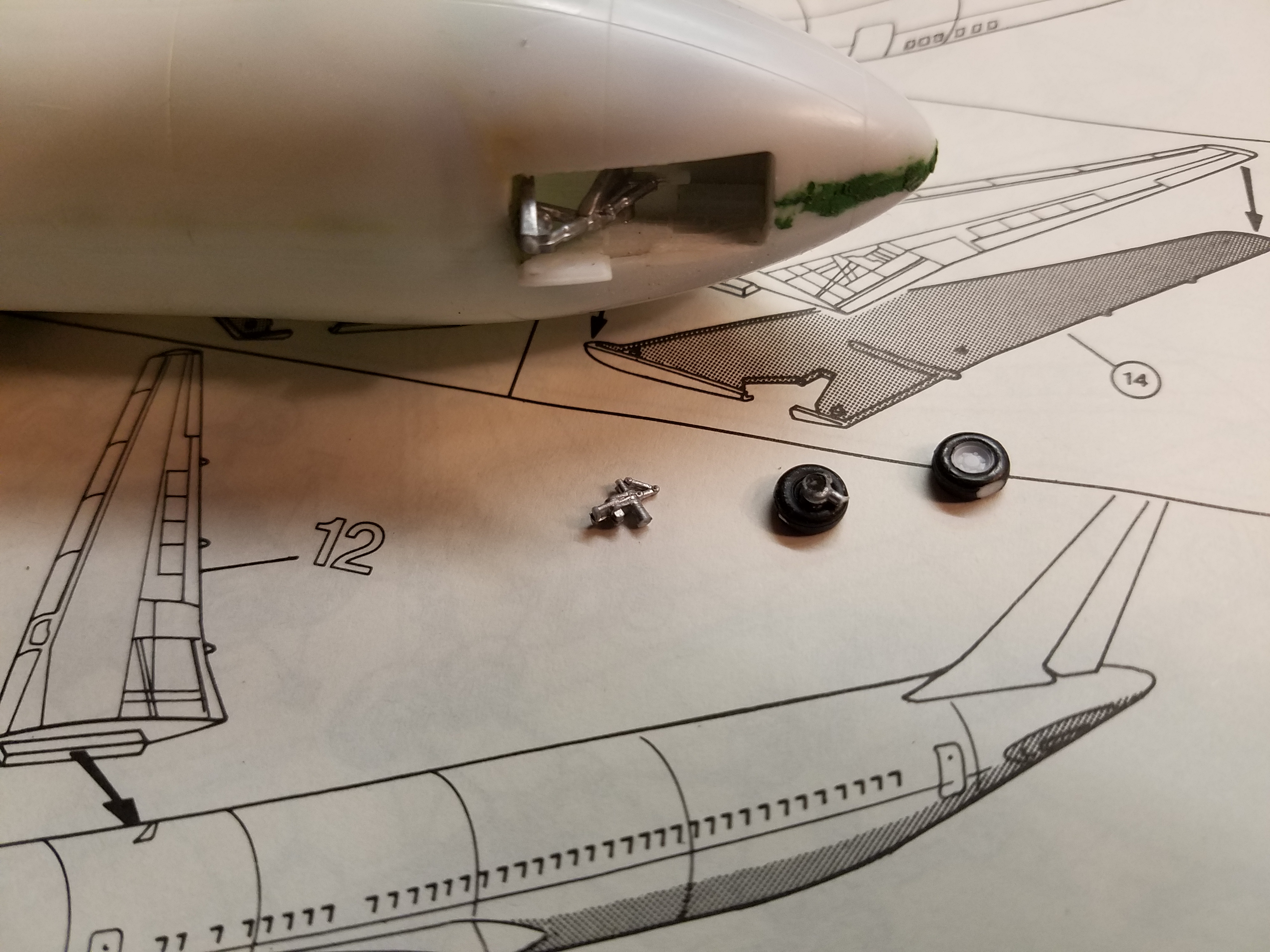

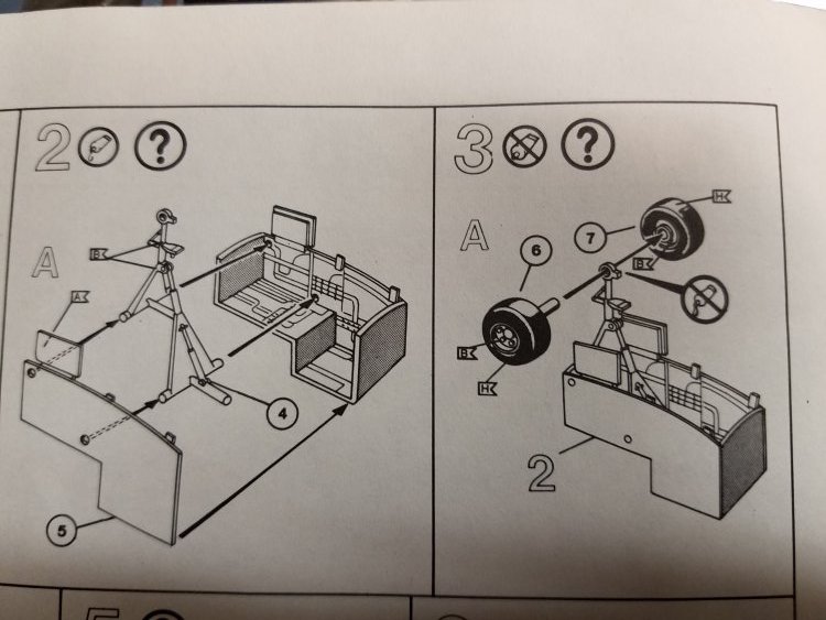

Now comes the tricky part. I purchased the kit already 50% assembled.  However,  the nosegear strut was broken into three pieces, one in the bay, the lower strut, and the small wheel truck, with one wheel broken off. I am thinking of drilling a hole in each piece and inserting a needle or small pin to reinforce the whole assembly.
Edited by Dutch
Essentially,  what I now have.  Getting to drill the hole into each end of the strut is going to be a chore.  Will definitely have to be done by hand, as the Dremel will only melt the plastic.
