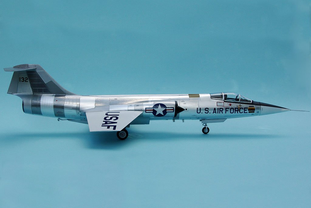

Jon, I have some experience of using metal foil since the late 70's. My favourite foil is that still found on a few chocolate bars here in the UK (twin-finger Kit-Kats) although with modern packaging it is becoming quite rare. Generally I find kitchen foil too thick although as you say the cheaper end stuff can be quite useful. It is good if you want to make a certain panel stand out from the others.
When I started foiling I used to use Humbrol gloss varnish straight from the tin, paint it straight on with a brush, give it a little time to become 'tacky', then place on the model with tweezers and rub on with a soft cloth. I started using Microscale Foil adhesive a few years ago and I recognise the fish-eye problem that you describe, although I apply it to the opposite side to yourself. My solution (for want of a better word like blind luck!) is to wait around a minute or so then brush the back of the foil again. It should have started to dry ie the tackiness that I used to get with the gloss varnish and I find that it will then adhere to all of the foil piece. I do have to admit that there is a large amount of luck involved and sometimes you apply the foil to the model and you just know it isn't going to work and it has to come straight off and into the bin. However, when it goes on right then there is no paint that can match it for effect. I see that Peter Doll's name came up in one of the replies to your question and I am just in awe of the results that he gets using kitchen foil.
I think that your F-80C has come out really well, there are some quite complex curves on that jet including the air intakes, the top of the jet exhaust and tail plane roots, and even the wing tips and these can be very difficult to foil. Did you foil the drop tanks? If so they would have been a nightmare! Additionally, the 'Shooting Star' was quite a small jet, my experience is that the larger the model generally the easier it is to completely foil (though of course it takes more time). I started out with 1/72nd kits, then up to 1/48th, and my last was a 1/32nd F-104G Starfighter.
What I did try on the Starfighter was to foil the main panels but use silver paint on the areas which I knew would be difficult to apply foil to. I used rattle cans of aluminium paint bought from an auto trade retailer as well as hobby paints and they worked well. I hope you will forgive me for posting a photo of her below. She isn't perfect but was a step in the right direction.
