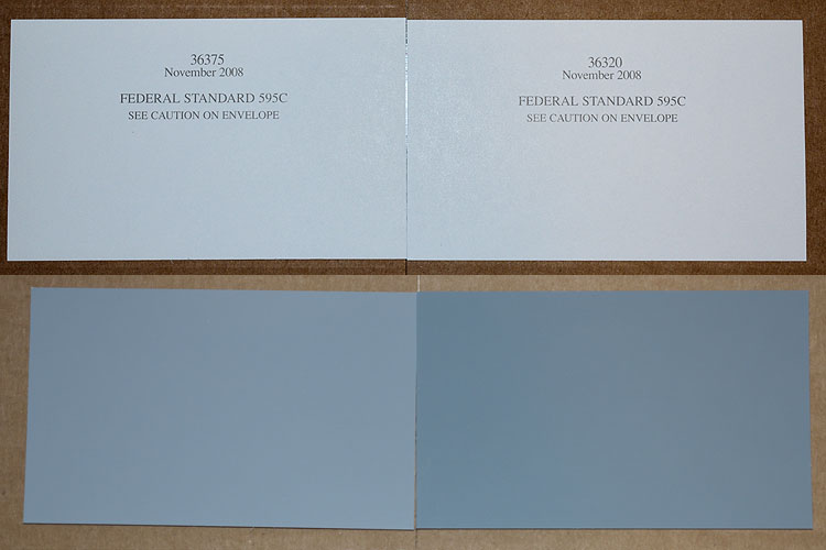

Regarding Ammo 36375 color accuracy, I would beg to differ.  Neither Ammo nor Vallejo is close.  Ammo is too cyan and Vallejo is too green:
Both lack the slight purple tint that exists in the actual FS 36375.  To get better color match from true water based acrylic paints, one needs to back at least three decades:
Model Master Acryl on the left.  Pactra Acrylic on the right.
Richard, I am just curious.  Did you buy those color chips or is it something I can print myself from a reputable website?  And if so, what website would you recommend?
You never want to print the color chips out from a website since 1) they are no where close to being accurate 2) your color printer won't be able to accurately render all color components.  Even federal color fan decks are not approved for color verification.
Please order authentic individual federal color chips from these two sources:
