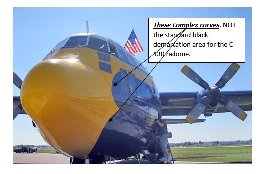

pminer Posted July 25, 2019 Share Posted July 25, 2019 (edited) Guys, It just occurred to me that I need to show a picture of what I mean. It's not the standard C-130 black demarcation area for the radome. It's the Blue Angel yellow area unique to Fat Albert. I need to know how to mask off and paint these complex curved areas. See pic. I'm building the 72nd scale Blue Angels C-130 Fat Albert. I've got everything ready but I need some tips & tricks on how to mask off and paint the nose area. It's the area of the nose that's yellow with complex curves. Anybody know how to do this? I'm not really good (yet) with painting complex curves. Thanks! Edited July 27, 2019 by pminer Insert pic Quote Link to post Share on other sites
mhvink Posted July 26, 2019 Share Posted July 26, 2019 The best way is with an airbrush or even a rattle can. Tape off the rear edge where necessary and have at it. Mike Quote Link to post Share on other sites
Trojan Thunder Posted July 27, 2019 Share Posted July 27, 2019 Do you have a circle cutter. I'd be figuring out the diameter of the top curve, cut a circular mask that size apply the circle and then down stairs you could do similar, looks like a similar diameter circle to me Conversely you could lay tape over that entire area and pencil the fillets in, using images/profiles as reference. Remove the section of pencilled tape and cut away the unneeded extras. With this way you could flip the design and transpose it to tape to do the other side. You have me intrigued, I have all the gear to also do a BA KC-130F and I am tempted to have a go. Quote Link to post Share on other sites
Chriss7607 Posted July 27, 2019 Share Posted July 27, 2019 Honestly, for that I'd go with thin strips of tape to get the outlines down then fill in the areas outside with more tape. The thinner the strips, the more of a curve you can mask. You can either: A- cut some masking tape with a straight edge and a hobby knife or B- I think it's Chartpack that makes tape that narrow. I personally think that masking tape would do just fine and you wouldn't have to buy anything else. I would start at the bottom of the nose and work up. Have two pieces of tape cross at the point of the scallop. Mask one side and make sure you're happy with it then do the other side to match. That's just my two cents. Hopefully it'll at least give you some ideas. Quote Link to post Share on other sites
phantomdriver Posted July 27, 2019 Share Posted July 27, 2019 Tamiya curve tape works well.. 1mm and 0.5mm Quote Link to post Share on other sites
Chriss7607 Posted July 28, 2019 Share Posted July 28, 2019 Oh yeah, I forgot about Tamiya's line! I haven't used the ultra thin curve tape before but if it's anything like their other tapes it will do a great job. Quote Link to post Share on other sites

Paul Boyer Posted July 30, 2019 Share Posted July 30, 2019 Oh, and paint the blue last! Start with a coat of flat white for good coverage. Then gloss white over that for the topsides. Next mask the areas to remain white and spray yellow. When that is good and dry, mask the areas to remain yellow, and then paint the blue. There are exceptions, but as a rule it is best to start with the lightest color then go to the darker colors. Quote Link to post Share on other sites
Ben Brown Posted August 4, 2019 Share Posted August 4, 2019 Consider a light coat of clear gloss along the tape edges before you spray the blue. It will help prevent the blue from creeping under the tape. Be sure to use a clear that’s compatible with the yellow and blue paint you’re using. Ben Quote Link to post Share on other sites
Chriss7607 Posted August 4, 2019 Share Posted August 4, 2019 4 hours ago, Ben Brown said: Consider a light coat of clear gloss along the tape edges before you spray the blue. It will help prevent the blue from creeping under the tape. Be sure to use a clear that’s compatible with the yellow and blue paint you’re using. Ben I do this with almost all of my masking and I recommend it as well. I've never had a problem doing it this way. Quote Link to post Share on other sites
