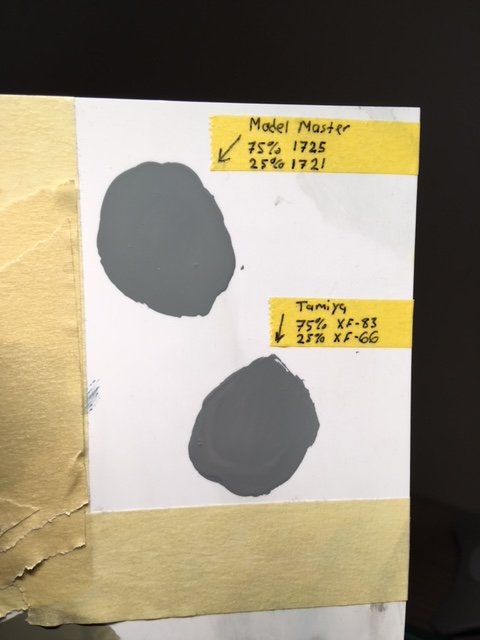

I messed around mixing the colors that are called out for in the Syhart instructions. I did a sample with Model Master and Tamiya. This is what I got.
