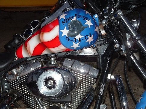

You are so right, perhaps I phrased my initial question badly. It should have been 'I want another ab, would this work?' 🙂  My Eclipse is pretty sweet and certainly capable of more than I am. I painted this for a customer long ago with a Passche VL with a gigantic medium tip (not sure of the actual size) and I find my Eclipse much more capable than the VL, al least for detail.

I don’t know, another reason to buy it!! Lol. Thank you for the compliment on that tank btw. It only lasted a few months before he wrecked the bike. I had to paint another just like the first one.
