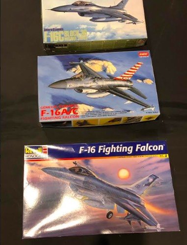

Revell-Monogram F-16 ADF vs Academy F-16A/C vs. Hasegawa F-16 C Block 30

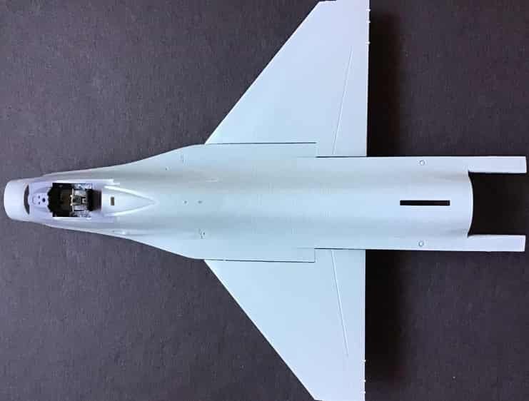

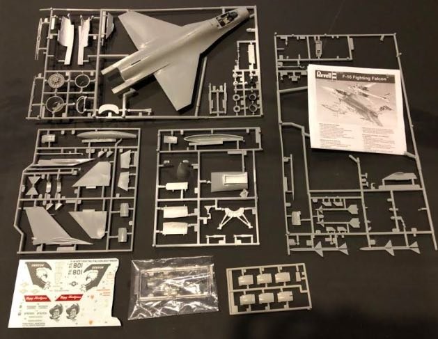

First, the Revell-Monogram F-16.  I am not sure if this was originally the Monogram or Revell when the kit was originally released.  This is represents the Block 15 ADF version.

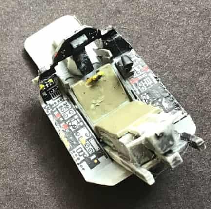

On the plus side, I like the attached main wings and the shape seems right.  On the downside, the cockpit has almost no detail with decals to represent the instruments.
Decals include Oregon ANG and North Dakota ANG.  I will probably build it with the Rough Riders artwork, strictly out of the box.
for decal instruments, those don't look too bad. At least not from your photo.
I used a wash on the decals to tone them down a bit.  Also, the forward panel (not shown) is not so good.  The ejection seat is detailed enough.

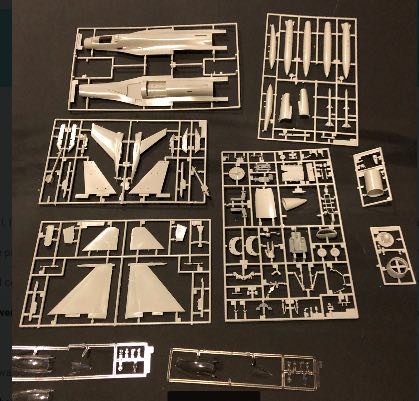

Parts trees and decals for the Academy Kit.  Appears to be very similar to the Hasegawa.  Has a great deal of ordinance included.

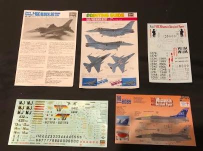

Hasegawa instructions, decals.  I will be using the Two Bobs Dairyland Vipers sheet depicting the 60th Anniversary for the Wis ANG.
One nice touch is two complete canopies, tinted and clear.

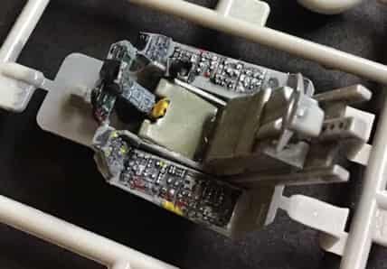

Comparison of Academy and Hasegawa cockpits.  The Academy consists of decals, which were very fragile ( the instrument panel part disintegrated.  The Hasegawa has raised details that paint-up nice and are reasonably close to a F-16 block 30.  Both seats are inferior to the Revell seat.
This is the Academy.

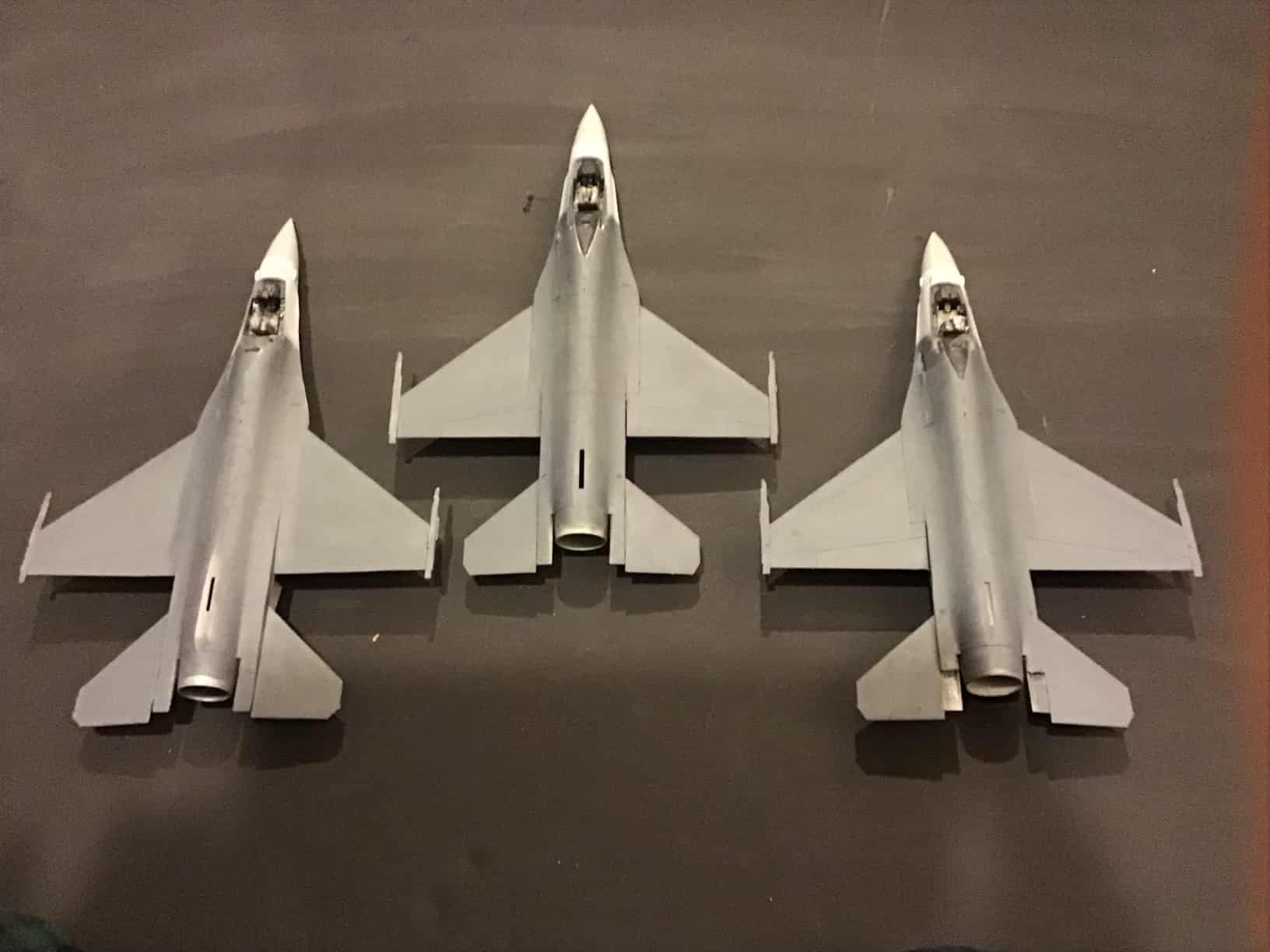

After preliminary painting. I used model master enamels, dk gray 36118, Lt gray 36375 and neutral gray for the radome.

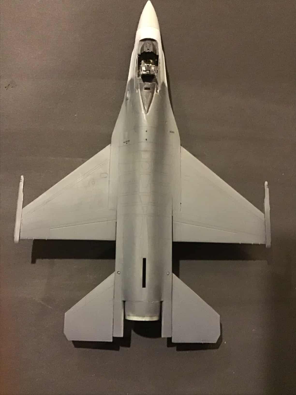

The Revell. On the plus side, I really like the molded wings, as both the Academy and Hasegawa had prominent seems to deal with.  It also has the correct slightly downward angle of the missile rails on the wingtips.  On the downside, it has a curious mix of raised and recessed panel lines.  Overall fit was not bad.
One difference of note among the three is that inside the main landing gear bay, the Revell has a “half hourglass” shape, whereas the other two get narrower front to back in a straight line. I’m not sure which is correct.

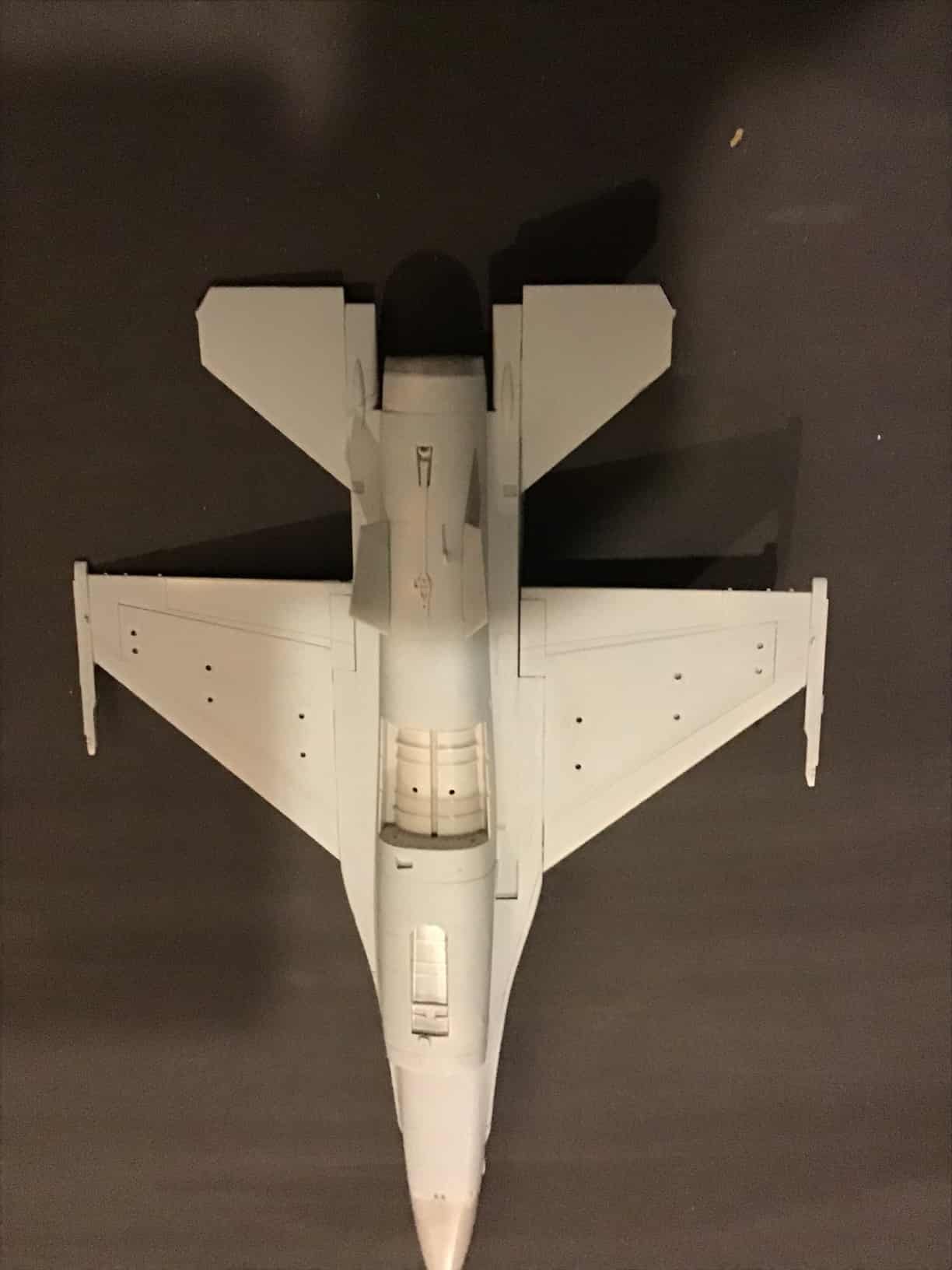

Revell underside showing the hourglass shape in the main gear bay. The arrestor hook is a separate piece on the Revell but molded into the fuselage on the other two.

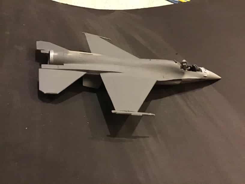

The Academy.  The overall fit of this kit was ok, but certain areas it was terrible. The main wing joints are weak. I’ve had to reglue them  3 times and the seam keeps wanting to open.   You can see this in the first pic.

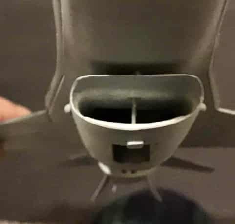

The worst area was the intake.  Where the lip meets the intake, there was a gap of almost a quarter inch.  Huge amounts of putty to fill it. Still looks terrible, needs a FOD cover.

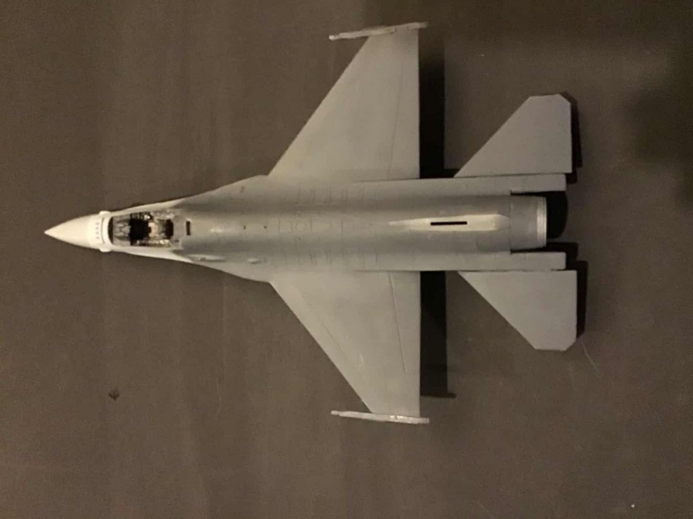

The Hasegawa. The fit was as you would expect. It needed a little putty around the intake, the nose, and wing roots, about the same as the Revell.

Can you identify the kits left to right in this pic?  I ask because the distance from the trailing edge of the wing to the leading edge of the stab looks smaller/shorter on the left kit.  Or is it just an illusion in the pic?
L-R . Revell, Academy and Hasegawa.  The distance difference is just an illusion of the pic, what you are seeing in the Revell is the ventral stabilizer beneath the starboard wing. Both the Revell and Hasegawa match up identical as far as size.
The Academy seems just a tad smaller, like it is 1/49 or so instead of 1/48, not that you can tell from this pic.
UPDATE: Upon further review, the distance between the trailing edge of the wing and the front of the edge of the stab is 3/16 “ longer in the Hasegawa than in the Revell., or 9 scale inches (good eyes, Habu!) The Revell stabs are about the same amount larger than the Hasegawa.
