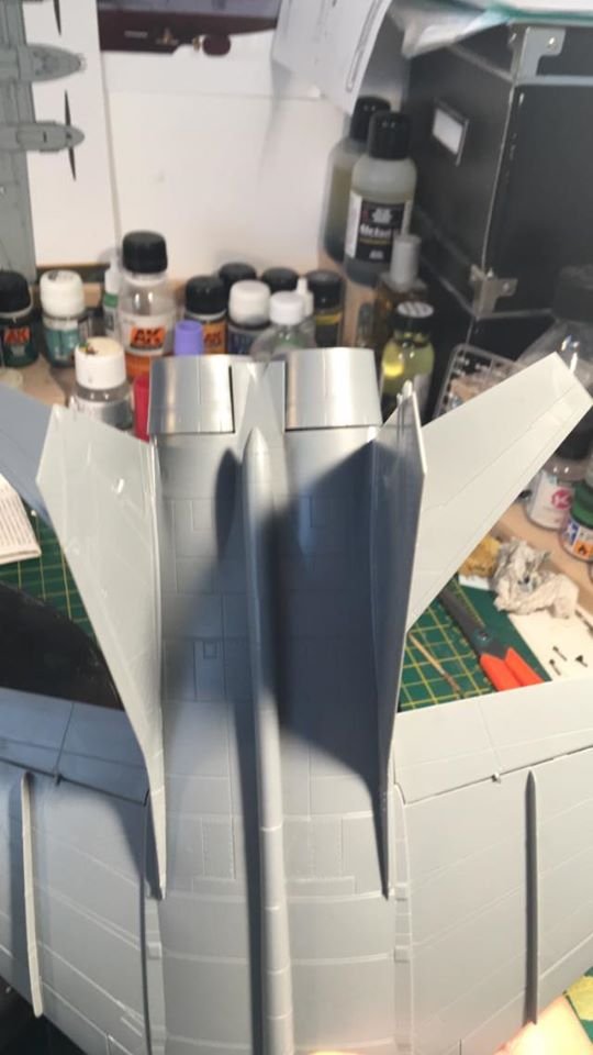

Today I attached the wings with the upper fuselage. Went together nicely although the underside of the LERXes needs some filler. The chute container on the other hand had a pretty bad fit and even after careful dry-fitting needed quite a lot of sanding and some filling.
The tires are clearly a letdown. If I'm on the right mood when I'll visit my LHS, I still might replace them with Eduard ones because that will resolve the mudguard issue at the same time. I'm actually working with the mudguards but I'm not sure if my detail work will pay off in the end.

I had some fit problems with the wings - still have. The lower part of the wing just goes too deep inside the top part and creates a rather nasty step both near the wing tip and at the LERX.
