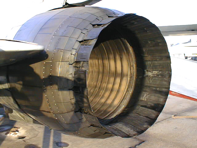

Those Katran nozzles have some really funky shapes and the shroud parts have some strange grid panel lines that don't exist on the real thing...
- Closed nozzles aren't fully closed and close at a strange angle and have a kink, kind of like the kink in the F-15 featherless nozzles.
- Open nozzles have too long extension of the inner petals.

Funky shapes? Mind you elaborating further on, mister?
These are the open ones for the Hasegawa kit, and the funny thing is that the picture of the inner petals for the open nozzles on the real thing which is at the back of the sleeve have got just as long an extension as on the resin bits.
Strange grid, if wrong - which I don't think they are, could always be filled and sanded.

The grid of panel lines you see on the on the Katran sleeves should be, I believe, either rivet or welding lines. You can see them in some photos where they have been painted over with some sort of anti-corrosion paint. I don't think they should be actual panel lines. As far as the inner petals on the "open" nozzle. I have seen many photos of them in that position. It think it is an intermediate stage just before fully open and occasionally, when shut down, the nozzle doesn't fully open. I see it most often in photos of the engines going into full afterburner. Probably just before full afterburn is reached. Often you will see one engine completely open and the other almost but not quite there when the photo was snapped.
P.S. See page 26 of Detail & Scale No.9 F-14A & B Tomcat for an example of the  pattern of lines on the engine sleeves. I believe there is also an example in the Lock On F-14 booklet.
P.P.S. See page 34 of Squadron's F-14 Tomcat Walk Around for an example of a stopped engine with the nozzle petals in the position seen on the Katran open nozzle.

Приветствую всех, я немного не понимаю, почему они так критически относятся к моим открытым соплам и не любят, что они очень продвинутые. Когда я их сделал, я взял эти фотографии за основу.
6703914937-76053ab451-b.jpgвременный хостинг изображений
And here is my 3D model
And to write that Eduard is the best is a sin, whom else would I take? This is K.A. (Mk.1 Design)
