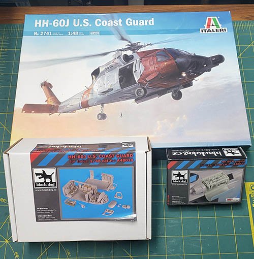

Good Evening, I know its been a while But I've finally got the main pieces together to start modelling when I get the time. I'm still short some tools, but that's something that can be addressed as time progresses.
The kit you already know about. Now in addition that that I have the Black Dog Interior Kit, and the black dog Engine as well.
Sorry about the poor photo - ill try to update this as soon as my host is back online.
I forgot to say thank you for the tips on the paint too!
