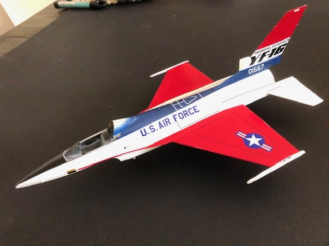

Here is my solution.  I used parts from the Otaki, Early Tamiya and a first issue Hasegawa F-16A.  There is a panel line just forward of the front edge of the windscreen where I cut the Hasegawa fuselage and then mated the Otaki nose to the Hasegawa fuselage.  I then assembled the intake trunk and cut 1/4 inch out of the length at the rear edge and mated that to the fuselage. I then puttied and sanded until it was all good.  I took the Hasegawa fin and sanded off all the limbs and bumps and used that.  I reduced the cord of the wings by taking .060 off the leading edge of the Hasegawa wings, and .080 off the trailing edge.  I reduced the span of the wings by about a tenth of an inch off each wing.   I used the sub fins from the Otaki kit, the stabs from the Tamiya kit, as well as the nose gear door, pilot tube, wheels and ejection seat.  Its not 100% accurate by any means but it looks the part visually.  I am still decaling this beast which I call my frankenviper.
IM......PRESSIVE.  Well done.  A lot of work I'm not sure I'd want to do, but this is very well done.

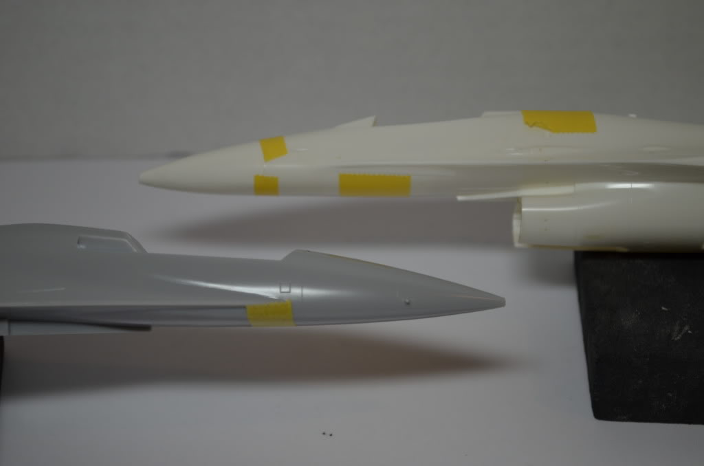

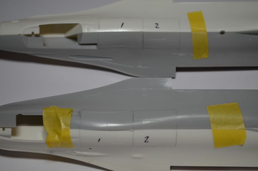

I have the three kits (Extex/Otaki, Tamiya (early), and a Hasegawa "A" for detail parts and probably the wing/fuselage, and vert stab). I thought about just pushing forward with the Otaki kit...but that "hump" is just way too much! I then intended to do some surgery with the Tamiya kit to replace that area. Here are some comparative photos for anyone interested, the gray being Otaki, and the white Tamiya's early YF-16. Perhaps this will spur internet sales of Otaki and Tamiya F-16A...and thus Kursad's decal sheet!  😉 👍:
Edited by 82Whitey51
What in the world were the Otaki tool makers looking at when they made that humpback behind the cockpit?
