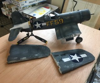

Jimd0586 Posted January 19, 2020 Author Share Posted January 19, 2020 Thank you everyone! I appreciate the help! The technique worked well and I’m surprised at how the multiple layers of paint and hairspray didnt “flood out” the panel lines. I’m not done yet, but here’s a pic of my progress: (and yes I know it’s far from perfect. I had a hell of a time with the decals cracking and breaking and the air intakes on the wing roots fit terribly. I’m horrible with filler putty although this pic doesn’t show it) Quote Link to post Share on other sites

Jimd0586 Posted February 1, 2020 Author Share Posted February 1, 2020 @11bee Finished! I have attached the link to Imagepost. I admit I over-weathered it... pictures of that period in the war (1945) show allied planes as not nearly so beat up. But this was a proof of concept build. You can’t see them, but I scratch built the seatbelts. I had some real issues with the wings on the trumpeter kit. It is a great kit but the hinges are really flimsy. I’m giving this one to a family friend that recently bought me a set of WWII history books. I know it doesn’t compare with the other models posted on here, but for my abilities I think it looks alright. https://postimg.cc/gallery/39afl32f4/ Quote Link to post Share on other sites
