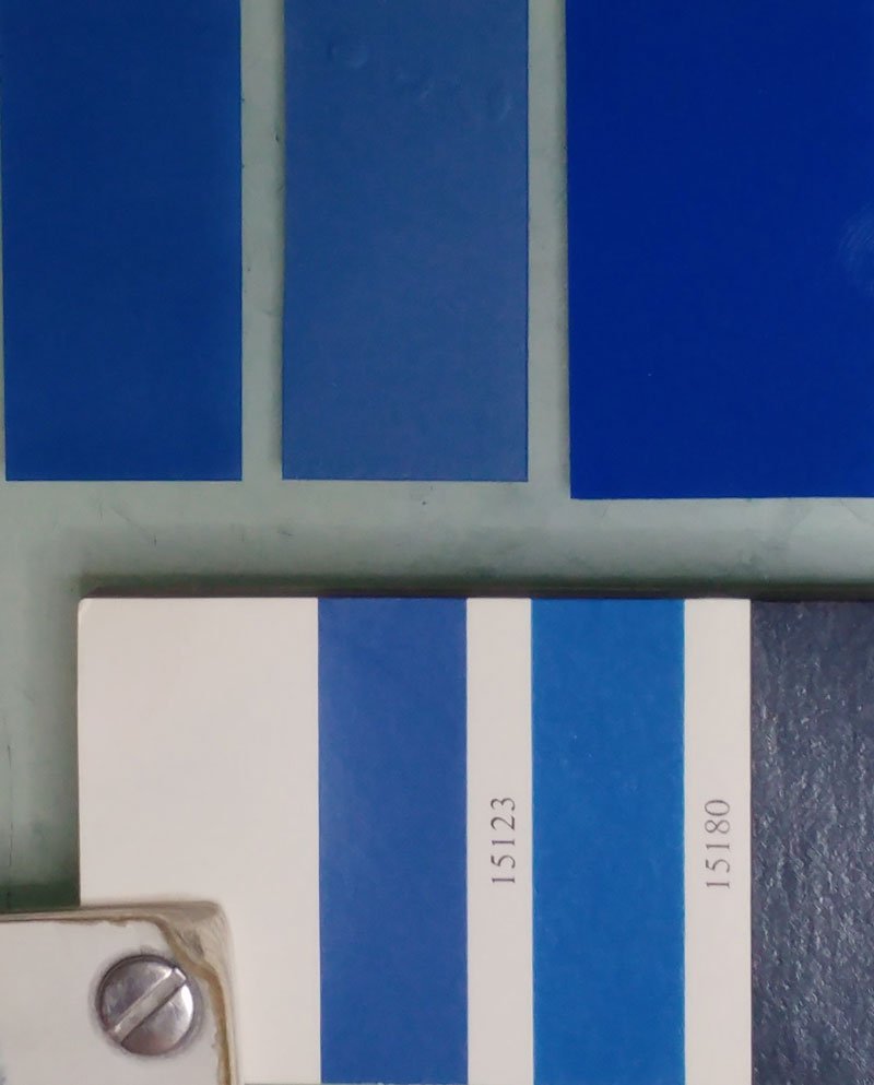

Finally got a bottle of MrColor 65 Bright blue and sprayed a test sample.  It is too dark and bright for FS _5123.  I had a good look through my 50 shades of blue drawer and came up with two other candidates that looked near enough (though not labelled FS_5125).  I took the image on my mobile under LED lighting - not the best, but daylight was waning.
MrColor C65 is on the right, on the left is White Ensign Models WEMCC GW17 WW1 RN/USN #3 Blue, and in the middle is WEMCC ACUS 28 True Blue.  That looks like the best match, although in some angles it looks too dark.  Overall I think it will work on the early Pukin Dogs scheme.

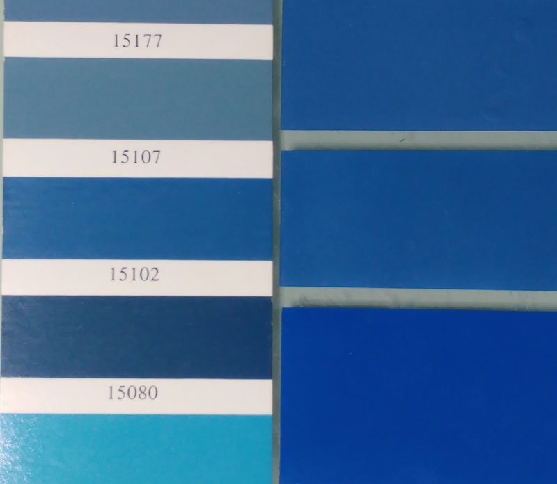

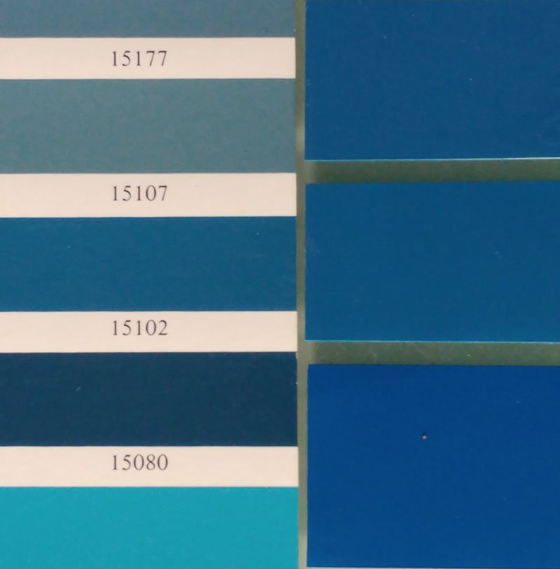

Thanks for your input Brian.  Here is another look at the same three colours compared to 15102.  MrColor C65 is on the bottom with the two White Ensign Models Colourcoats on top.  This time the RN/USN #3 Blue is in the middle and the True Blue on top, but there is little difference between them.  The MrColor is too bright and intense for 15102 whereas the Colourcoats are a pretty good match even though they are an eggshell finish rather than gloss.  I suspect a gloss coat will darken them somewhat.
The first photo is taken under the LED lights of my desk lamp.  The second photo is taken with natural (overcast) light coming in from the left.  Both photos taken with my mobile phone with no white balance correction.
