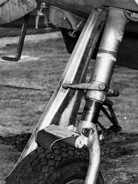

Consider this P-51 landing gear. Both kit manufacturers have the opportunity to get the struts correct. They would also have the opportunity to get the outline and structure of the door cover. But look at the door edge. On the Airfix kit, that part is 0.03 in, which works out 1.44 in. While both of your hypothetical kits would necessarily make similar compromises, the thicknesses chosen by Revell are most likely different from Tamiya. To be sure, this example wouldn't likely effect PE or resin. The more important differences would occur in internal structures, such as within fuselage and wings.

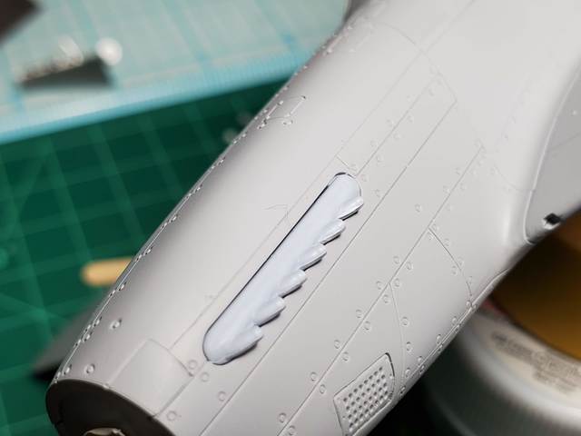

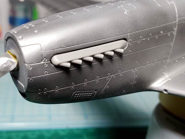

Another example of different decisions on non-visible parts. Here are the Quickboost exhausts for the Tamiya 1/48 P-51D (bottom) and the Airfix exhausts (top). First off, the visible part is different. I haven't looked to see which is (more) correct.
Here are the non-visible sides. Quite a bit different.
With a little fettling, the Airfix part fits in well
The part for the Tamiya kit would need some work to fit in and then more work to properly fill the space. Right now, I'm leaning to cleaning up and drilling out the exhausts on the Airfix part and leaving the Quickboost part for the Tamiya yet in the stash...
