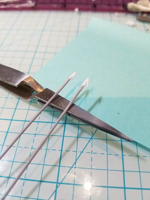

I just put a blob of glue on and then paint it.
The knobs on the ends of these 1/48 boat hooks are CA that I then painted.
