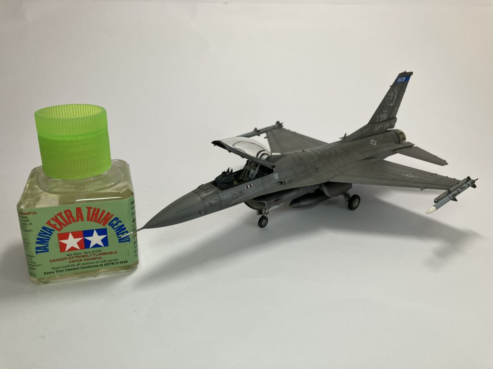

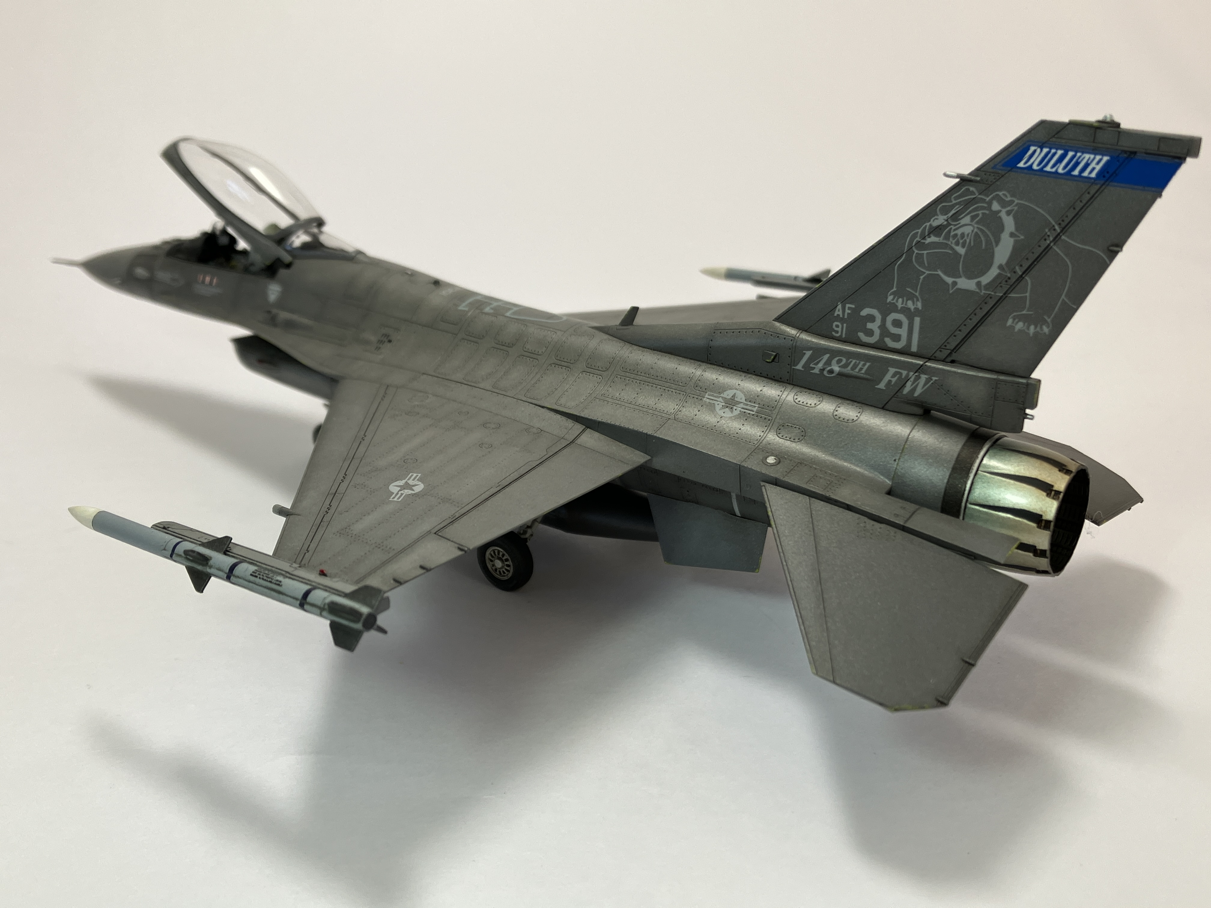

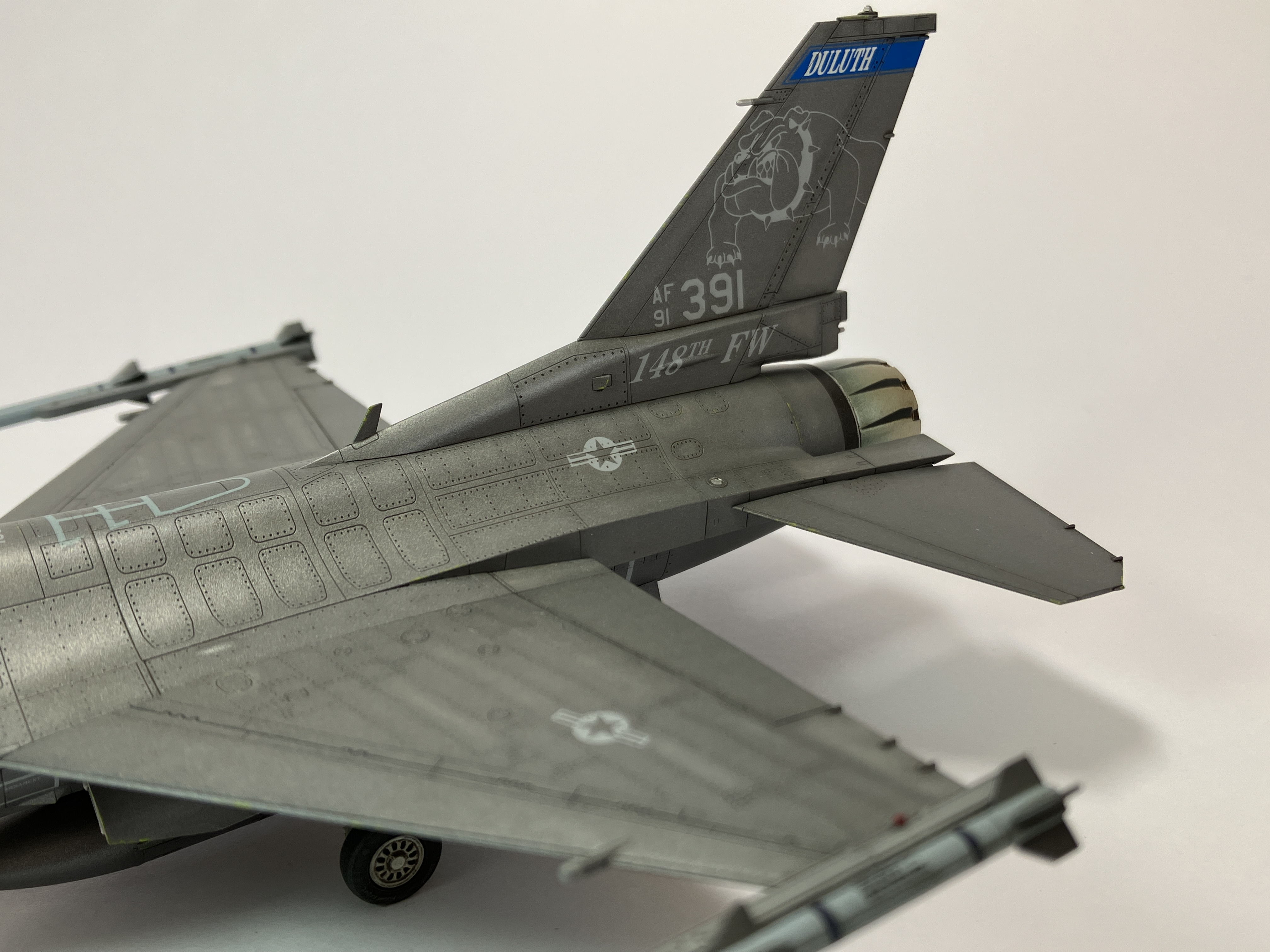

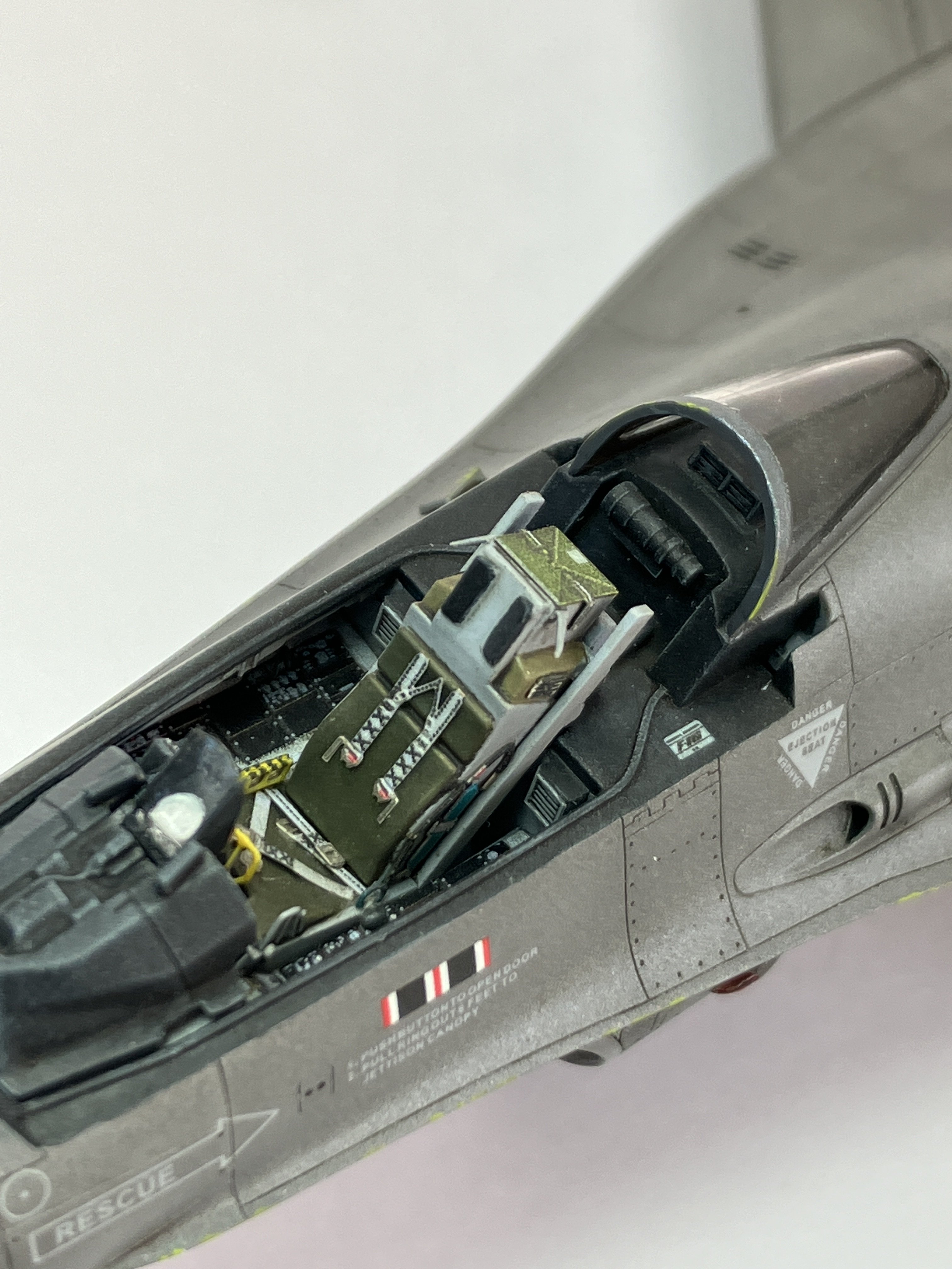

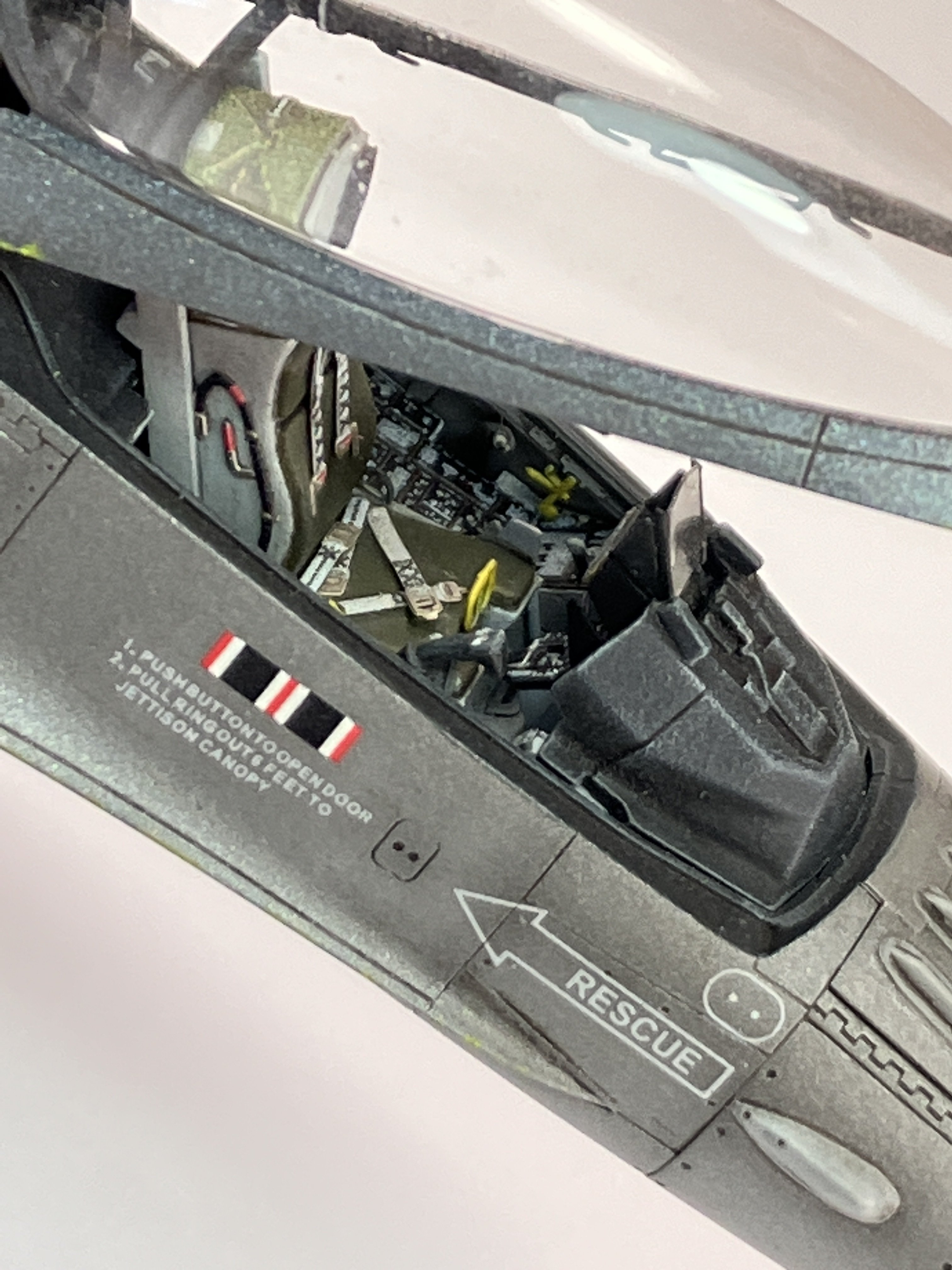

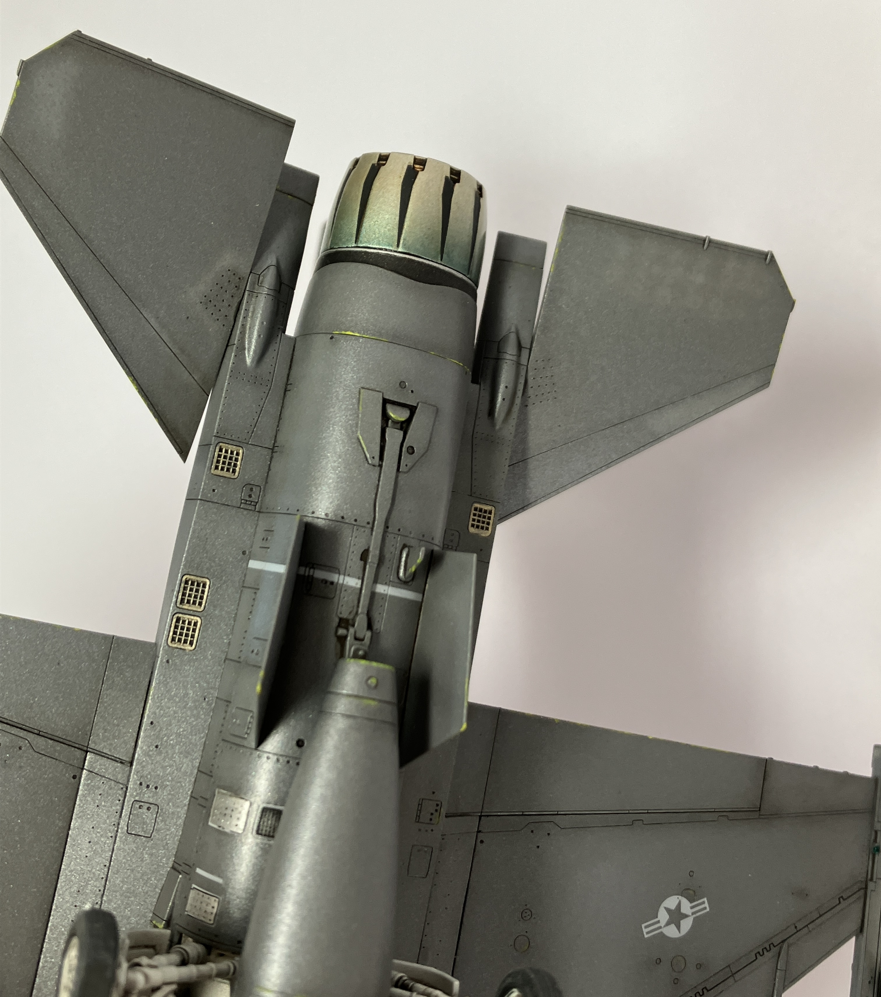

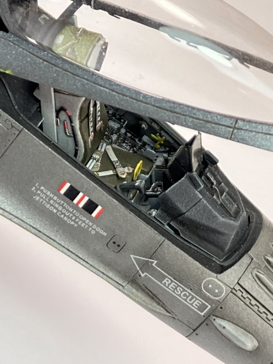

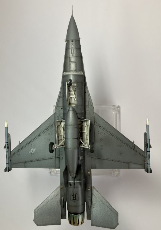

Tony Oliver Posted June 20, 2023 Share Posted June 20, 2023 1/72 F-16CJ haveglass. Tamiya kit. caracal 72019 next gen viper sheet. hataka red line paint. Quote Link to post Share on other sites
KursadA Posted June 20, 2023 Share Posted June 20, 2023 Very nice! Always great to see HG5 Vipers - I think you got the color and the details spot-on. Quote Link to post Share on other sites
fessSto Posted June 21, 2023 Share Posted June 21, 2023 Very nicely done, Tony. I have a special place for those Duluth birds. Quote Link to post Share on other sites
Dutch Posted June 21, 2023 Share Posted June 21, 2023 (edited) Wow! A real stunner! Love the paint job, cockpit detail, subtle weathering and how on earth did you get that iridescent shimmer on the exhaust? Edited June 21, 2023 by Dutch Quote Link to post Share on other sites

Tony Oliver Posted June 21, 2023 Share Posted June 21, 2023 On 6/20/2023 at 5:49 PM, KursadA said: Very nice! Always great to see HG5 Vipers - I think you got the color and the details spot-on. 8 hours ago, fessSto said: Very nicely done, Tony. I have a special place for those Duluth birds. 7 hours ago, Dutch said: Wow! A real stunner! Love the paint job, cockpit detail, subtle weathering and how on earth did you get that iridescent shimmer on the exhaust? 2 hours ago, Niels said: Very very nice! Thanks gents. To get a uniform metallic sheen but still look weathered I tried a different approach to black basing as mixing darker or lighter shades of the havglass paint would have diluted the metallic by adding white or black etc. So this was primed in good old fashioned grey. Then pre shaded and highlighted with black and white. Then the haveglass hataka redline was mixed with mig ammo ‘transparator’ basically satin varnish to make the paint kinda see through. Built up in thin layers and thats it. the nozzle was painted in Tamiya Titanium silver acrylic and then had some tamiya clear blue and yellow detail misted on but it’s gone a bit too greenish for my liking. Then the decal overlap areas then lots and lots of clear gloss to seal those on and add depth. Bit of matt varnish then brushed on overlap areas. That’s about it. this build is from 2016 or so. Only recently started sharing/posting on this forum but been a member for a while. Still have this build in the cabinet. Won some golds at local/regional shows. should do a proper thread for it in display case section I guess. cheers, tony Quote Link to post Share on other sites
Mike J. Idacavage Posted June 23, 2023 Share Posted June 23, 2023 Tony, that is an outstanding Have Glass Viper! You nailed it in 1/72. Have fun modeling! Mike Quote Link to post Share on other sites

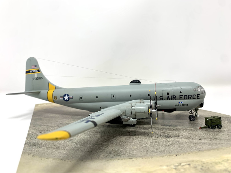

AD-4N Posted June 24, 2023 Share Posted June 24, 2023 Not mine, but a fine 1/144 HC-97G using our favorite decals over at Britmodeller. Quote Link to post Share on other sites
