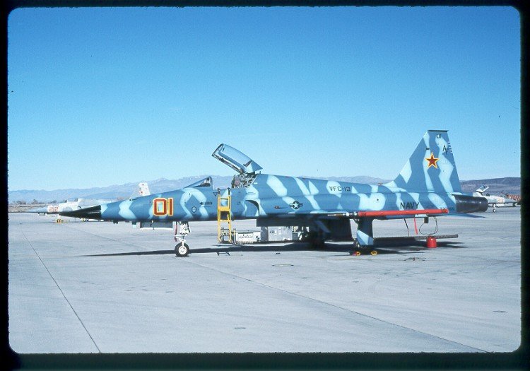

Thanks for the story.... very interesting! All of the F-5E's that returned to the US from the SVAF ended up in aggressor service or with the 425th TFTS at Williams AFB. The jet in this pic, 73-0865, was one of them and served as a USAF aggressor at Nellis for number of years before being passed on to the Navy in the early 90's. It served with VFA-127 then VFC-13 until about 2005 or so before finally being retired. I do believe that it got preserved and is at a museum at Perris, Ca (I think) I'd bet money that its one of the jets pictured on the USS Midway in the pic that Habu posted! Fred K.
