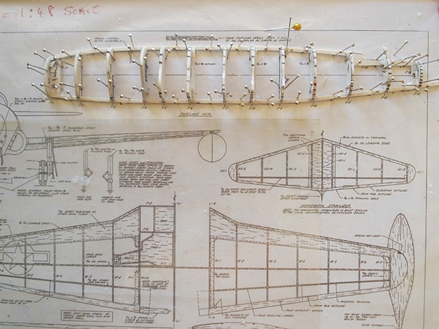

First up....I searched for some decent scale plans of the Shooting Star and re scaled them to 1:48
I started on the fuselage......

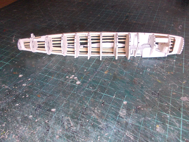

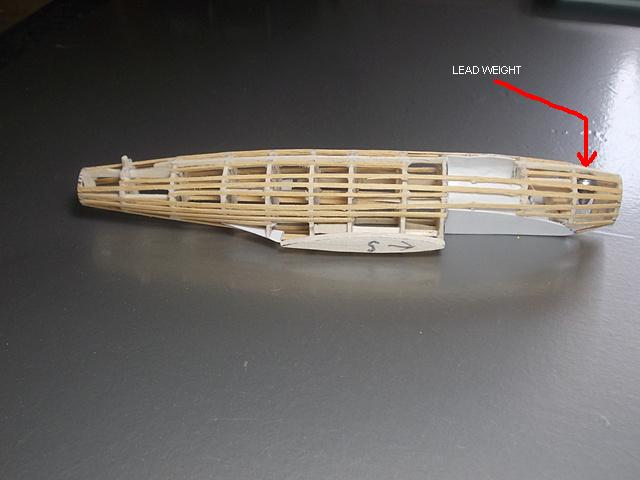

Formers were glued into place and the cockpit and front wheel well area were prepared....
Mustn't forget the lead weight in the nose as she will sit tail heavy....something I always forget to do!!!
Next up I filled the gaps between the stringers with scrap balsa....something I always do so that I can sand down to the stringers and get a good shape of the fuselage.

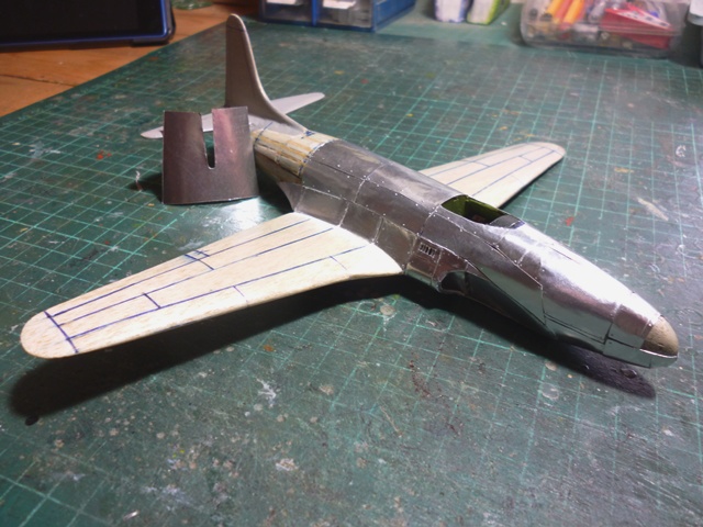

Here is the fuselage sanded down and the tail unit (made from balsa wood) and the wing roots and fillets prepared....

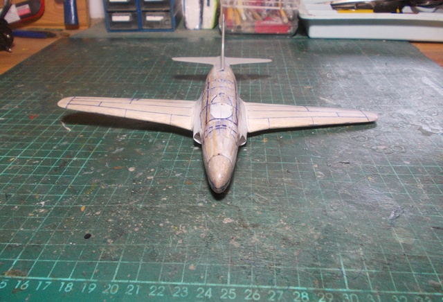

Balsa wood wings were then shaped from a block and fitted to the wing roots....

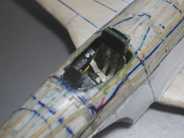

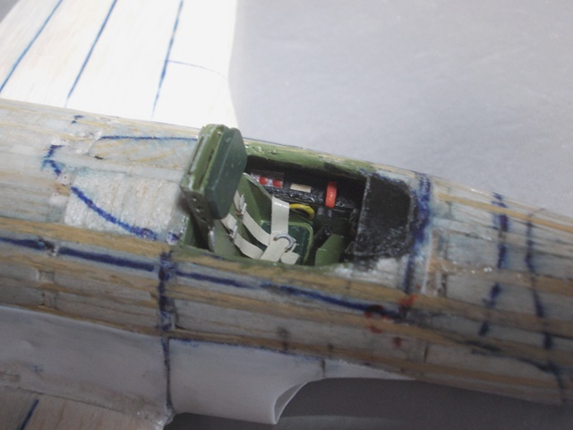

It was time to build up a basic cockpit...I say basic as I wanted to display this F-80 with the canopy closed....(the aircraft looks better that way in my opinion!) so actually you wouldn't see much of the detail anyway......

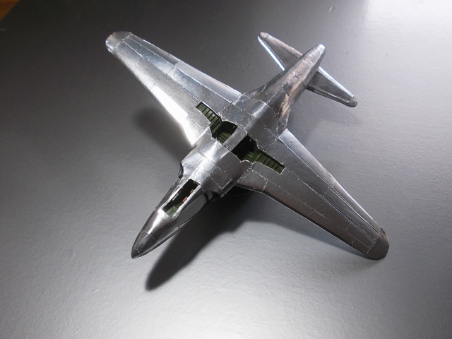

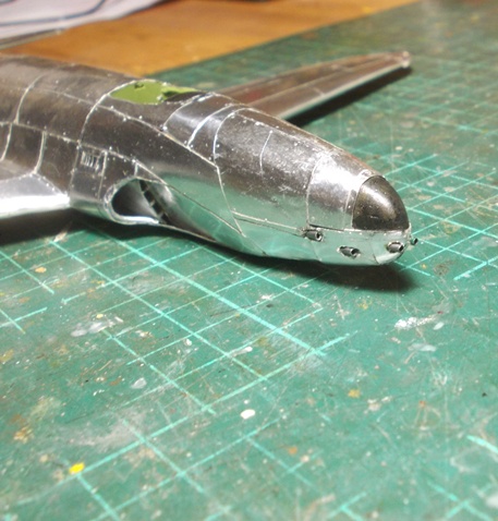

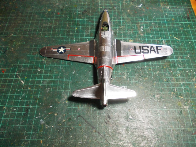

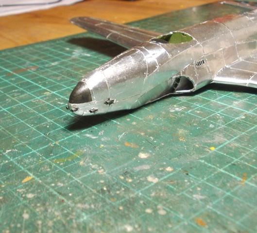

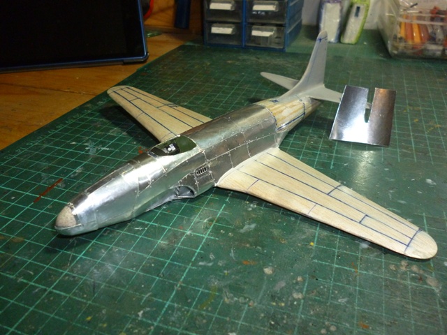

I wanted to try something completely different than how I normally skin my scratch built aircraft and that was to cut each panel separately from a sheet of sticky back silver paper. This took me a few days I have to say but I was pleasantly surprised with the end result. As I cut each panel out I made the rivet markings with a pin as I went along...as hopefully you might see!!
The air intakes on either side were a nightmare I might add!!

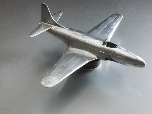

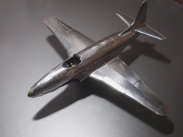

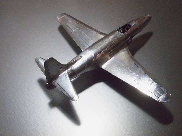

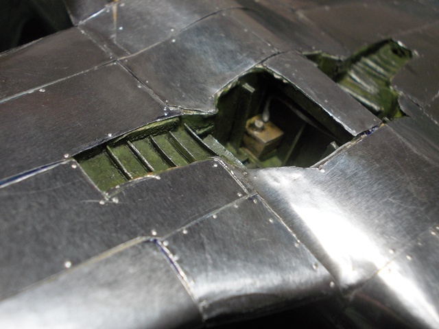

I left off yesterday starting to skin the fuselage and wings with sticky back silver paper and here is the end result!...

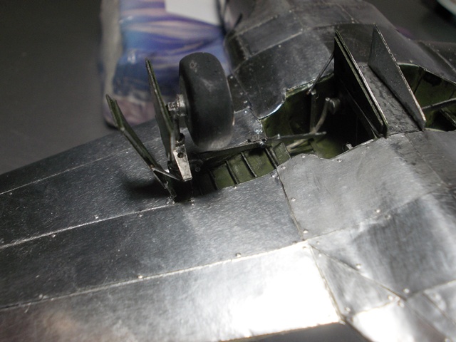

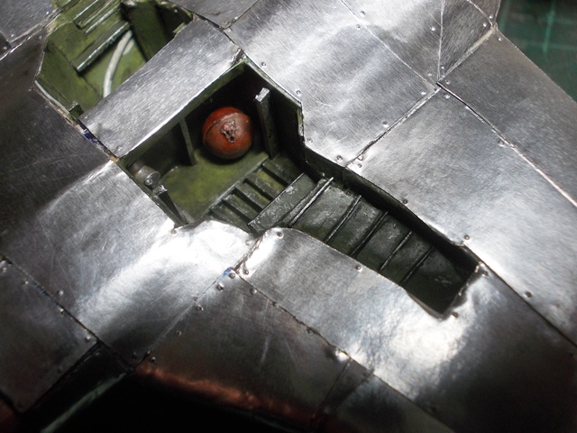

The main undercarriage wheel wells were next...odd bits of plastic was used for this.....
Here are the 6 x 12.7mm machine guns in place in the nose.I drilled out the holes and glued wire insulation that represented the barrels....

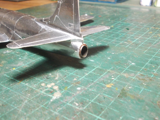

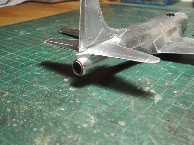

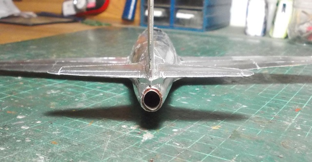

...and the tail pipe was made by a wrapped piece of paper pushed through another hole that I drilled out!....

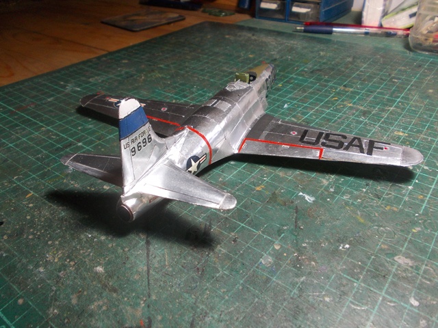

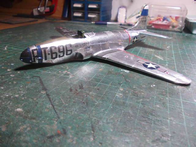

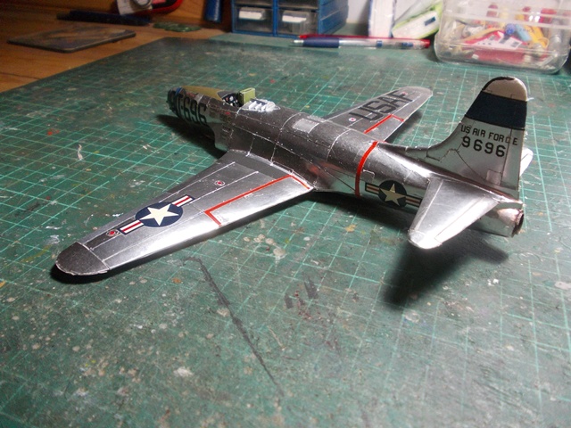

Of course I had to get together my own markings for this F-80C.The national insignia was taken from my stash of kit decals I collected over the years and unfortunately I had to hand paint the rest. The way I do it is hand paint the markings on a piece of baking foil (nice and thin)... and when dry .....simply glue them in place!....actually it wasn't that simple!....this is why I chose this particular F-80.....F9696...as it was easier to replicate the markings!
Here are some of the markings cut out from the foil.....
So the next 6 photos are of all the markings in place......

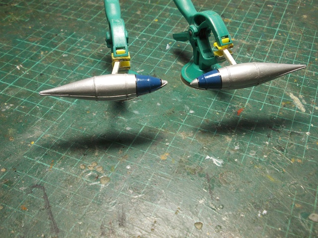

The two tip tanks were made from a couple of old kit bombs that I had to cut and shape up a bit!...

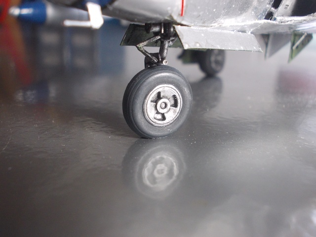

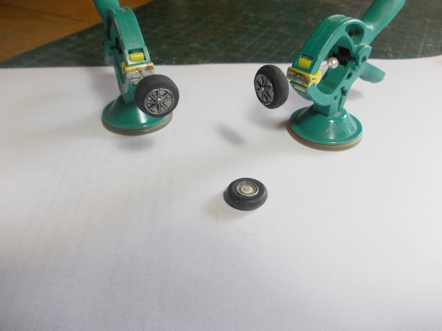

The main wheels made from balsa wood.......

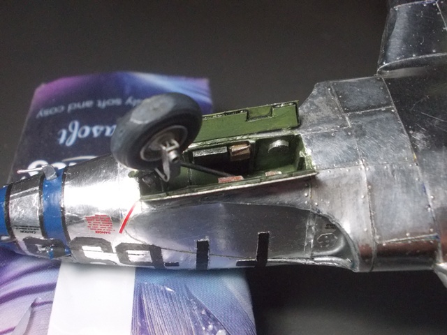

The nose wheel was stolen from an old kit and attached to the scratch built undercarriage leg....

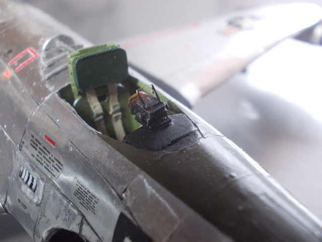

Here is a shot of the reflector gun site...or a bunch of pieces of scrap plastic glued together!!
The last 3 photos are of the undercarriage .....
