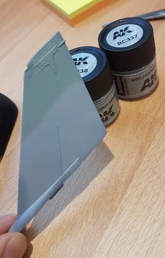

Keroburner89 Posted May 24, 2020 Share Posted May 24, 2020 (edited) For what it's worth, i happened to be testing out some paint when you posted this last night on a spare tail. Its AK interactives range of MiG-29 greys which to me, look spot on based on the reference images I've seen for some really early 9.12s The lighter grey is almost 36375, but perhaps a bit more purplish. The grey green looks spot on to me. This aircraft for reference. If i wanted to be super critical, maybe the paint is a bit darker, but i put that down to the black basing i did as an undercoat + the inside lighting on the shot I took Edited May 24, 2020 by Keroburner89 Quote Link to post Share on other sites
