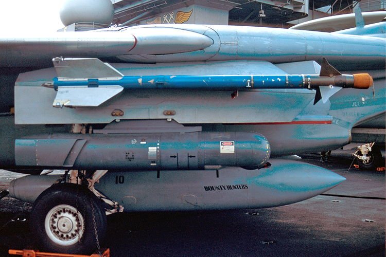

mrvark Posted June 27, 2020 Share Posted June 27, 2020 FWIW, the USAF LANTIRN pod is the AN/AAQ-14; the USN's F-14 pod was the AN/AAS-25. That said, I think they were identical externally. Here's a good side shot showing the inlet. Quote Link to post Share on other sites

Darren Roberts Posted June 28, 2020 Share Posted June 28, 2020 (edited) On 6/27/2020 at 2:58 PM, mrvark said: FWIW, the USAF LANTIRN pod is the AN/AAQ-14; the USN's F-14 pod was the AN/AAS-25. That said, I think they were identical externally. Here's a good side shot showing the inlet. Thanks for the gouge. BTW, what is that blueish color on that Tomcat? Is it photo processing? Edited June 28, 2020 by Darren Roberts Quote Link to post Share on other sites
mrvark Posted June 28, 2020 Share Posted June 28, 2020 39 minutes ago, Darren Roberts said: Thanks for the gouge. BTW, what is that blueish color on that Tomcat? Is it photo processing? I think I captured that pic off the Internet--just image color. Quote Link to post Share on other sites
